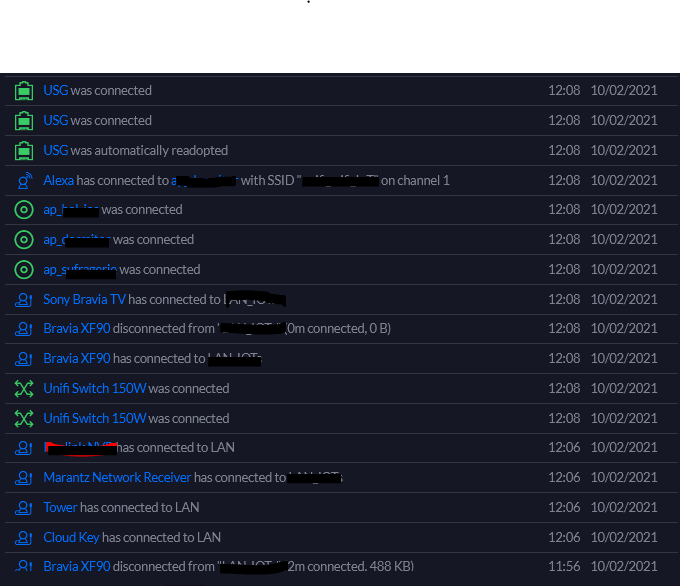

Something else might have happened at that exact hour. I don't think it's a coincidence my devices and clients started disconnecting around the same time the server rebooted.
What's really odd is that if this was indeed a power outage, there was no parity check needed.
