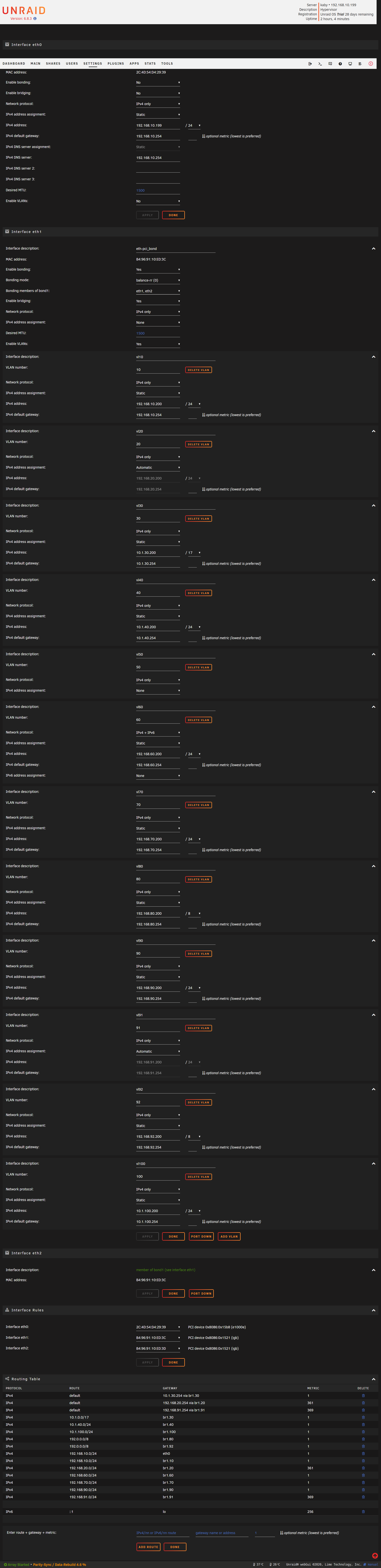

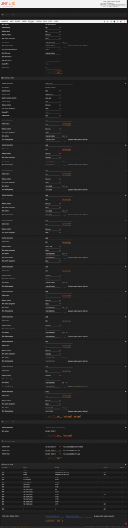

attachement/network-settings

...when the bond stops working, but all ethx interfaces are available I can only think of a mismatched configuration between unraid and switch.
Using static LAG is IMHO not a good idea.
Try dynamic LACP/802.3ad instead.
By looking at your configuration, you do use the same network (192.168.10.0/24) for eth0(no VLAN) and Bond0-VLAN10.
What's the PID on the switch port where eth0 is connected?
Gesendet von meinem SM-G960F mit Tapatalk
Thanks for chiming in!
So I'd prefer LACP too but the (current) switch only supports static LAG.
eth0 port9 pvid10 vl10-UNtagged
eth1 port8 pvid10 vl10-tagged vl20-tagged vl30++
eth2 port7 pvid10 vl10-tagged++
*eth3 port6 pvid10 vl10-tagged++
*eth4 port5 pvid10 vl10-tagged++
LAG
current 7+8 (*coming 5-9 =5gb/s)
cheers, and have a nice fridaynight!
