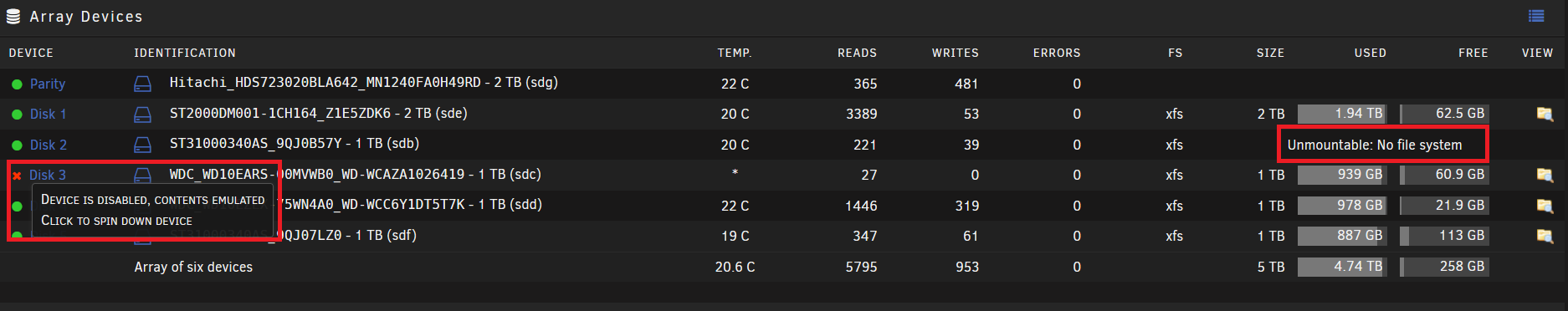

Hello everyone,
Few months ago I started having problems with my server, multiple drives started having read/write problem which caused disk to become Unmountable. I had to repair the filesystem using the -L option and then they would soon re-corrupt themselves, while I tried to fix the root issue one of my drive became disabled. The problem is that I now have 1 drive that's disabled and 1 drive that's Unmountable.
Having only 1 parity drive, I fear this will lead to data loss. I have since received replacement drives and I would like to salvage what's left of my data and get the server running back up again.
What order of things would be proper in this case? repair the Unmountable drive and then replace the offline drive and attempt to repair it?
Here is a log and a screenshot.
Many thanks.

You rebooted before getting those diagnostics so can't see what may have happened before that. Disk3 isn't giving SMART, check connections and post new diagnostics.

Disk3 doesn't even appear in those diagnostics.
Emulated disk3 is mounted though so you should be able to rebuild it and it shouldn't need repair.
Except...
Looks like disk2 and disk5 are beginning to have problems also. How did you get to a point where you had multiple disks with SMART warnings?

Whether you repair disk2 before or after rebuilding disk3 would have no effect on the rebuild. The SMART warnings you are already getting on disks 2 and 5 might be a problem though and nothing you can do about that except replace them one at a time after you get disk3 rebuilt. It is also possible that the SMART warnings you have on disk2 might cause problems repairing disk2. Just take things one at a time and see where we get.

Do you mean none of your shares are working, or just shares that are on disk2?
According to your diagnostics, user shares are mounted as are all disks except disk2, including the emulated disk3.
