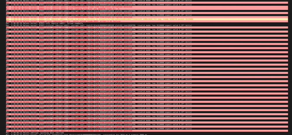

Here is syslog when everything started going downhill:

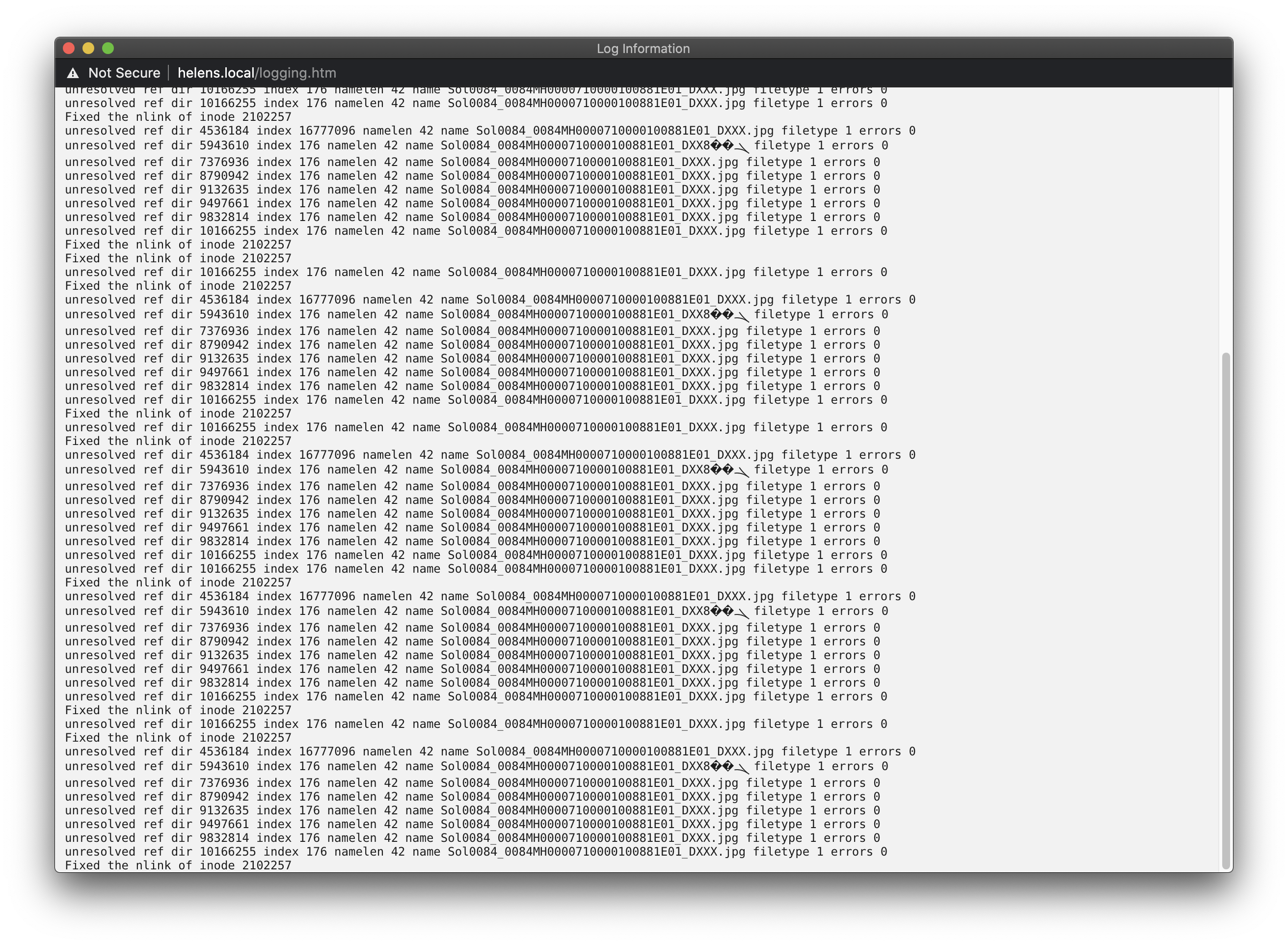

The other screenshot is the log from "btrfs check"
