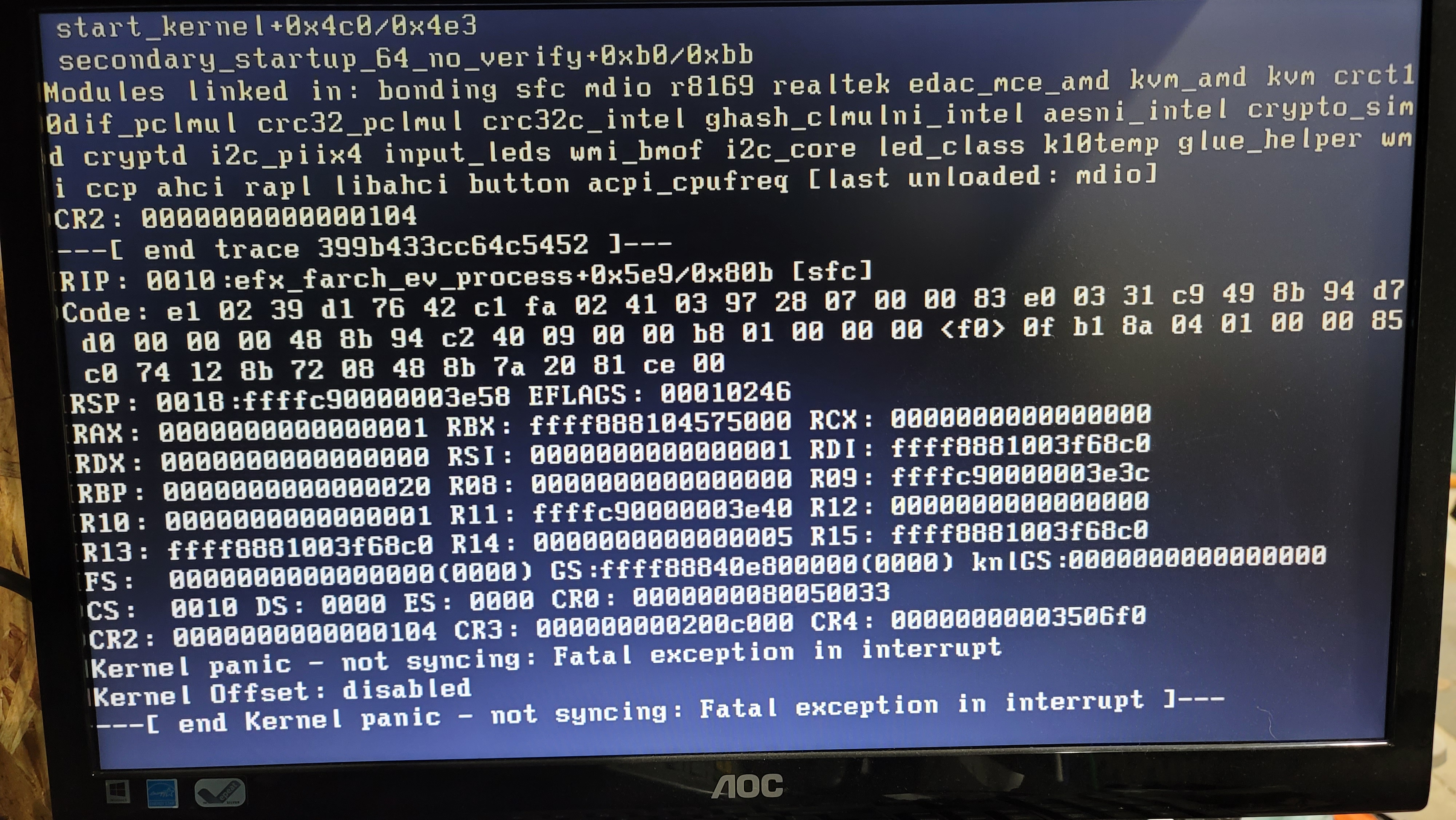

At this point I can't get the system to come up. It stops on "Kernel panic - not syncing: fatal exception in interrupt"

If this safe boot fails please observe when it is occurring during the boot process.  You can also take a picture of the monitor screen.  (Make sure you can actually read the information!)  Tell us what version you updated from.
This where it stops
I see  "kvm" listed in the picture.  From Google, I believe this is part of an attempt to install a virtual machine.
