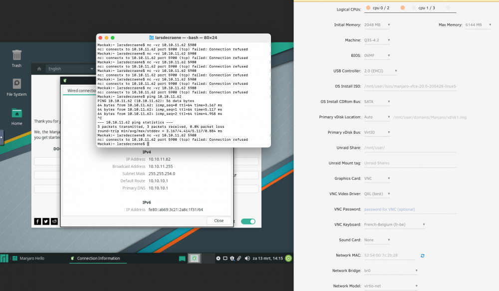

I've set up my Manjaro VM to be bridged straight onto the network. I can now ping it, but the VNC port is not listening. is this due to the VM or due to an Unraid setting? I read that any VM supported VNC straight out of the box?

Hi Jonathan, thanks for your reply.
The VM is using the VNC Graphics card, please see the attached screen.
Yes, that means for VNC you should connect to the IP of Unraid, NOT the VM, as I tried to explain.
that's weird... so what happens if you run multiple VM's using the VNC graphics driver? do they pick another port? where is this documented?
Each VM as it's started picks the next unused port, so the first VM is 5900, the next is 5901, etc, etc.
Look on the VMS tab in the GUI, the graphics column shows the current assignments.
