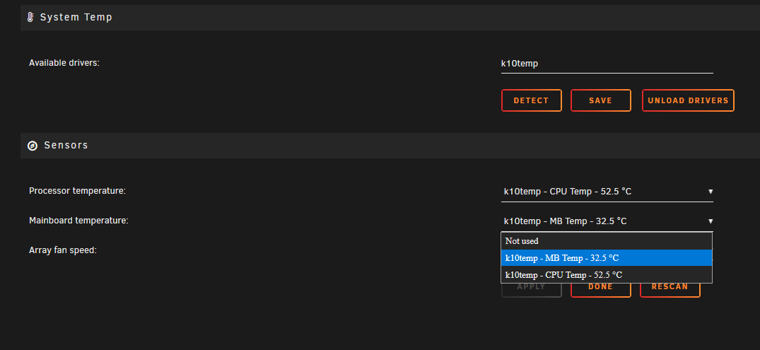

Hi everybody! I have a very noobish question, but can't find a straight answer to anywhere, I have an unRAID machine running on an AMD 1700x cpu, with an aio water cooler and I noticed that whenever I was pushing the CPU (80+% CPU usage), the temperatures would rise up to about a 90°C plateau.
I've found online reports that mentionned that the CPU/Motherboard (an asus crosshair hero 6) has a +20°C offset on the CPU for control purposes, and was wondering if the temperature reported by unRAID (using the Dynamix System Temperature plugin) was the temperature with or without that offset.
I've tried maxing out my fan curves in the motherboard's BIOS and even then, I plateau at roughly 85°C, hence why I'm starting to wonder if it's actually plateau-ing at 65°C, which would make much more sense from that CPU with the amount of cooling it's getting.

When I click on the pulldown I only get CPU and MB temps... could it be because there's an options mismatch?

Actually, it is because you assign Tdie as MB_temp and Tctl as CPU_temp.
They are different in 20c, that's match your founding on internet.
Pls clear the assignment, both temperature are come from CPU.
Pls ref. other post about how to make Unraid got MB_temp by super-io chip.
Edited by Vr2Io
Ahhh thank you so much I didn't know, I thought MB Temp was the motherboard's chipset temperature! Thanks again! :)
