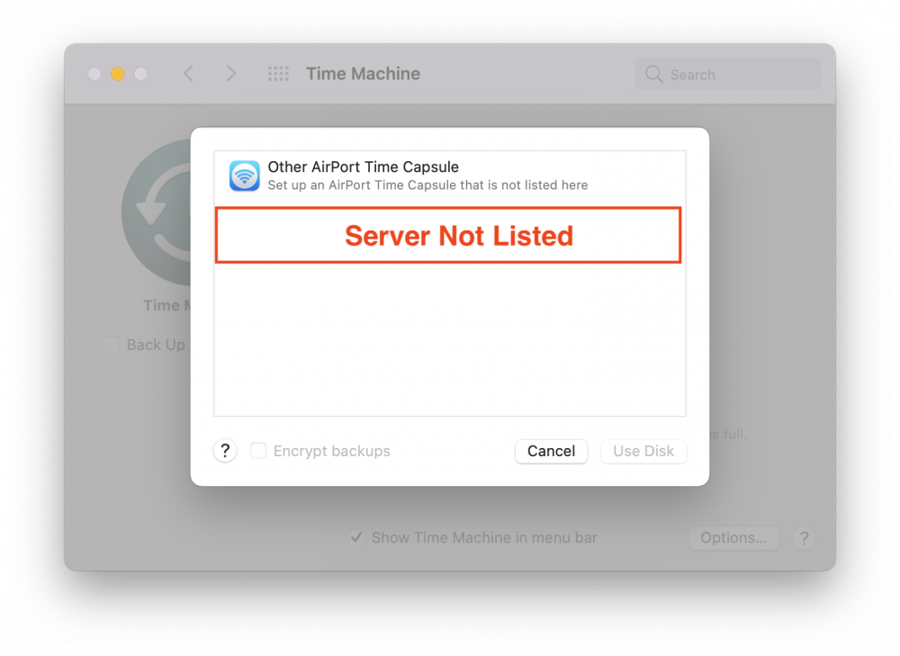

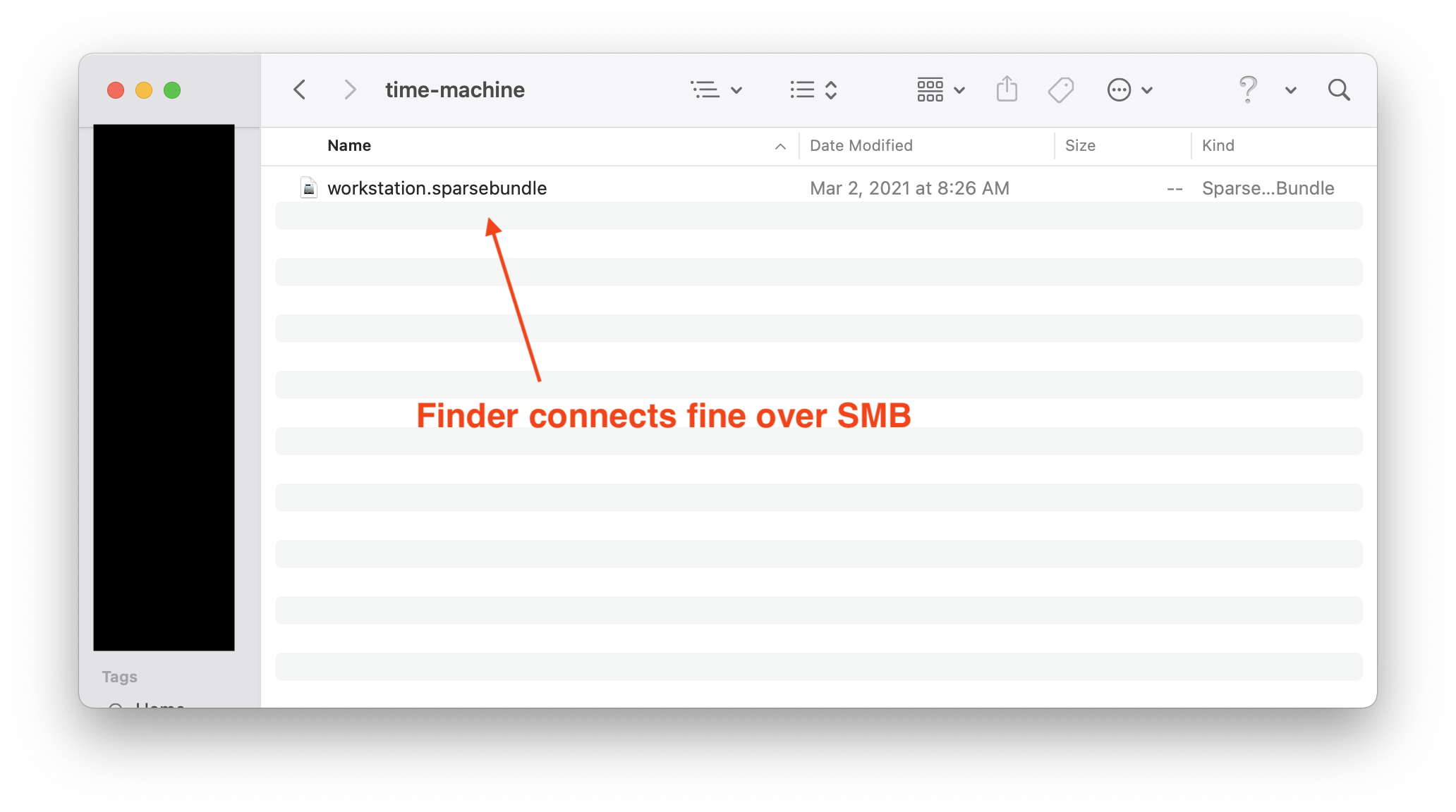

  • Time Machine does not see my SMB share after applying the 6.9 update (see attached)

Hey Mate,
Thought I would let you know that I currently cant get anything Time Machine related working either! Its my first time setting it up though, so until I found your post I thought it was my mistake.
I could swear that the built-in Time Machine share was still working in 6.9 RC2 or one of the beta releases. Although the Space Invader tutorial did not work for me on that version either.
At the time I put the blame on Big Sur and Time Machine beeing weired and the tutorial beeing out-dated, but after the stable update I could not even get the built-in method working anymore.
So you are not alone on this issue 😅

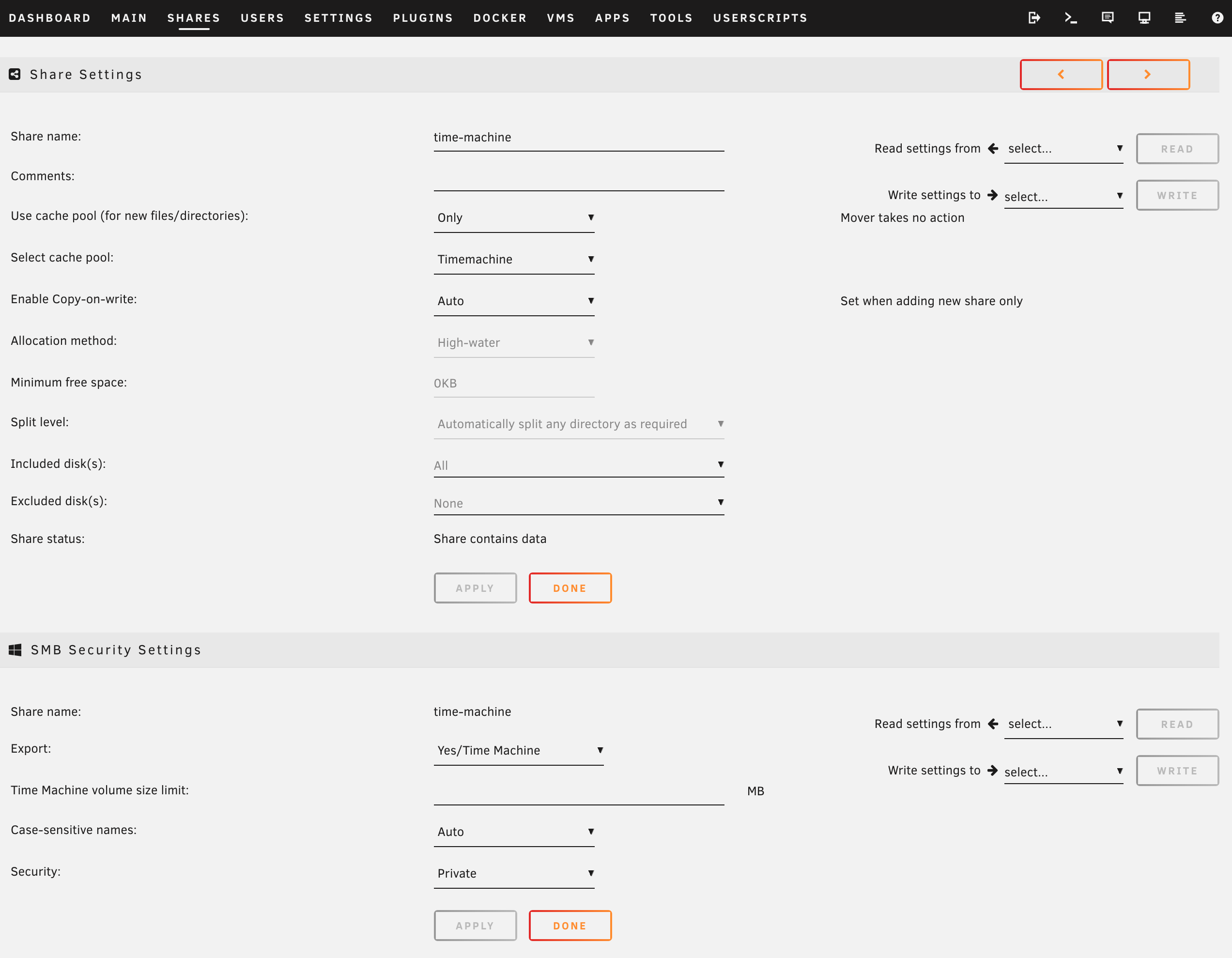

I was able to solve this by removing the modifications from @SpaceInvaderOne and configure the share as a "Time Machine" share like pictured below.
I have an SSD that I was using for Time Machine only. What I did was create a dedicated cache pool, but this might be a little overkill for your needs.
Creating a standard share and setting the export to "Yes/Time Machine" is working for me now.
Make sure you load the share up in finder before attempting to add the Time Machine disk in System Preferences (on your mac).
