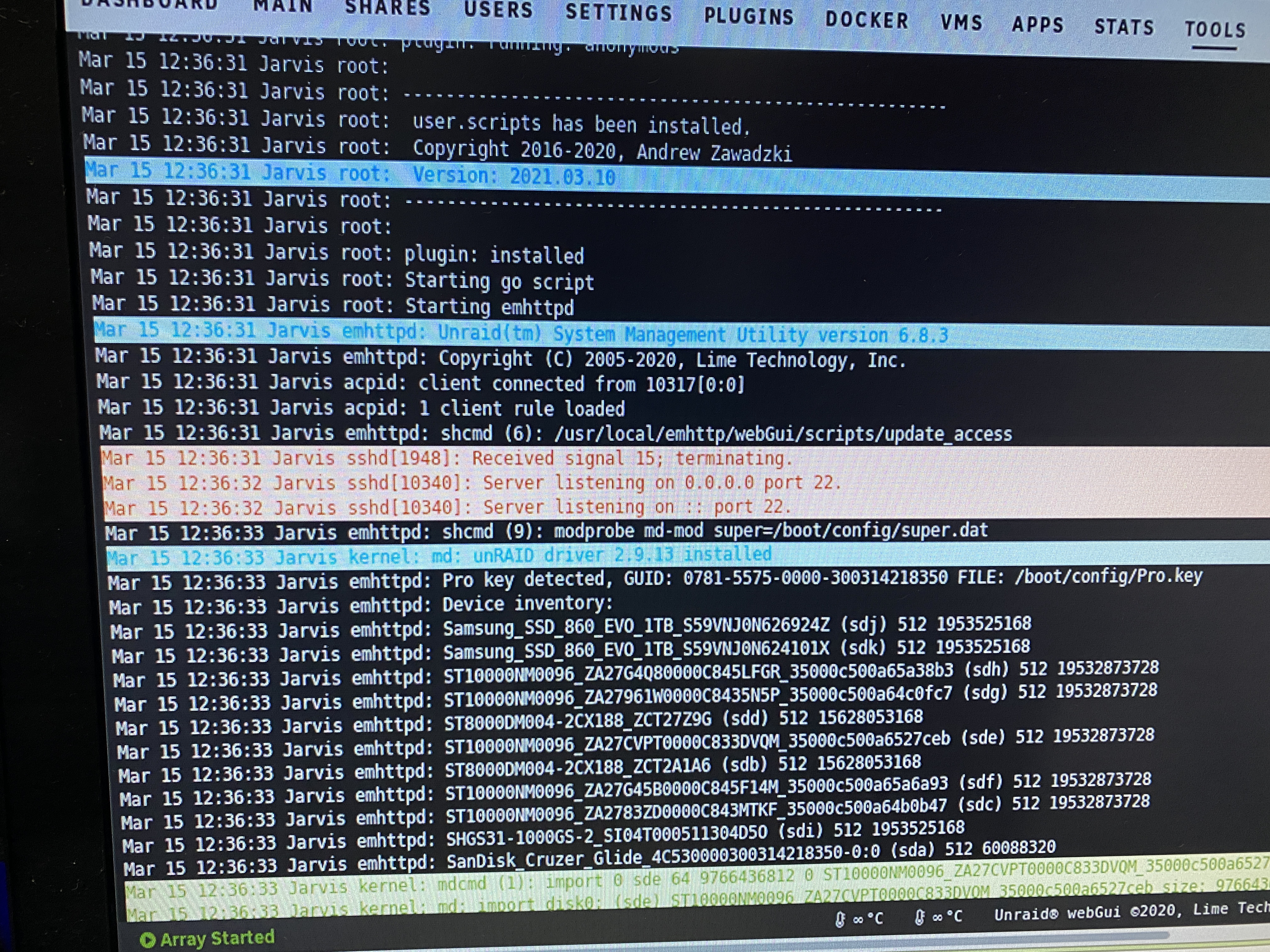

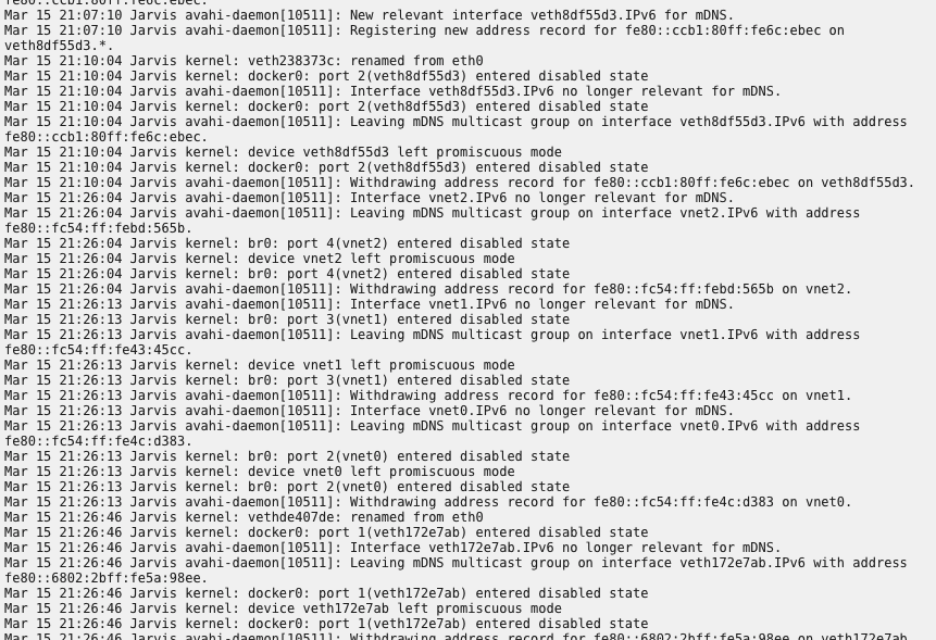

I am in desperate need of help. The permissions on my folders keep changing so I cant access them. My log is filled with the network activity below. The more I read about the activity I am seeing the more sure I am someone is sniffing my NIC. Any solutions to stop this? I need this server for work. all dockers have been off and i do have a windows VM that backups up online.
Unraid version: 6.8.3
Not much to go on with the screen shots. NIC's going into promiscuous is normal behavior with docker/vms. Do you have any dockers running, scripts, VM's or machines that are connected to your shares? Maybe get a diagnostics log uploaded?
