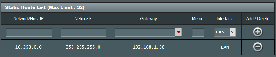

  • Add a static route in your router from the WireGuard Local tunnel network pool to the IP of your Unraid server (the default pool for WireGuard on Unraid is 10.253.0.0/24) For me the router settings look like this:
