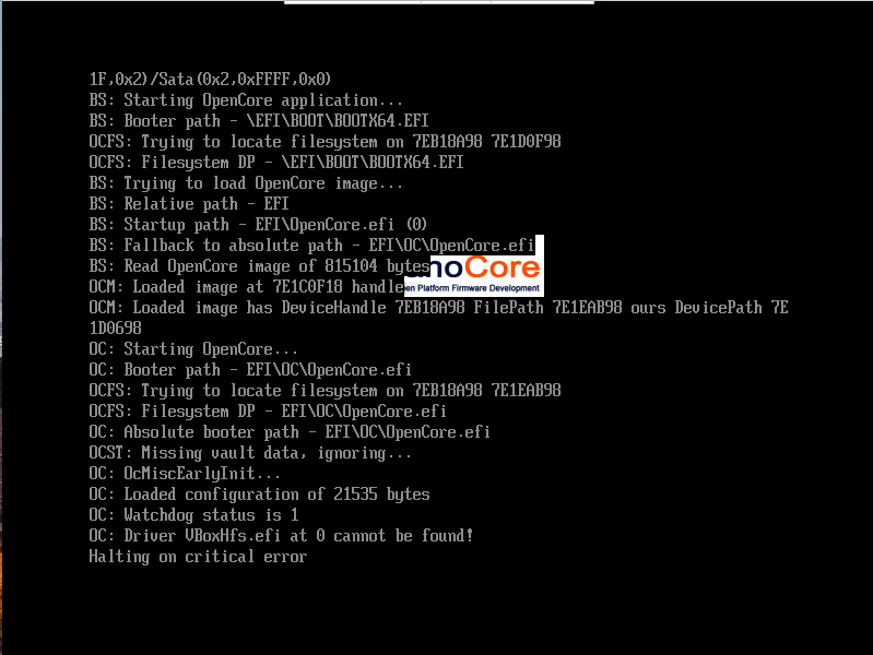

on step 8 I get this:
Did you setup the bootloader according to your needs?Or you just copied/pasted?
The error refers to missing Hfs driver, VBoxHfs.efi.
You are missing that file in EFI/OC/Drivers
Edited by ghost82
I replaced the files as per your instructions
ok it seems you used an older version of opencore?
Open your config.plist and replace VboxHfs.efi with OpenHfsPlus.efi
Make sue you have the file OpenHfsPlus.efi in /EFI/OC/Drivers
You need to check what changed in the config.plist from your older version to the new one, several keys were added and removed.
