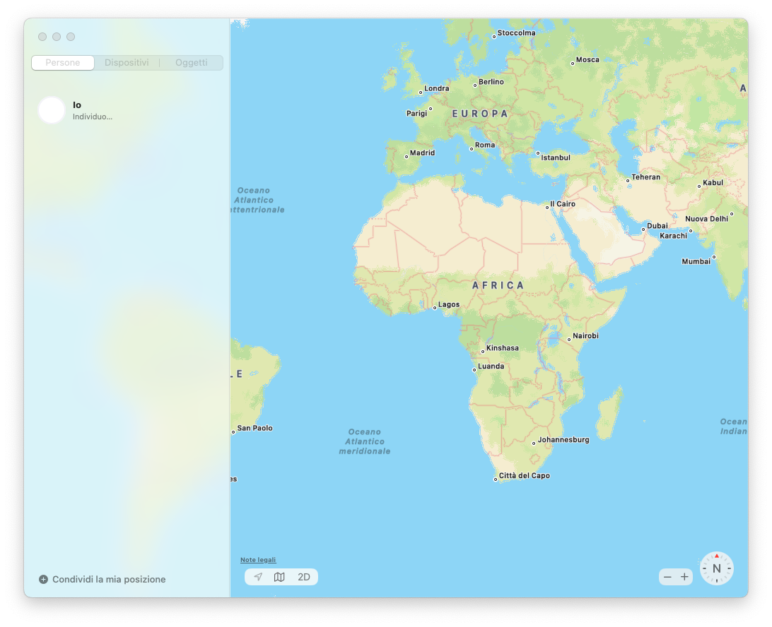

  2. As far as findmy and the black screen I'm quite sure it depends on gpu rendering. On my vm everything is fine (I'm on Monterey and cannot upgrade because of my cpus), I'm passing through a 6900xt gpu and enabled unfairgva in opencore because also TV app showed a black screen. Now everything is fine.

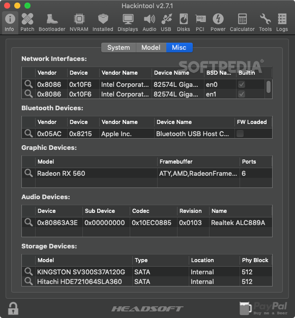

  3. As far as the location map: my though is that the black screen could be because of gpu rendering requirement: are you connecting via vnc?This could explain the black screen. As far as the not able to get location, I know location can be found only with wifi protocol, not with ethernet. No wifi, no location, and maybe external wifi (a usb wifi dongle for example) wont work at all to get the location because of how it works in mac os in general, but only a proper wifi pcie module passed to the vm from the host. As far as imessage I have no idea, I don't use it at all, can you check both devices are connected to apple account?To be sure, logout, login again and retest. And also does your en0 connection is seen as built-in?Check in ioreg explorer or with hackintool See following image, both en0 and en1 builtin:
  4. Mac address change is not a must, but recommended. En0 must be built-in. Your issue was that from the apple side you login multiple times (too many) to your account with different devices. In real, you changed only the configuration of the vm, but each change resulted in a new device seen from the apple side, so they locked the account. Glad that you solved the issue.
