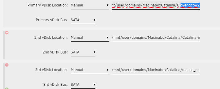

  2. Tried both. Still the Same Problem. Is there a way that i provide you more Information? What is the best way to Mount the EFI Partition to copy the opencore Stuff? I do not know if it is allowed but for me it would be also fine if i Pay you and you connect over Teamviewer or AnyDesk to my PC to try it out by yourself? The Mac VM is fresh so you can delete it and recreate it.
  3. <qemu:arg value='Penryn,vmx,rdtscp,kvm=on,vendor=GenuineIntel,+invtsc,vmware-cpuid-freq=on,+pcid,+ssse3,+sse4.2,+popcnt,+avx,+aes,+xsave,+xsaveopt,check'/> --> --> Normal Boot <qemu:arg value='host,+hypervisor,migratable=no,-erms,+invtsc,kvm=on,+topoext,+invtsc,+avx,+aes,+xsave,+xsaveopt,+ssse3,+sse4_2,+popcnt,+arat,+pclmuldq,+pdpe1gb,+rdtscp,+vme,+umip,check'/> --> --> Black Screen i can provide any Logs you need. I will try out to flash opencore.
  4. If you want to test my Configuration you can download Macinabox from the Unraid App Store and then Setup a Default Catalina Image. This is what i did. 10.15.4 Catalina Yes i tried the CPU Spoof.
  5. I think i am to dumb to install the opencore Version. Maybe we are able to find out why the Blackscreen is happening after the Clover Boot Screen. I tried Clover stuff like verbose mode but it does not change. The wried thing is the the first CPU Core is at 100% when the Blackscreen is Visible. Maybe we could find a log Clover log.
  6. Thank you for the Quick Reply. Yes i saw that you are using opencore now. Do you have a Guide how to setup opencore? Where can i find the Clover logs?
  7. xml2.xml I tried your quem CPU Settings. But the Problem is, that when i boot the Mac then i can see the Clover boot Screen and after some Seconds when it should start to boot up the Screen is Black and nothing happens anymore. I used Macinabox Catalina to create the Mac at all. I connect while testing over noVNC to the VM. If i add Verbose mode the Same thing happen. -boot strict=on \ -device pcie-root-port,port=0x10,chassis=1,id=pci.1,bus=pcie.0,multifunction=on,addr=0x2 \ -device pcie-root-port,port=0x11,chassis=2,id=pci.2,bus=pcie.0,addr=0x2.0x1 \ -device pcie-root-port,port=0x12,chassis=3,id=pci.3,bus=pcie.0,addr=0x2.0x2 \ -device pcie-root-port,port=0x13,chassis=4,id=pci.4,bus=pcie.0,addr=0x2.0x3 \ -device ich9-usb-ehci1,id=usb,bus=pcie.0,addr=0x7.0x7 \ -device ich9-usb-uhci1,masterbus=usb.0,firstport=0,bus=pcie.0,multifunction=on,addr=0x7 \ -device ich9-usb-uhci2,masterbus=usb.0,firstport=2,bus=pcie.0,addr=0x7.0x1 \ -device ich9-usb-uhci3,masterbus=usb.0,firstport=4,bus=pcie.0,addr=0x7.0x2 \ -device virtio-serial-pci,id=virtio-serial0,bus=pci.2,addr=0x0 \ -blockdev '{"driver":"file","filename":"/mnt/user/domains/MacinaboxCatalina/Clover.qcow2","node-name":"libvirt-3-storage","cache":{"direct":false,"no-flush":false},"auto-read-only":true,"discard":"unmap"}' \ -blockdev '{"node-name":"libvirt-3-format","read-only":false,"cache":{"direct":false,"no-flush":false},"driver":"qcow2","file":"libvirt-3-storage","backing":null}' \ -device ide-hd,bus=ide.2,drive=libvirt-3-format,id=sata0-0-2,bootindex=1,write-cache=on \ -blockdev '{"driver":"file","filename":"/mnt/user/domains/MacinaboxCatalina/Catalina-install.img","node-name":"libvirt-2-storage","cache":{"direct":false,"no-flush":false},"auto-read-only":true,"discard":"unmap"}' \ -blockdev '{"node-name":"libvirt-2-format","read-only":false,"cache":{"direct":false,"no-flush":false},"driver":"raw","file":"libvirt-2-storage"}' \ -device ide-hd,bus=ide.3,drive=libvirt-2-format,id=sata0-0-3,write-cache=on \ -blockdev '{"driver":"file","filename":"/mnt/user/domains/MacinaboxCatalina/macos_disk.img","node-name":"libvirt-1-storage","cache":{"direct":false,"no-flush":false},"auto-read-only":true,"discard":"unmap"}' \ -blockdev '{"node-name":"libvirt-1-format","read-only":false,"cache":{"direct":false,"no-flush":false},"driver":"raw","file":"libvirt-1-storage"}' \ -device ide-hd,bus=ide.4,drive=libvirt-1-format,id=sata0-0-4,write-cache=on \ -netdev tap,fd=35,id=hostnet0 \ -device vmxnet3,netdev=hostnet0,id=net0,mac=52:54:00:54:3a:24,bus=pci.1,addr=0x0 \ -chardev pty,id=charserial0 \ -device isa-serial,chardev=charserial0,id=serial0 \ -chardev socket,id=charchannel0,fd=36,server,nowait \ -device virtserialport,bus=virtio-serial0.0,nr=1,chardev=charchannel0,id=channel0,name=org.qemu.guest_agent.0 \ -device usb-tablet,id=input0,bus=usb.0,port=1 \ -vnc 0.0.0.0:0,websocket=5700 \ -k en-us \ -device qxl-vga,id=video0,ram_size=67108864,vram_size=67108864,vram64_size_mb=0,vgamem_mb=16,max_outputs=1,bus=pcie.0,addr=0x1 \ -device virtio-balloon-pci,id=balloon0,bus=pci.3,addr=0x0 \ -usb \ -device usb-kbd,bus=usb-bus.0 \ -device '************************' \ -smbios type=2 \ -cpu host,+hypervisor,migratable=no,-erms,+invtsc,kvm=on,+topoext,+invtsc,+avx,+aes,+xsave,+xsaveopt,+ssse3,+sse4_2,+popcnt,+arat,+pclmuldq,+pdpe1gb,+rdtscp,+vme,+umip,check \ -sandbox on,obsolete=deny,elevateprivileges=deny,spawn=deny,resourcecontrol=deny \ -msg timestamp=on 2020-04-26 10:38:34.865+0000: Domain id=51 is tainted: high-privileges 2020-04-26 10:38:34.865+0000: Domain id=51 is tainted: custom-argv 2020-04-26 10:38:34.865+0000: Domain id=51 is tainted: host-cpu char device redirected to /dev/pts/2 (label charserial0)

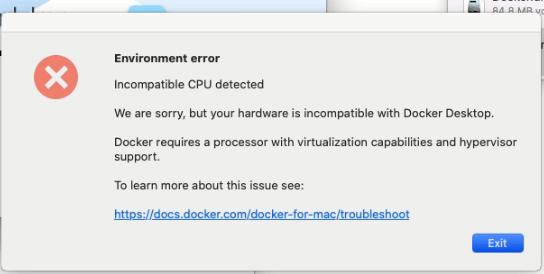

  12. Does someone was able to get Docker working?

  15. @tjb_altf4 thank you for the quick reply. 1. Shutdown all VMs 2. Open the Unraid Terminal modprobe -r kvm_intel modprobe kvm_intel nested=1 3. Open VM Settings -> Toggle XML View Add <feature policy='require' name='vmx'/> to the CPU Section 4. Start the VM
  16. Hi, i want to ask if it is possible to enable VT-d Support inside a VM. I try to use docker inside a VM. Is this in general Possible? I get an error. Screenshot Attached. Best, Daniel
