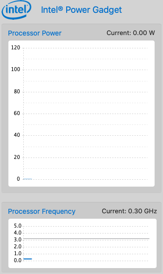

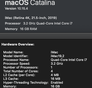

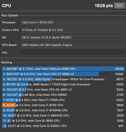

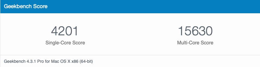

Thankyou that seems to have fixed the topology and interestingly identifies as a QuadCore i7-8700 which obviously doesn't exist. Intel power Gadget showed low Processor Freq which was mainly why I didn't use the Penryn Family flag as to not try and reduce performance but as you can see the benchmark is quite respectable for running 8/12 threads overall. Not overly important I don't think? but I am not able to boot with a rom loaded for my GPU is this necessary anymore but when I define the rom file in XML I can't even show the Post Screen for UEFI so ill keep looking into that. Has anyone noticed any significant differences by loading the ROM?

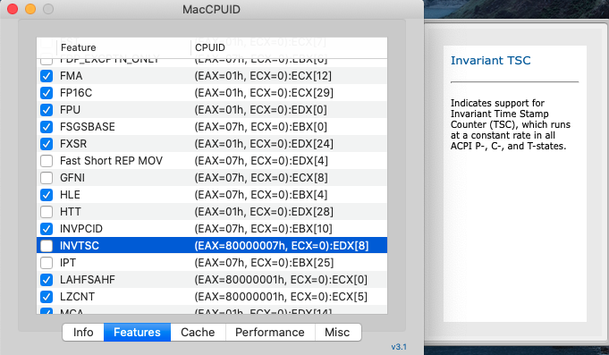

Thanks for figuring that one out! Still only showing 3,199,999Hz Does yours show the correct Frequency for your CPU? My QEMU arg now is -cpu host,migratable=no,+invtsc,kvm=on,+hypervisor with host-passthrough as the only cpu value up the top of my XML
** Hackintosh ** Tips to make a bare metal MacOS
Update INVTSC is not showing up detected by the OS even tho its in my XML.... this is perhaps the problem or one of them
Hopefully it’s clear enough to read 6 cores and that patch result in black screen 4 cores (both 2 threads) results in the kernel panic as shown Both Still only displaying 3.199GHz Interesting aswell Unraid shows 100% on core 0 only when it is sitting on the black screen. Sent from my iPhone using Tapatalk
