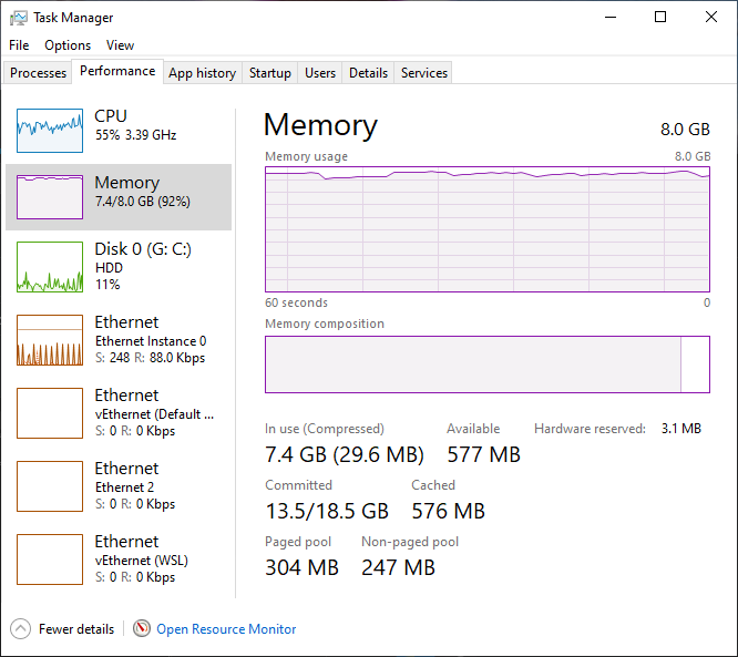

May 31, 20224 yr A quick followup on this... I noticed that the VM is not just more loaded, but was noticeably more "sluggish" and slow generally. I tried and failed to convert the VM to SeaBIOS, to test comparable performance, and while attempting this I noticed this error would appear each time I tried to update the GUI while the vmx CPU flag was in place (Removing the flag avoids the error): So eventually, I made a backup and removed the vmx CPU flag, expecting my VM to die or brick or something strange. Nothing happened, Hyper-V works within the VM, Docker works, WSL2 works, and it "seems" to be a little snappier. I'm not entirely sure what is happening here (It could be more related to updates in 6.10.x), but I thought I would post it just so other know, the "vmx" CPU flag might not be required after all. ¯\_(ツ)_/¯
