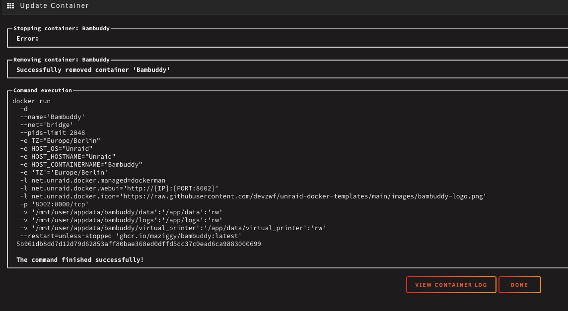

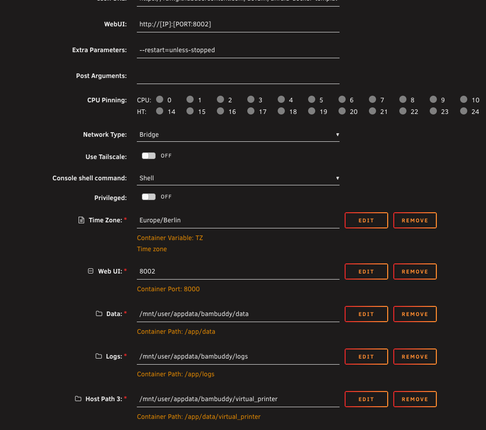

  1. Hey, thanks for the template. I get this, after first installing this: 2026-01-22 16:22:35,614 INFO [root] Logging to file: /app/logs/bambuddy.log 2026-01-22 16:22:35,615 INFO [root] Bambuddy starting - debug=False, log_level=INFO INFO: Started server process [7] INFO: Waiting for application startup. 2026-01-22 16:22:37,908 INFO [backend.app.services.mqtt_relay] MQTT relay disabled 2026-01-22 16:22:37,917 INFO [backend.app.services.smart_plug_manager] Smart plug scheduler started 2026-01-22 16:22:37,921 INFO [backend.app.services.print_scheduler] Print scheduler started 2026-01-22 16:22:37,929 INFO [backend.app.services.notification_service] Notification digest scheduler started 2026-01-22 16:22:37,930 INFO [backend.app.main] AMS history recording started 2026-01-22 16:22:37,930 INFO [backend.app.main] Printer runtime tracking started INFO: Application startup complete. ERROR: [Errno 98] error while attempting to bind on address ('0.0.0.0', 8000): [errno 98] address already in use INFO: Waiting for application shutdown. 2026-01-22 16:22:38,021 INFO [backend.app.services.print_scheduler] Print scheduler stopped 2026-01-22 16:22:38,021 INFO [backend.app.services.smart_plug_manager] Smart plug scheduler stopped 2026-01-22 16:22:38,021 INFO [backend.app.services.notification_service] Notification digest scheduler stopped 2026-01-22 16:22:38,021 INFO [backend.app.main] AMS history recording stopped 2026-01-22 16:22:38,022 INFO [backend.app.main] Printer runtime tracking stopped INFO: Application shutdown complete. 2026-01-22 16:22:38,023 ERROR [sqlalchemy.pool.impl.AsyncAdaptedQueuePool] Exception terminating connection <AdaptedConnection <aiosqlite.core.Connection object at 0x15193843a780>> Traceback (most recent call last): File "/usr/local/lib/python3.13/site-packages/uvicorn/server.py", line 164, in startup server = await loop.create_server( ^^^^^^^^^^^^^^^^^^^^^^^^^ ...<5 lines>... ) ^ File "/usr/local/lib/python3.13/asyncio/base_events.py", line 1630, in create_server raise OSError(err.errno, msg) from None OSError: [Errno 98] error while attempting to bind on address ('0.0.0.0', 8000): [errno 98] address already in use During handling of the above exception, another exception occurred: Traceback (most recent call last): File "/usr/local/lib/python3.13/asyncio/runners.py", line 195, in run return runner.run(main) ~~~~~~~~~~^^^^^^ File "/usr/local/lib/python3.13/asyncio/runners.py", line 118, in run return self._loop.run_until_complete(task) ~~~~~~~~~~~~~~~~~~~~~~~~~~~~~^^^^^^ File "/usr/local/lib/python3.13/asyncio/base_events.py", line 712, in run_until_complete self.run_forever() ~~~~~~~~~~~~~~~~^^ File "/usr/local/lib/python3.13/asyncio/base_events.py", line 683, in run_forever self._run_once() ~~~~~~~~~~~~~~^^ File "/usr/local/lib/python3.13/asyncio/base_events.py", line 2050, in _run_once handle._run() ~~~~~~~~~~~^^ File "/usr/local/lib/python3.13/asyncio/events.py", line 89, in _run self._context.run(self._callback, *self._args) ~~~~~~~~~~~~~~~~~^^^^^^^^^^^^^^^^^^^^^^^^^^^^^ File "/usr/local/lib/python3.13/site-packages/uvicorn/server.py", line 71, in serve await self._serve(sockets) File "/usr/local/lib/python3.13/site-packages/uvicorn/server.py", line 86, in _serve await self.startup(sockets=sockets) File "/usr/local/lib/python3.13/site-packages/uvicorn/server.py", line 174, in startup sys.exit(1) ~~~~~~~~^^^ SystemExit: 1 During handling of the above exception, another exception occurred: Traceback (most recent call last): File "/usr/local/lib/python3.13/site-packages/sqlalchemy/pool/base.py", line 372, in _close_connection self._dialect.do_terminate(connection) ~~~~~~~~~~~~~~~~~~~~~~~~~~^^^^^^^^^^^^ File "/usr/local/lib/python3.13/site-packages/sqlalchemy/engine/default.py", line 718, in do_terminate self.do_close(dbapi_connection) ~~~~~~~~~~~~~^^^^^^^^^^^^^^^^^^ File "/usr/local/lib/python3.13/site-packages/sqlalchemy/engine/default.py", line 721, in do_close dbapi_connection.close() ~~~~~~~~~~~~~~~~~~~~~~^^ File "/usr/local/lib/python3.13/site-packages/sqlalchemy/dialects/sqlite/aiosqlite.py", line 317, in close self.await_(self._connection.close()) ~~~~~~~~~~~^^^^^^^^^^^^^^^^^^^^^^^^^^ File "/usr/local/lib/python3.13/site-packages/sqlalchemy/util/_concurrency_py3k.py", line 132, in await_only return current.parent.switch(awaitable) # type: ignore[no-any-return,attr-defined] # noqa: E501 ~~~~~~~~~~~~~~~~~~~~~^^^^^^^^^^^ File "/usr/local/lib/python3.13/site-packages/sqlalchemy/util/_concurrency_py3k.py", line 196, in greenlet_spawn value = await result ^^^^^^^^^^^^ File "/usr/local/lib/python3.13/site-packages/aiosqlite/core.py", line 206, in close await self._execute(self._conn.close) File "/usr/local/lib/python3.13/site-packages/aiosqlite/core.py", line 160, in _execute return await future ^^^^^^^^^^^^ asyncio.exceptions.CancelledError 2026-01-22 16:22:38,033 ERROR [backend.app.services.notification_service] Error in digest scheduler: (sqlite3.OperationalError) no active connection (Background on this error at: https://sqlalche.me/e/20/e3q8)This is, because your template is set up to use the host network, and not the bridge one. The UI Port should be marked as required as well. This is, what is working for me: Additionally it seems like, it takes for ever to restart the container. It always reports an Error on shutdown for some reason.
