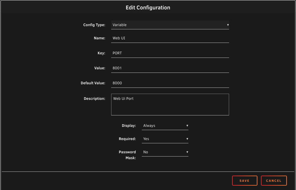

Hi, this application seems great, but there is one problem: it does not take port allocation into account in the settings.
Actually, I set port 8001 (port 8000 is already in use):
Except that when I click on the app icon to open the webui, it opens port 8000. If I type in port 8001, nothing responds, and in the logs I have:

i have made a change to the template and push it to git....
change the port in unraid as follow and it should be all good :

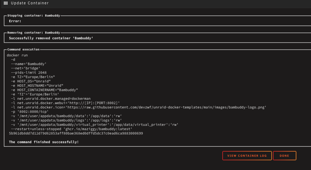

Hey, thanks for the template. I get this, after first installing this:

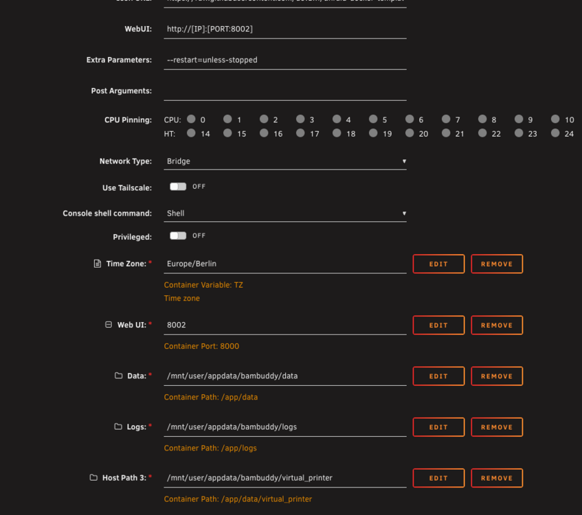

This is, because your template is set up to use the host network, and not the bridge one. The UI Port should be marked as required as well.
This is, what is working for me:

Your issue is because you already run something on port 8000
INFO: Application startup complete. ERROR: [Errno 98] error while attempting to bind on address ('0.0.0.0', 8000): [errno 98] address already in use INFO: Waiting for application shutdown.

The reason the container is set to host is not the template but the app itself seems recommend it.
https://wiki.bambuddy.cool/getting-started/docker/?h=host#network-mode-host
Hi, okay, it works. Well, if I click on webui, it still goes to port 8000, but at least if I manually go to port 8001, it works. Thank you!

Due the the fact this container run in host mode if you change the value here you must change it in the field WEBUI as well
this is in the description of the WebUI variable.
you must change the http://[IP]:[PORT:8000]. to http://[IP]:[PORT:<your_new_port>]

Hey, I was encountering the same problem (webui link not updating probperly). I was looking for the setting you mentioned here but wasnt able to find it easily. Took me some time to toggle to the advanced view and change the port.
I would add to your description, that the advanced view is needed for the change. It may have been due to my limited knowledge in unraid, but it should still be helpful for newcomers to specify that.
Otherwise all is working fine, ty for the container template.
