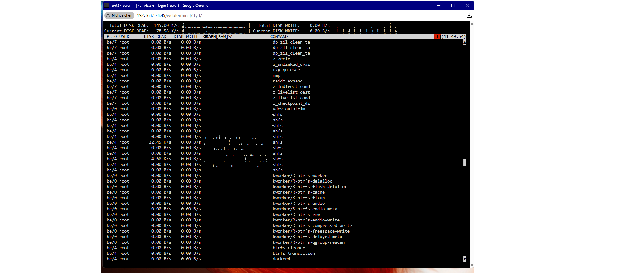

  3. Everyone can see that Trim is working even though it is turned off. Every trim seems to be working even though it's turned off. So the system says it's off, but the GUI says it's on. So I turned it off in the GUI, it's off, but the system now says it's on... it's reversed. And what you see there are all the services on my DIY server that access the hard drives, displayed down to the byte.
  4. Help 7.1.2 Schaut mal ewig lang /stunden lang macht er auf meine HDD das ... es ist ZFS Raid aber Trim ist Ausgeschaltet und auf HDD ja eigentlich nix zu suchen
