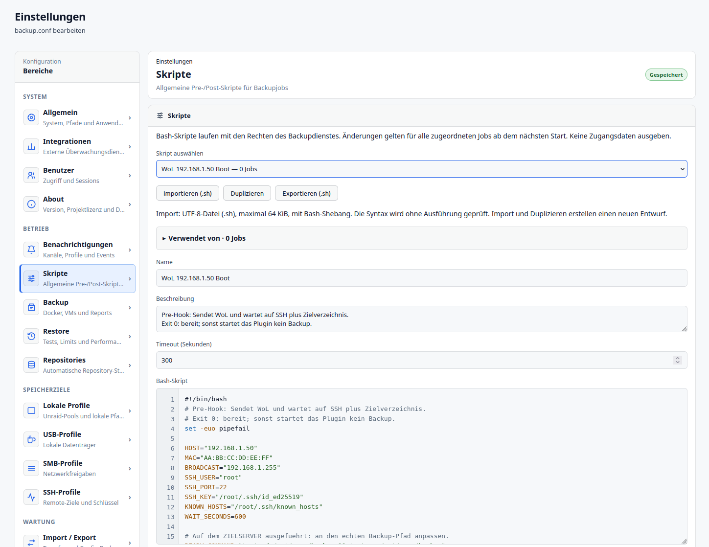

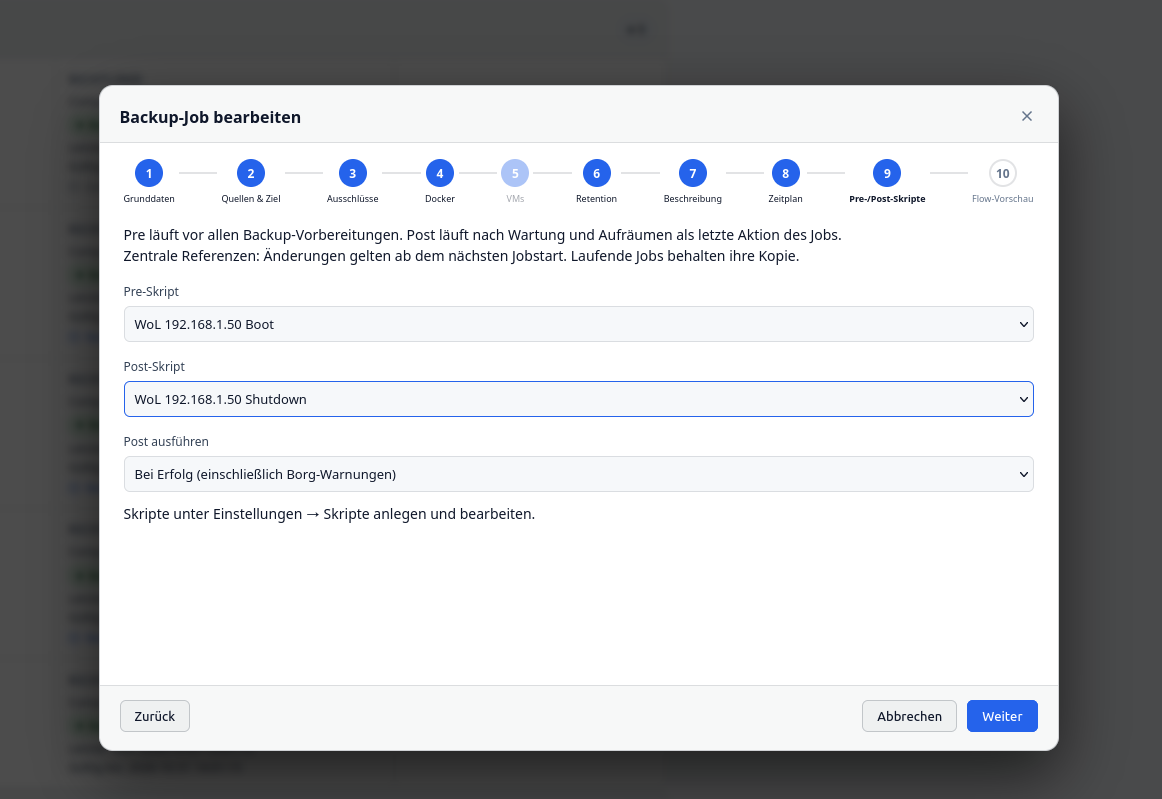

Mit der neuen Version kannst du ein Pre Skript und Post Skript pro Job Konfigurieren und über diese Skripte das WoL einbauen. Das wäre erstmal eine Lösung bis es Nativ unterstützt wird. Unter Einstellungen Skripte. Skripte für WoL anlegen fürs starten und herunterfahren des Zielssystems Skripte je Backup Job einbinden. Vielleicht wäre das eine vorab Lösung.

Borg Backup UI – Version 2026.10.09.1435 This release introduces general Pre/Post scripts, reduces Docker downtime during backups, and improves error reporting. Less downtime for Docker and VMs: Containers and virtual machines restart after archive creation. Retention cleanup, repository compaction (compact), and integrity checks (check) continue afterward. General Pre/Post scripts: Manage reusable Bash scripts under Settings → Scripts and assign them in the job wizard. Pre runs before backup preparation; Post runs after maintenance and cleanup. Post can optionally run after failed, skipped, or cancelled backups. Improved script editor: Bash syntax highlighting, line numbers, syntax validation on save, and navigation to syntax errors. Scripts can also be duplicated, imported, and exported as .sh files. Clear job assignments: A collapsible list shows which jobs use each script. Assigned scripts cannot be deleted. Changes to centrally stored scripts apply from the next job run. Clearer error reporting: Pre and Post have their own phase separators in the log. History and logs identify script failures and their exit codes. A failed Pre explicitly reports that the backup was not started. A Post failure preserves any archive already created. UI improvements: Consistent script settings layout and corrected background colors in History details. Unraid dashboard widget: Updated time labels, clearer distinction between skipped backups and warnings, and improved contrast in light and dark themes. Syntax validation does not execute scripts. Imports also validate the Bash shebang and file format.

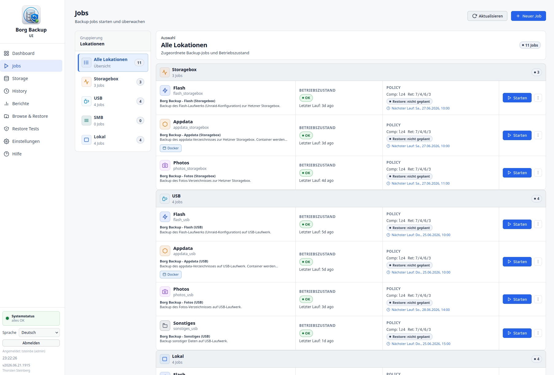

Plugin "Borg Backup UI" fĂĽr Unraid

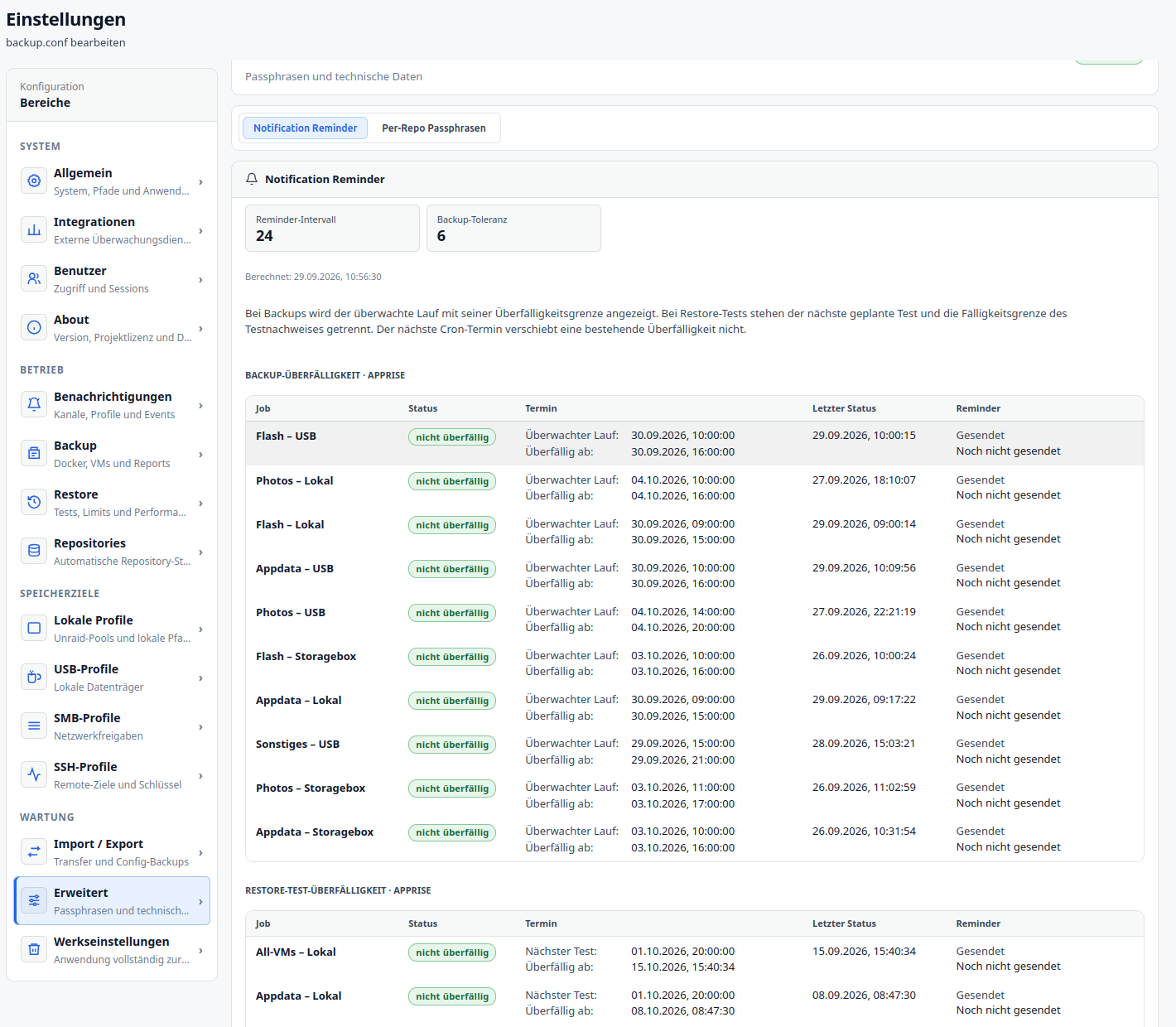

Hallo Dirk, danke für die Bilder! „Überfällig“ bezieht sich auf einen möglicherweise ausgebliebenen vergangenen Lauf. Deshalb kann gleichzeitig schon der nächste Termin angezeigt werden. Die Warnung deutet darauf hin, dass der Lauf am Montag, 28.09., um 03:15 Uhr nicht als erfolgt erkannt wurde. Ob das korrekt ist, muss ich noch prüfen. Auffällig sind außerdem die unterschiedlichen nächsten Termine in Übersicht und Zeitplandialog. Dein Cron-Ausdruck steht für Montag, Mittwoch und Freitag jeweils um 03:15 Uhr. Kannst du mir den Eintrag des letzten Laufs aus der History mit genauer Uhrzeit und Status schicken? Wurde der Zeitplan kürzlich geändert, und sind beide Screenshots unmittelbar nacheinander entstanden? Schau auch mal unter Einstellungen -> Erweitert Hast du eine Notification eingerichtet ? Hier würde man auch den zeitpunkt des lezten laufs sehen und die anderen Zeiten ggf. wann er als Überfällig makiert wird. Es kann durchaus sein das bei bestimmten Zeitplänen dieses akutell nicht passt. Beste Grüße

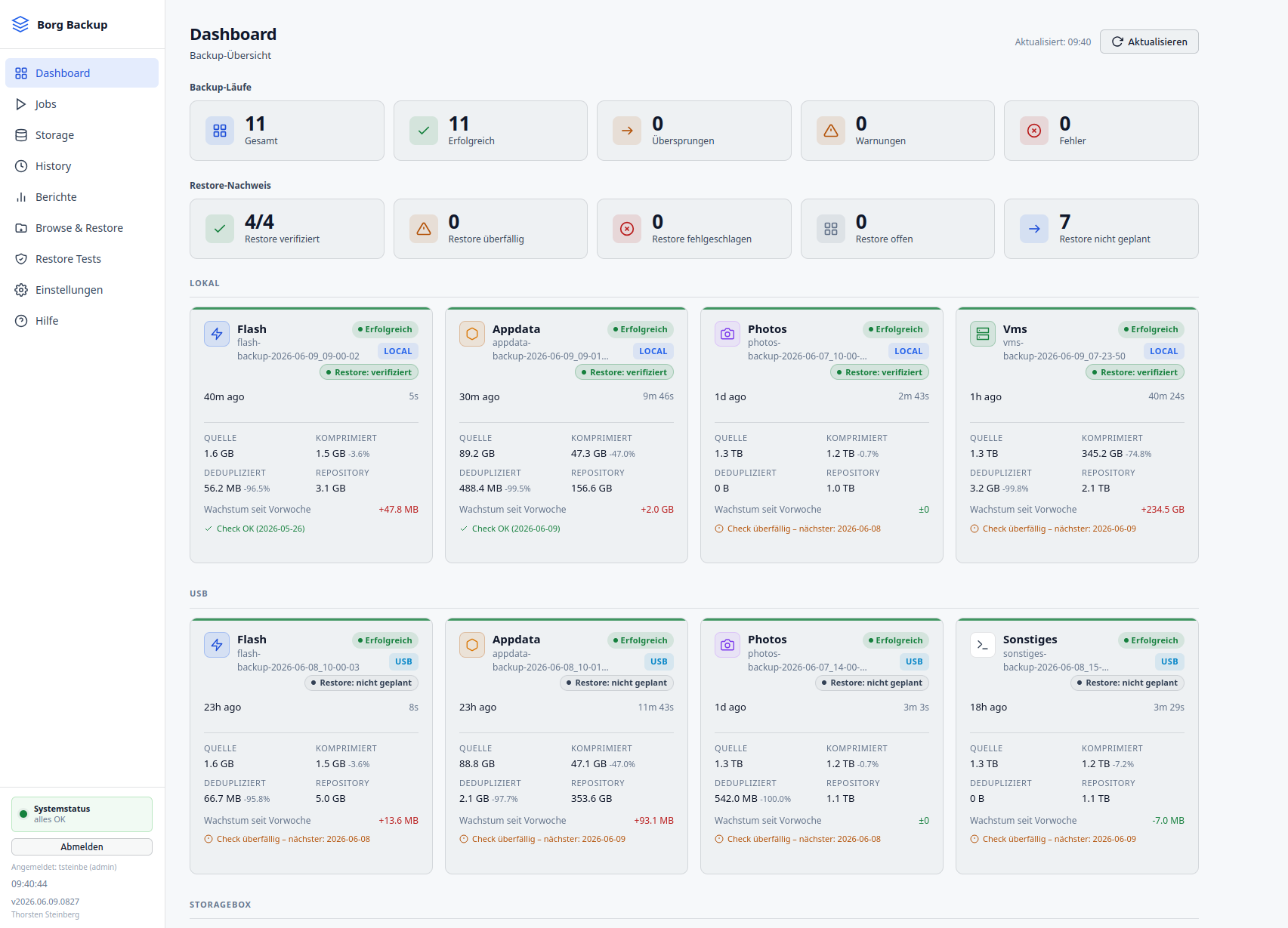

Hallo Dirk, danke für die Rückmeldung und die Screenshots! Das Widget liest einen zwischengespeicherten Status. Dabei können Zeitangaben wie „vor 14 Minuten“ unverändert bleiben, obwohl das Widget regelmäßig nach Daten schaut. Ob bei dir zusätzlich die Statusaktualisierung hängt, muss ich noch prüfen. Die schlechten Kontraste im hellen Theme sind ebenfalls nachvollziehbar. Außerdem zählt das Widget übersprungene Backups momentan als Warnung – daher die unterschiedliche Anzeige zum Dashboard. Ich habe die Punkte in Issue #546 aufgenommen. VG Thorsten

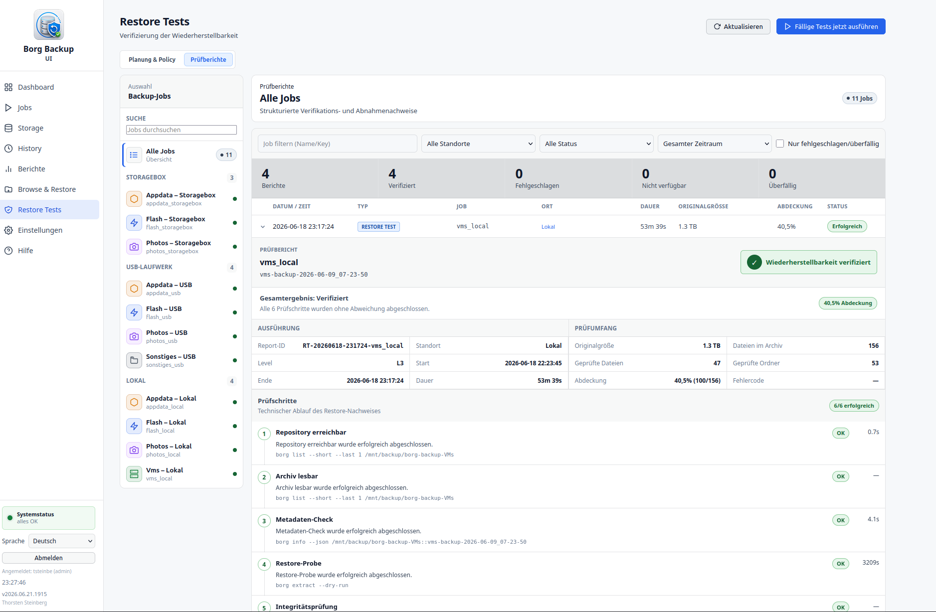

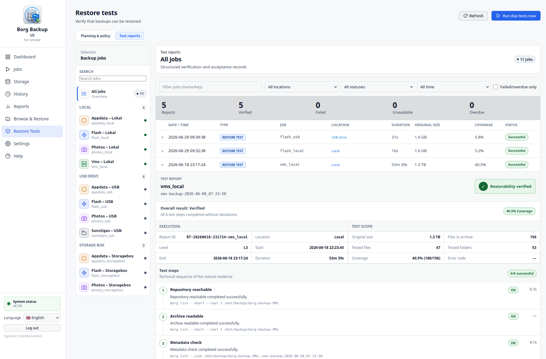

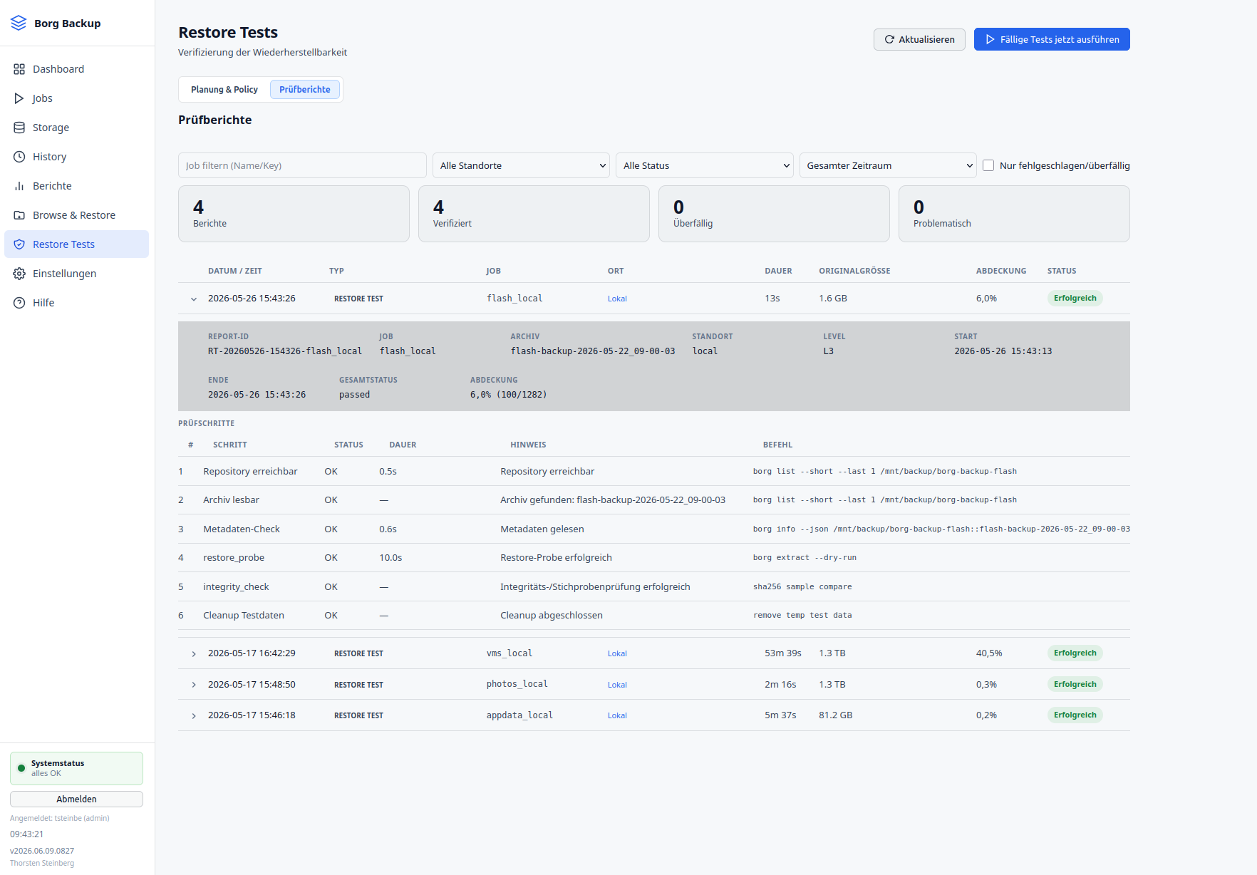

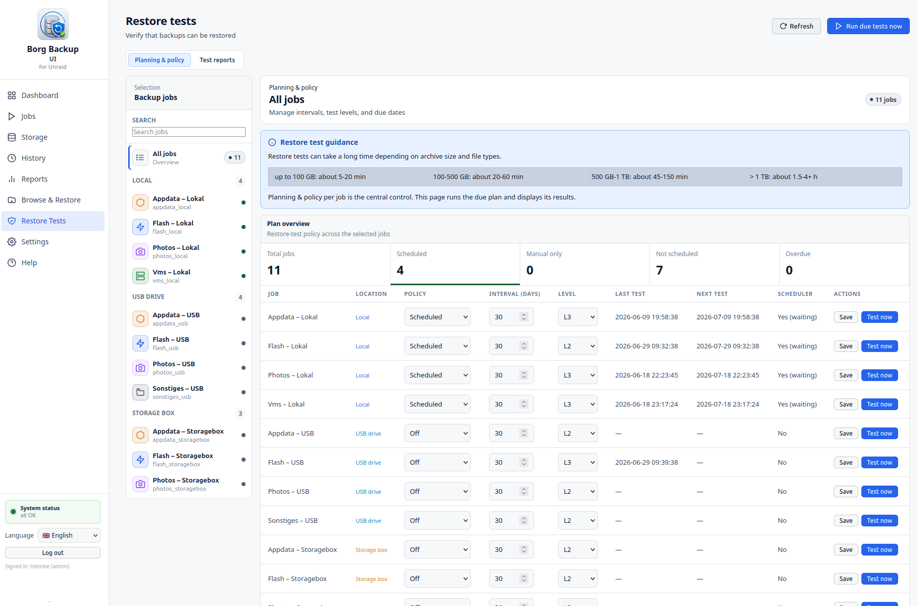

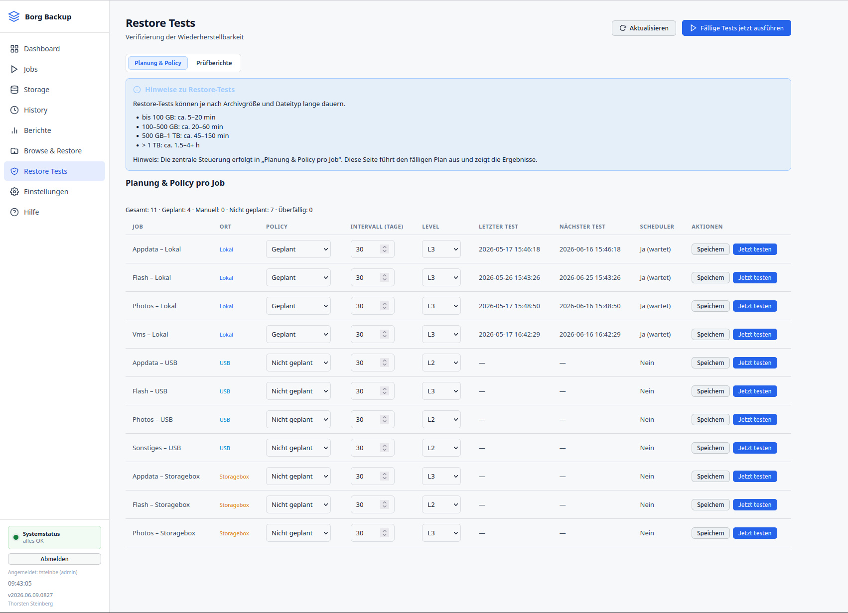

Okay ich habe mal geschau was die Doku von borg-ui sagt. Es gibt drei verschiedene Modi. Modus Was passiert Aufwand Managed Canary Payload Kleine Testdatei wird beim Backup mitgesichert und später extrahiert + geprüft sehr schnell Selected Probe Paths Bestimmte echte Dateien/Ordner werden testweise extrahiert abhängig von Auswahl Full Archive Drill Komplettes Archiv wird extrahiert langsam + hoher Platzbedarf Borg UI legt beim Backup einen kleinen verwalteten Canary-Payload mit ins Archiv. Beim Restore-Test wird dieser aus dem neuesten Archiv extrahiert und anschließend auf Vorhandensein, Größe und Hash geprüft. Das ist richtig, der Test ist dadurch sehr schnell. Meiner Meinung nach sagt er aber nur begrenzt etwas darüber aus, ob die eigentlichen Nutzdaten („Main Data“) im Backup vollständig und korrekt wiederherstellbar sind. Im Wesentlichen wird damit geprüft, ob das Repository zugänglich ist und die Testdatei erfolgreich aus dem Archiv wiederhergestellt werden kann. Die grundsätzliche Integrität bzw. Lesbarkeit des Repositories lässt sich auch auf andere Weise prüfen. Die anderen von BorgUI angebotenen Testmethoden bieten wir ebenfalls an. Je nachdem, wie die entsprechenden Parameter gesetzt werden, können gezielt echte Daten oder umfangreichere Restore-Tests durchgeführt werden. Die Einstellungsmöglichkeiten dafür sind aktuell allerdings noch etwas eingeschränkt bzw. nicht optimal gelöst. Das werde ich in einer späteren Version überarbeiten und benutzerfreundlicher gestalten. Bei Borg-Backup-UI Restore Test: L3 umfasst aktuell die Prüfungen von L1 und L2 plus eine zusätzliche Dateistichprobe: Repository-Zugriff: Erreichbarkeit und Zugriff mit den hinterlegten Zugangsdaten. Archiv: Neuestes Archiv ermitteln und Metadaten lesen. Restore-Probelauf: borg extract --dry-run – vollständig oder bei großen Archiven stichprobenartig, abhängig von den Einstellungen. Dateiinhalte extrahieren: Standardmäßig bis zu 5 zufällige Dateien vollständig als Datenstrom lesen, ohne sie auf dem Ziel abzulegen. Auch abhängig von den Einstellungen.
