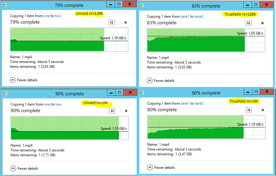

Likely some other issue, I'm using like 12 zfs pools without any issues, and pool to pool copy was even a little faster that TrueNAS, not by much, but certainly not slower.
I didn't remember if I still had this but a few months ago I tested with both Unraid and TrueNAS, copy from one zfs pool to another, using the exact same hardware and settings, copy was done using Windows explorer but they were done locally using Samba's server side copy, no network involved:
