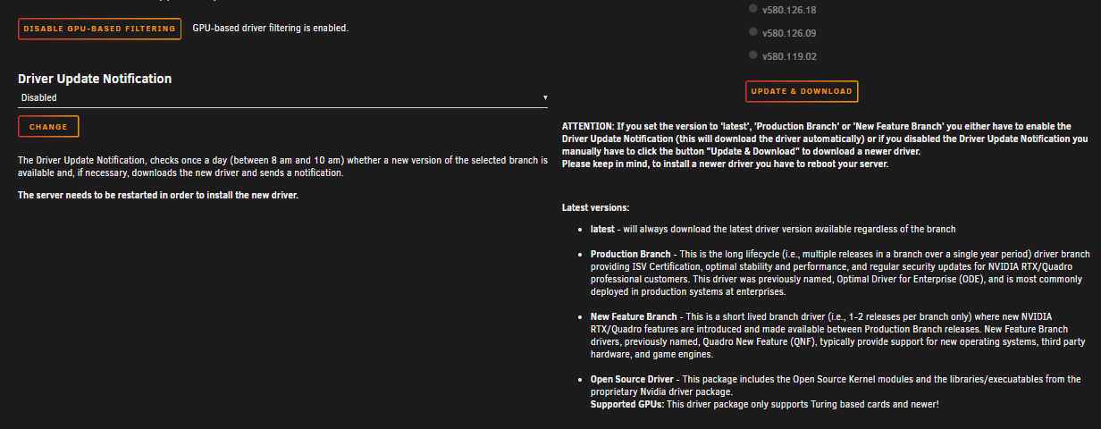

  11. --gpus=all is the modern, supported method for gpu passthrough as per Dockers documentation (linked). It does work on Unraid, I use it currently in 7.2, but there are regressions in 7.3.x, which look likely to be issues with nvidia-container-toolkit. https://docs.docker.com/engine/containers/gpu/
