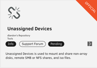

I have my reasons for not wanting to use synology for docker.  But I hear ya.  im looking at the docs and wasn't wrapping my head around the part where I use the NFS share.. it appeared to work with spare drives that weren't part of the array.  I didn't see how to make an nfs share an unassigned drive but I haven't installed it yet still trying to understand how to install it in the apps store.  it says pending so im doing some reading lol.
Alright ty it looks like this would indeed solve my needs.  a reboot took care of the pending thing btw :P

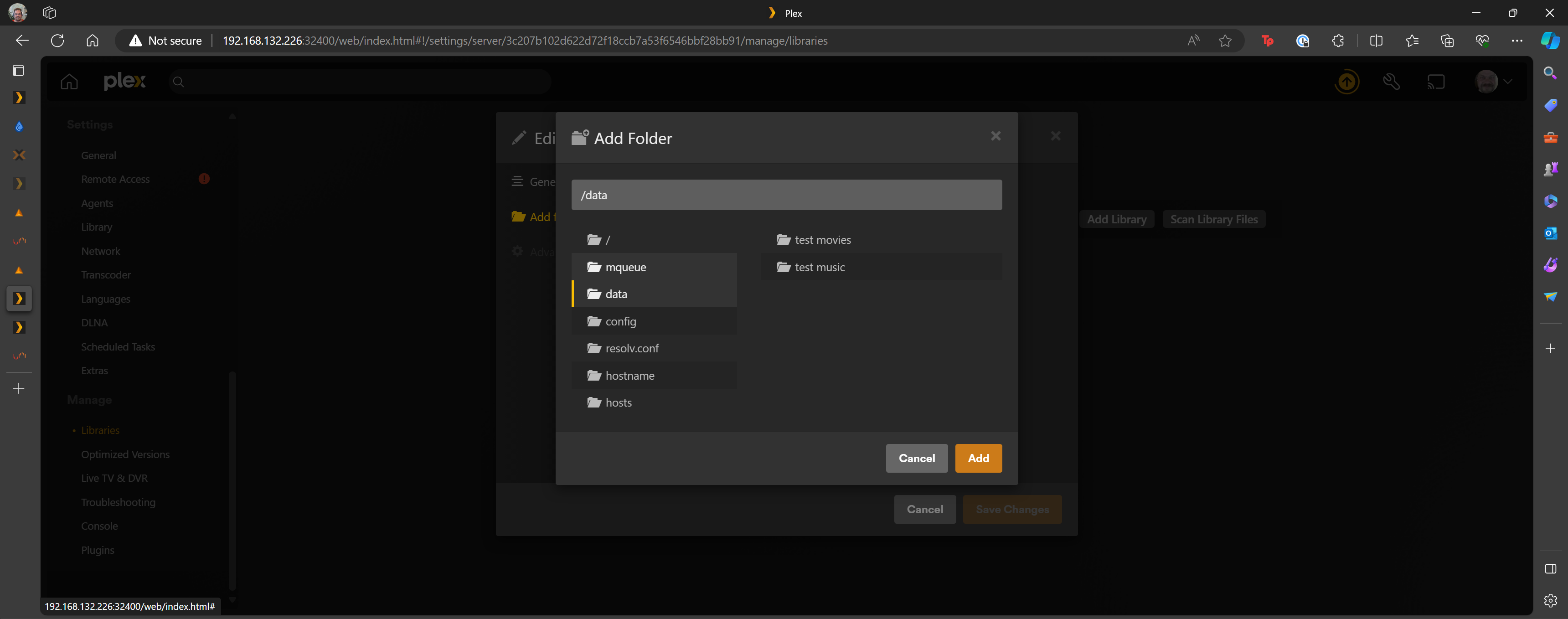

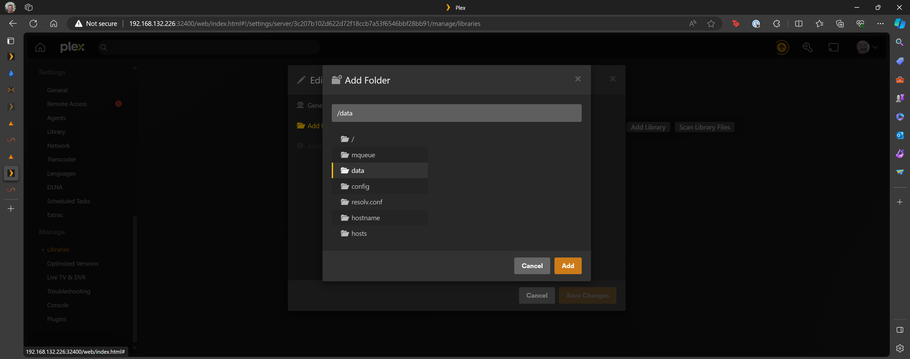

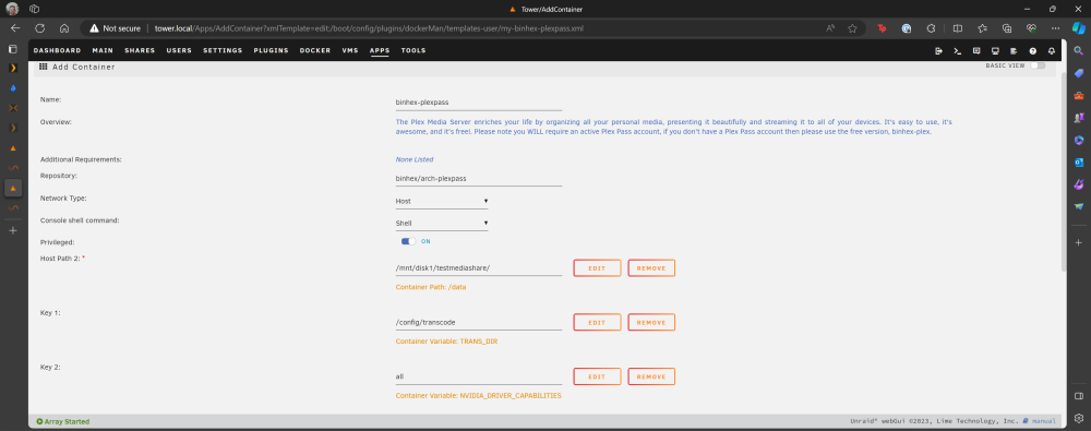

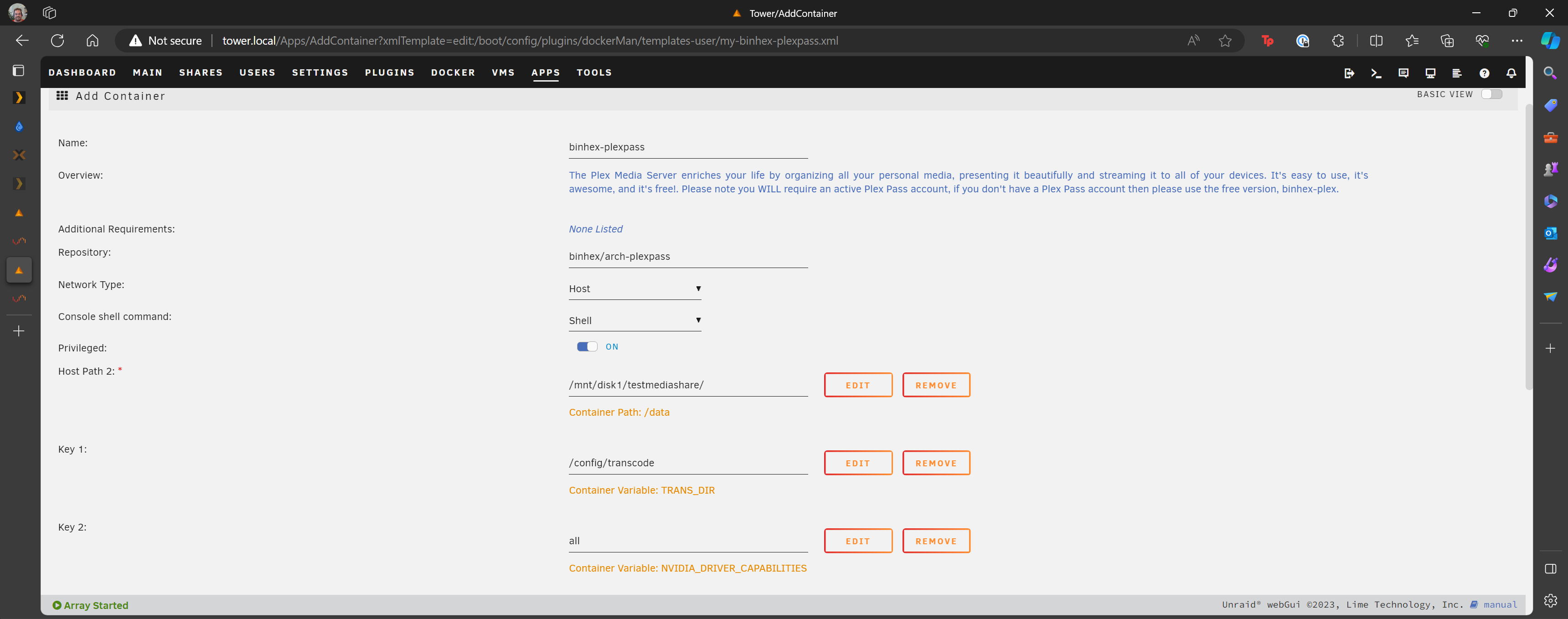

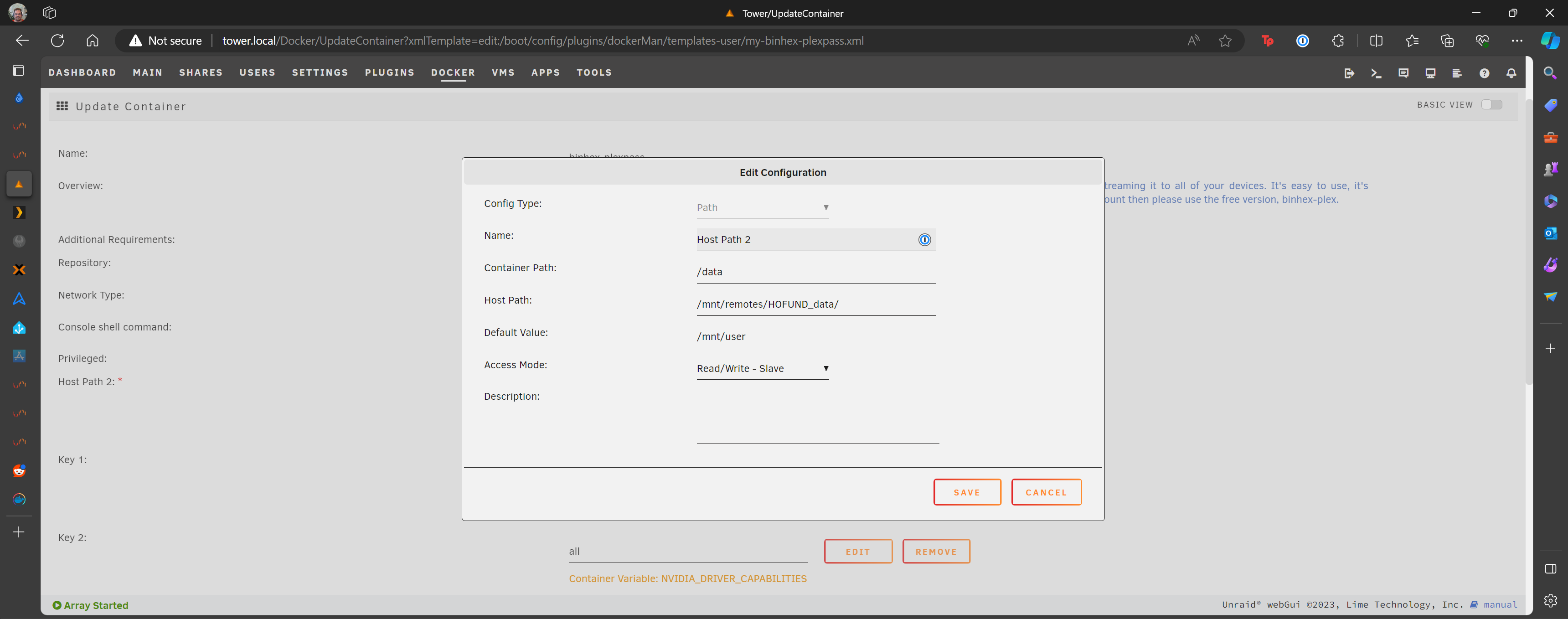

I have a somewhat related question pertaining to UD.  I installed plex and used the UD NFS share and for whatever reason binhex plex shows no folders listed under the volume mapped path when i try to setup libraries.
If I map a volume to a regular share in unraid (not UD) it works no problem.
My other docker container (delugevpn) had no issues seeing the mapped volume.  This may only be a binhex specific issue..
Try changing the mount to R/W Slave.

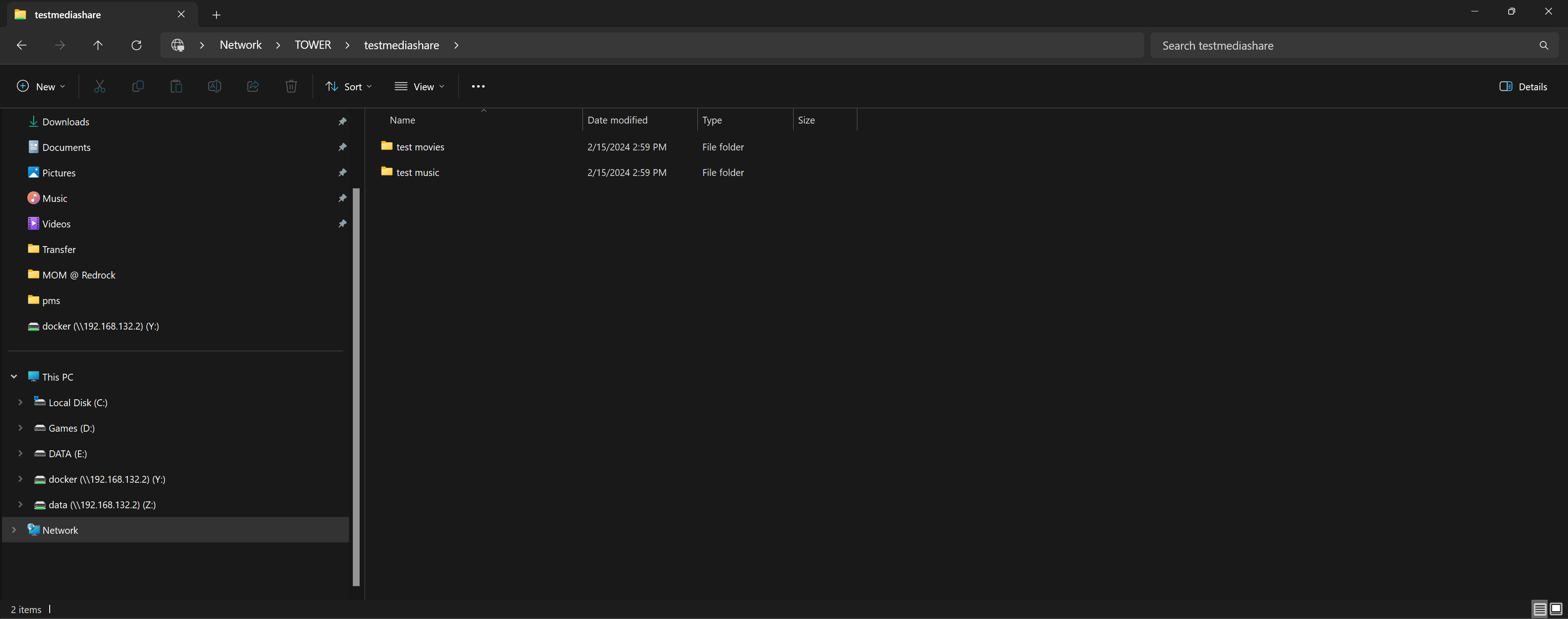

still wont load folders..  the NFS share is online.. i can browse from deluge preferences (another vm on unraid using same NFS share)
ok I was wrong.  my earlier test wasn't actually successful on deluge.  i changed it to slave as well and it's also still breaking.

I was able to find some help in discord and it was the NFS permissions…. The most obvious place to look.  Now that I’m thoroughly embarrassed I’ll go hide my face lol.
