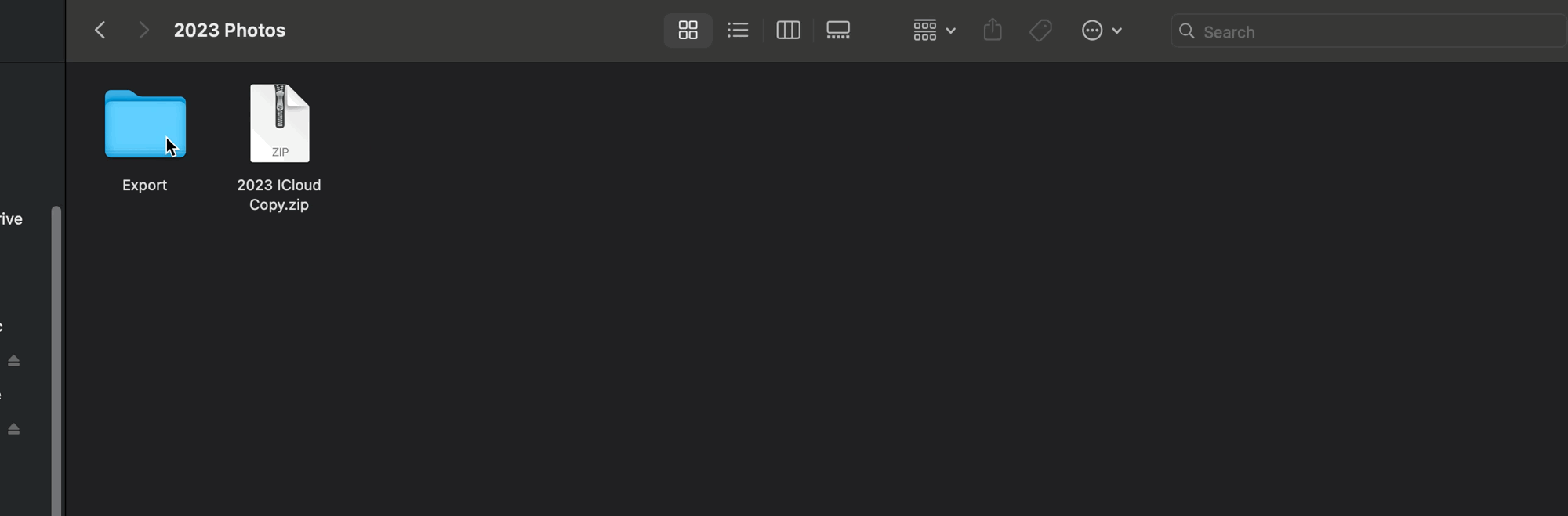

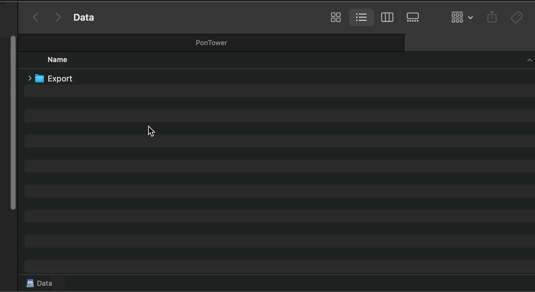

  6. Except when I run a Truenas VM inside Unraid, the Image previews load instantly on a test SMB share and the folder itself loads fast. Yet the same share inside Unraid has slow previews and the files don't appear for ages. Here is an example I just took and this is one the better examples.. Here is then Truenas VM Share which loads fast and Includes preview images.

  8. I have a Mac with 10GBps link, transfer speed is fine. The issues come when you have a folder with like over 300 images. Is it possible for you to confirm no issues in this scenario

  12. So I have tried this, simply making a fresh truenas VM within Unraid with base settings is insane fast and works out of the box, has anyone else got the time to confirm and spin up a Truenas VM, It must be something in the OS, we should NOT need a million settings to get better performance
  13. There has been some major issues with SMB speed on Unraid for a while, Unfortunately due to not many users using Mac's for access it does not come up. I have done some more testing today that may help. Test folder with 300 Images Unraid 6.12.6 Fresh install with NVME SSD Share = Crap SMB speed loading photos Truenas SCALE Fresh build with simple 1 Drive SMB Test = Fast loading of photos, expected speed Truenas SCALE Fresh Build VM within the same Unraid install with simple 1 Drive SMB Test = Fast loading of photos, expected speed What's going on?
