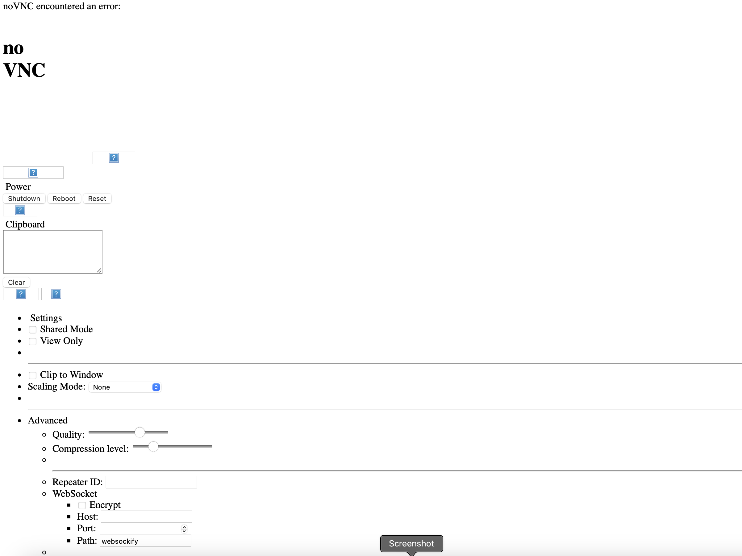

  16. I did move to Proxmox for the VM part and virtualise Unraid but then had some problems with Proxmox after upgrades with hanging boots so was easy to switch back to bare metal Unraid and reassign the disks. I want to give Unraid another Shot on the VM side but on my first day two issues stick out. 1. Does anyone get this Error page when opening VNC view from the GUI, its really annoying.. (Browser = Safari) 2. The VM crashes for some reason when VNCing to the machine via iPad (realvnc), very strange (RealVNC) Desktop the VM does not crash. It's an instant crash, Really stumped by this one, is Unraid seeing some sort of signal or crashing, it's hard to tell. 3.PCIE errors show when starting a VM with PCIE Express disks passed through when stopping the VM, Is this the GUI saying it's stopped before it actually has? Second start after the PCIE error message then starts the VM.

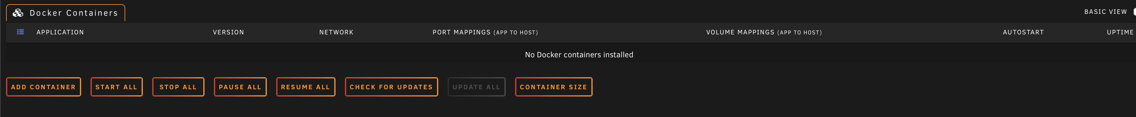

  19. Is it normal to have to click all the little box's on restore? Clicking like 40 box's manually is a bit of a drag. Secondly is there any chance we could have a progress bar/number per restore of each Tar.GZ pretty please. I am doing a restore now and it's stuck on a small docker. I just restored and my docker tab is empty despite restoring all XML's too. I assume this is normal and a limitation, upon choosing each template it worked fine.
