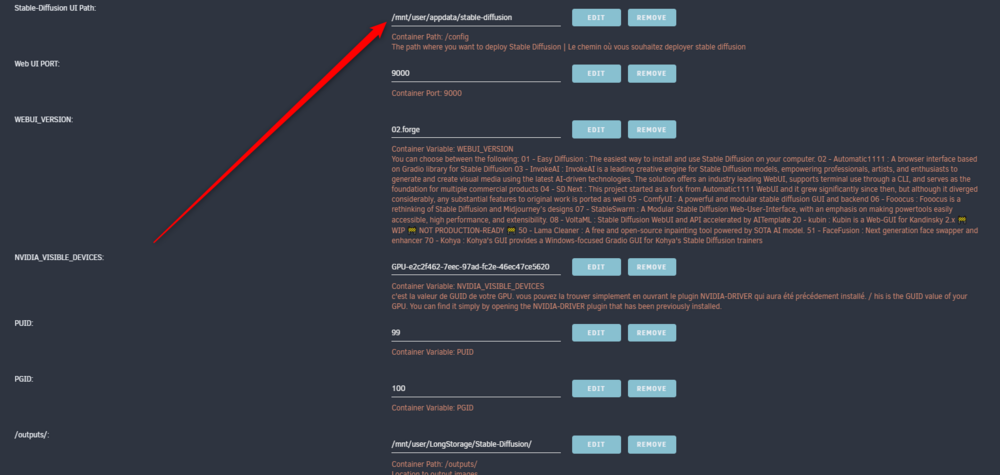

EDIT: Updating the UI container path to /opt/stable-diffusion seems to have fixed the issue (I had it set this way previously, so it was likely deleting the easydiffusion folder and restarting the docker that did the trick).
