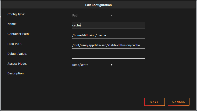

This docker fills up the entire default UNRAID space reserved for docker... so you have to either make the default larger than 20Gb, or find a way to make it download the files and access them from local storage (without breaking their app).  Mine is 17% full normally and goes to 100% when trying to install this.  I suspect you have the same issue.
Perhaps it's the cache folder. With everything that is downloaded it could effectively grow a lot.
You can add a path to store this outside of the image
Thanks!  I tested that and it does prevent all the reserve docker space from filling.  Item finishes compiling (I used UI option 03), then shuts down because it can't find invokeai.

They changed the command name 😵
I will update that before tomorrow.
I also changed the default cache path to a path that's mapped on unraid to prevent filling docker.img
(it will no longer be necessary to add a path like I told you to do)

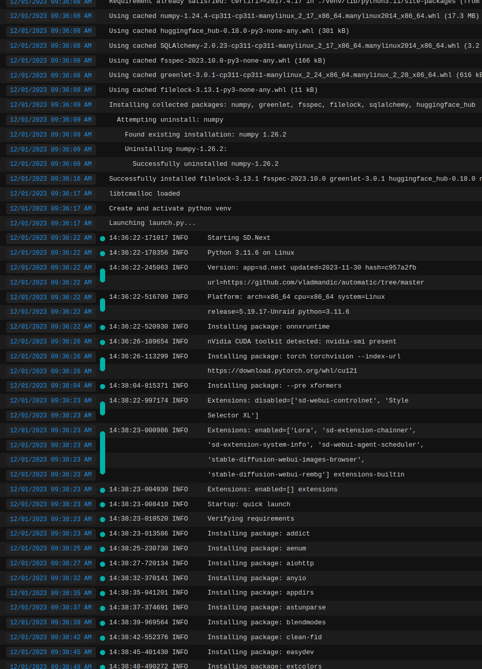

Appreciate the learning experience but these pain points are pretty painful..if you have time -- everytime i restart the container (not update the image, just restart) using SD.Next is reinstalls everything. image.thumb.png.8432f5c64a37d3b76e9c0725d2cb66b7.png
My server is low-power, 10-year 1.7ghz xenon...it takes 15+ minutes to get to a ready state every time I need to restart it due to a server error or just tinkering. It makes iteration extremely slowly and painful. If this is something I can prevent by adjusting SD.Next settings let me know but I have a hunch its due to the way the docker image is setup but I can't verify this since I can't see the Dockerfile!
I'd prefer to get my hands dirty and help improve the experience/dockerfile myself since I've got tons of experience here but it feels like my hands are tied right now.

I'm also running into the same issue that @FoxxMD is experiencing. Whenever I restart a container, there is a long sequence of installing that needs to occur.
