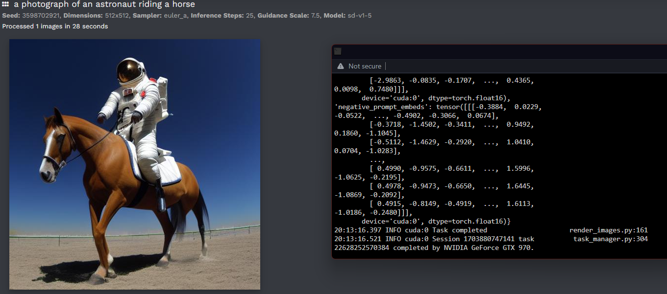

Working with 970 GTX 4GB (3.5GB) so far, I doubt all features will.

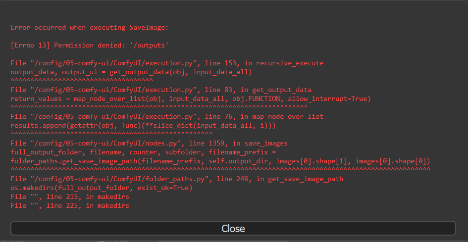

Hey guys, something wrong with the output directory? I keep getting this in comfyui:
EDIT:
I found out, that the parameters txt file was wrong and still had the old path. Maybe this should be added as a migration step into the container
Edited by Joly0

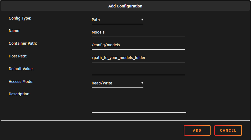

I have (05) ComfyUI installed. If I want to try something else like (70) Kohya, do I just edit the template and select a different WebUI port and WEBUI_VERSION 70 and apply? Or would this require a separate container?
For ComfyUI I see there's a parameters.txt file that allows you to set the output directory, which defaults to a path in /config, and models are also stored in /config. In my case /config is actually a folder in the appdata share on an NVME cache drive. This drive is likely going to run out of space quickly if I store models and output there.
I know that ComfyUI has a yaml file that lets you point to another folder for models. So I can put models somewhere else and point ComfyUI at that location. How does the docker container use the models folder that it sets up? Will all installed UIs automatically look there in addition to anything set up by each UI? And if so, can I move that models folder somewhere else? I would prefer not to move my appdata share. I suppose I could set up the stable diffusion config folder outside appdata, but that doesn't seem right, although I can't think of a good reason why it would be wrong. (Maybe appdata backup would be a bit of a problem?)
I've tried pinokio (browser based front-end for various stable diffusion UIs) in Windows and it seems to be a little like this container - lets you download and install various UIs, but documentation is a bit sparse.
You can just edit the template and change the WEBUI_VERSION.
Interfaces are stored in different folders and work alongside each others.
You can even run multiple containers pointing to the same local folder at the same time.
If you want to split data, you can edit the container and add a path like this :
You can do the same thing for the output folder that also have a tendency to grow fast :)

I'm trying to upgrade to the new version with comfy-ui and for some reason it seems to be looking for `/outputs` and not `/config/outputs`:
comfy-ui  | FileNotFoundError: [Errno 2] No such file or directory: '/outputs/05-comfy-ui/'
comfy-ui  |
comfy-ui  | During handling of the above exception, another exception occurred:
comfy-ui  |
comfy-ui  | Traceback (most recent call last):
comfy-ui  |   File "/config/05-comfy-ui/ComfyUI/execution.py", line 153, in recursive_execute
comfy-ui  |     output_data, output_ui = get_output_data(obj, input_data_all)
comfy-ui  |                              ^^^^^^^^^^^^^^^^^^^^^^^^^^^^^^^^^^^^
comfy-ui  |   File "/config/05-comfy-ui/ComfyUI/execution.py", line 83, in get_output_data
comfy-ui  |     return_values = map_node_over_list(obj, input_data_all, obj.FUNCTION, allow_interrupt=True)
comfy-ui  |                     ^^^^^^^^^^^^^^^^^^^^^^^^^^^^^^^^^^^^^^^^^^^^^^^^^^^^^^^^^^^^^^^^^^^^^^^^^^^
comfy-ui  |   File "/config/05-comfy-ui/ComfyUI/execution.py", line 76, in map_node_over_list
comfy-ui  |     results.append(getattr(obj, func)(**slice_dict(input_data_all, i)))
comfy-ui  |   File "/config/05-comfy-ui/ComfyUI/nodes.py", line 1359, in save_images
comfy-ui  |     full_output_folder, filename, counter, subfolder, filename_prefix = folder_paths.get_save_image_path(filename_prefix, self.output_dir, images[0].shape[1], images[0].shape[0])
comfy-ui  |                                                                         ^^^^^^^^^^^^^^^^^^^^^^^^^^^^^^^^^^^^^^^^^^^^^^^^^^^^^^^^^^^^^^^^^^^^^^^^^^^^^^^^^^^^^^^^^^^^^^^^^^^^^^^^^^
comfy-ui  |   File "/config/05-comfy-ui/ComfyUI/folder_paths.py", line 246, in get_save_image_path
comfy-ui  |     os.makedirs(full_output_folder, exist_ok=True)
comfy-ui  |   File "<frozen os>", line 215, in makedirs
comfy-ui  |   File "<frozen os>", line 225, in makedirs
comfy-ui  | PermissionError: [Errno 13] Permission denied: '/outputs'
comfy-ui  |
comfy-ui  | Prompt executed in 9.03 seconds
comfy-ui  | gc collect
