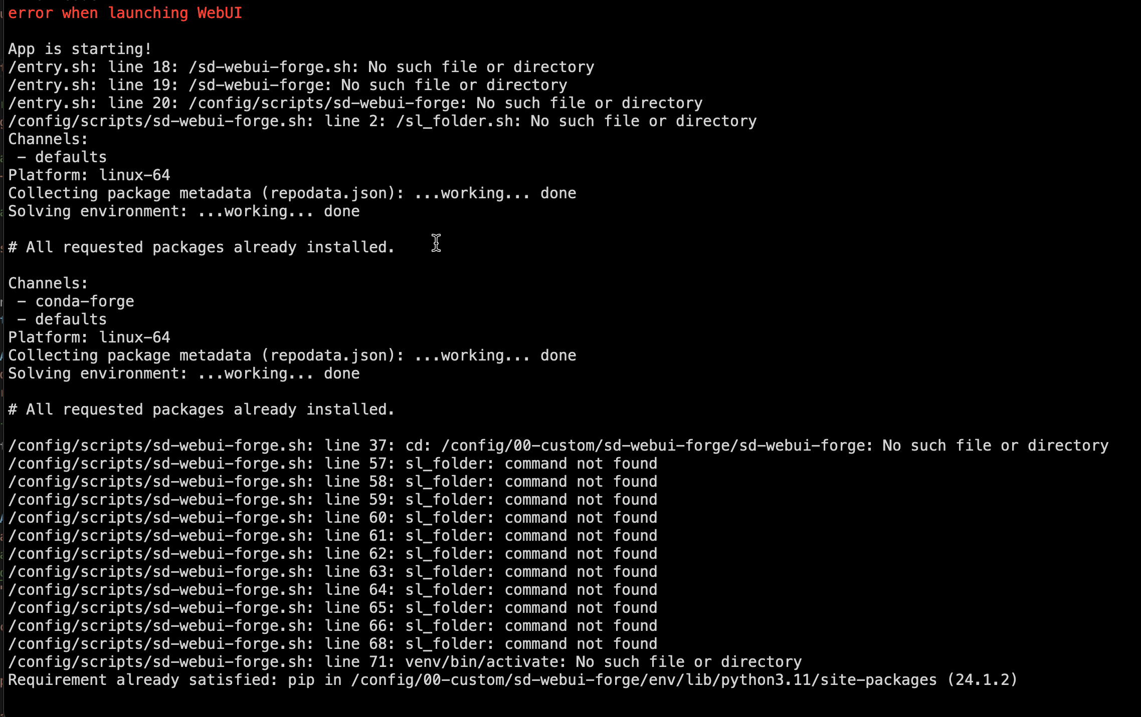

Did anything change recently?
I'm having a lot of problems with easy-diffussion. I'm getting "error when launching WebUI" on new installs.
Ideas?
I'm also having issues.
an update to python's setuptools has broken Automatic1111.  According to the issue ticket, you are supposed to fix it by rolling setuptools back to a version pre-70.  I'm still trying to figure out how to do it inside the docker.  I've tried using the console for both Unraid and the container.
Ideas?
I just tried installing it for the first time and am getting the same error. I tried several different UI options with the same result.
Edit... the Fooocus UI works, but some of the others do not.

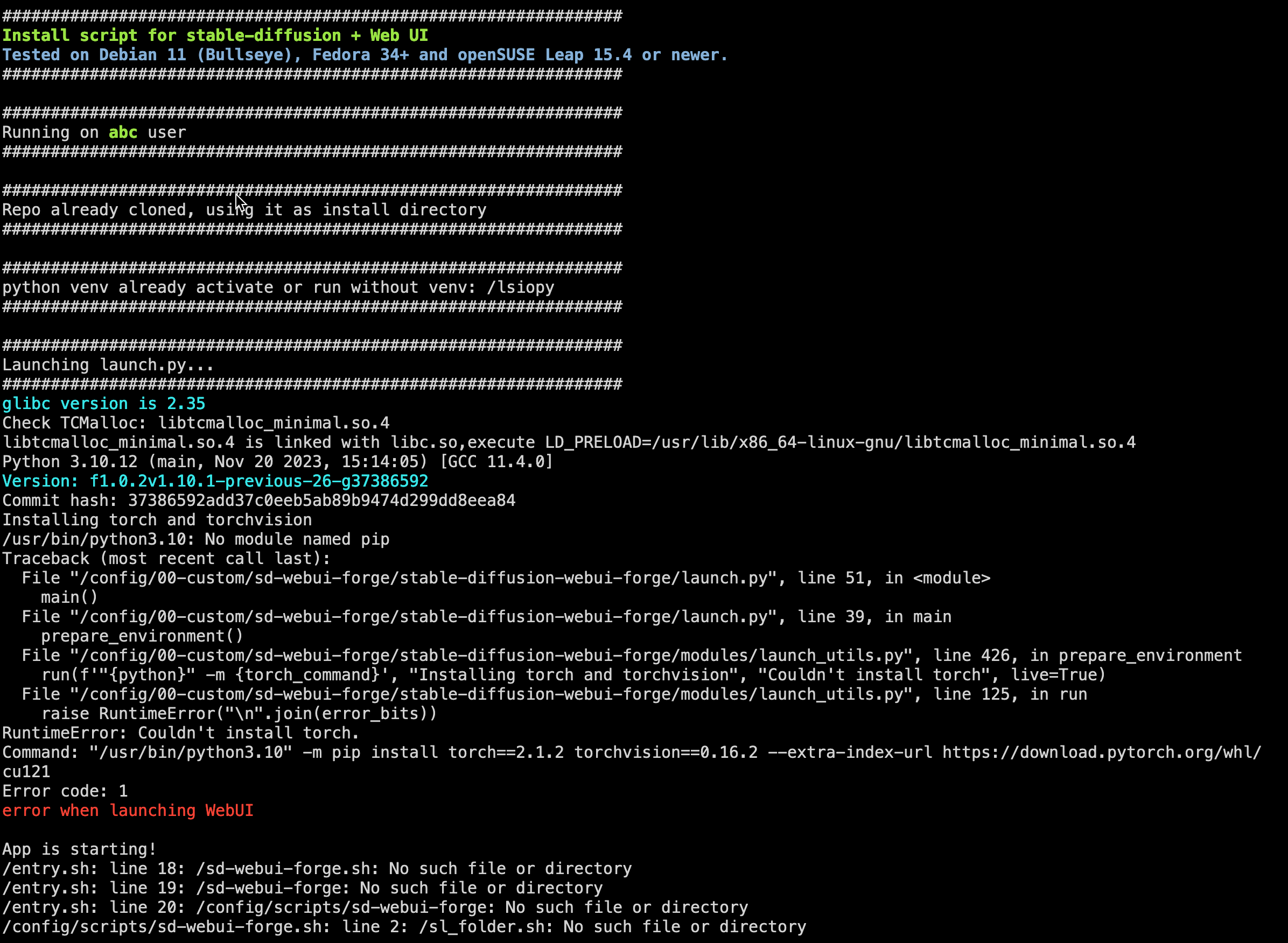

Heya, been using this perfectly for a while. But on Saturday morning i noticed it was boot looping with the following error when using 02.forge
Launching launch.py...
glibc version is 2.35
Check TCMalloc: libtcmalloc_minimal.so.4
libtcmalloc_minimal.so.4 is linked with libc.so,execute LD_PRELOAD=/usr/lib/x86_64-linux-gnu/libtcmalloc_minimal.so.4
Python 3.10.12 (main, Nov 20 2023, 15:14:05) [GCC 11.4.0]
Version: f1.0.2v1.10.1-previous-26-g37386592
Commit hash: 37386592add37c0eeb5ab89b9474d299dd8eea84
Installing torch and torchvision
/usr/bin/python3.10: No module named pip
  File "/config/02-sd-webui/forge/launch.py", line 51, in <module>
    main()
  File "/config/02-sd-webui/forge/launch.py", line 39, in main
    prepare_environment()
  File "/config/02-sd-webui/forge/modules/launch_utils.py", line 426, in prepare_environment
    run(f'"{python}" -m {torch_command}', "Installing torch and torchvision", "Couldn't install torch", live=True)
  File "/config/02-sd-webui/forge/modules/launch_utils.py", line 125, in run
    raise RuntimeError("\n".join(error_bits))
RuntimeError: Couldn't install torch.
Command: "/usr/bin/python3.10" -m pip install torch==2.1.2 torchvision==0.16.2 --extra-index-url https://download.pytorch.org/whl/cu121
Error code: 1
/02.forge.sh: line 74: wait: pid 99999 is not a child of this shell
/entry.sh: line 19: /02.forge: No such file or directory
/entry.sh: line 20: /config/scripts/02.forge: No such file or directory
/entry.sh: line 21: /config/scripts/02.forge.sh: No such file or directory
Bit of digging and pip wasn't being installed on python3.10. Manually installed via https://pip.pypa.io/en/stable/installation/#get-pip-py and got a bit further, then found python3-packaging was missing so added that via apt and now seems good to go again.
Just the below in the end resolved it.
wget https://bootstrap.pypa.io/get-pip.py;python3.10 get-pip.py
apt update;apt install python3-packaging
Not sure why, cant see any mods on the container so guessing its an updated script somewhere?

Hello all and @superboki trying to install Forge as A1111 takes to long on my 1660 Super but i seen to be in a loop with a error with script2024-07-28_17-14-26.thumb.png.c0a1b12bd9587ed1dcd9c1d37326ed92.png2024-07-28_17-14-52.thumb.png.0ebf0ff63968ba91be1e26a6b45c9a0e.png
I was able to resolve for standard 02 A1111 and 02.forge (the only two I tried) by running the following three commands in docker console AFTER the error appeared in the log.  All were mentioned in above posts but took me a few tries before I got it right.
Executed in order:
pip install setuptools==69.5.1
Executed in order:
Yup can confirm this works. I needed to install python3-dev instead so that I could manually install insightface
