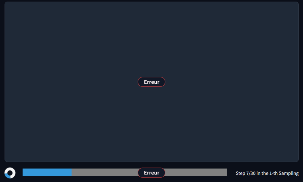

but it crashes at the first test
1 hour ago, yoda42 said:
yes, you're right, the installation was carried out correctly with the modifications indicated on the holaf Repository
me too.
Im just rolling back until this gets worked out.
I don't have this kind of error on my side :/

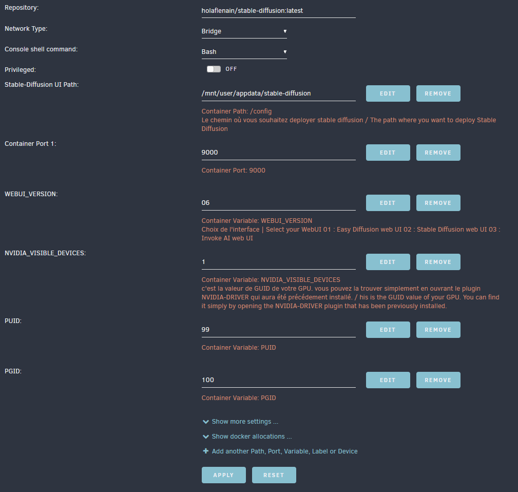

FYI, I made a screenshot of my template if you want to compare with yours.
I saw that I made a mistake for the save folder of Fooocus, it should be fixed now (3.0.2)
If you still have those crashes, can you post the output of the logs ?
Thanks :)

FYSA, the unraid app looks like this when you grap it from the app store.
