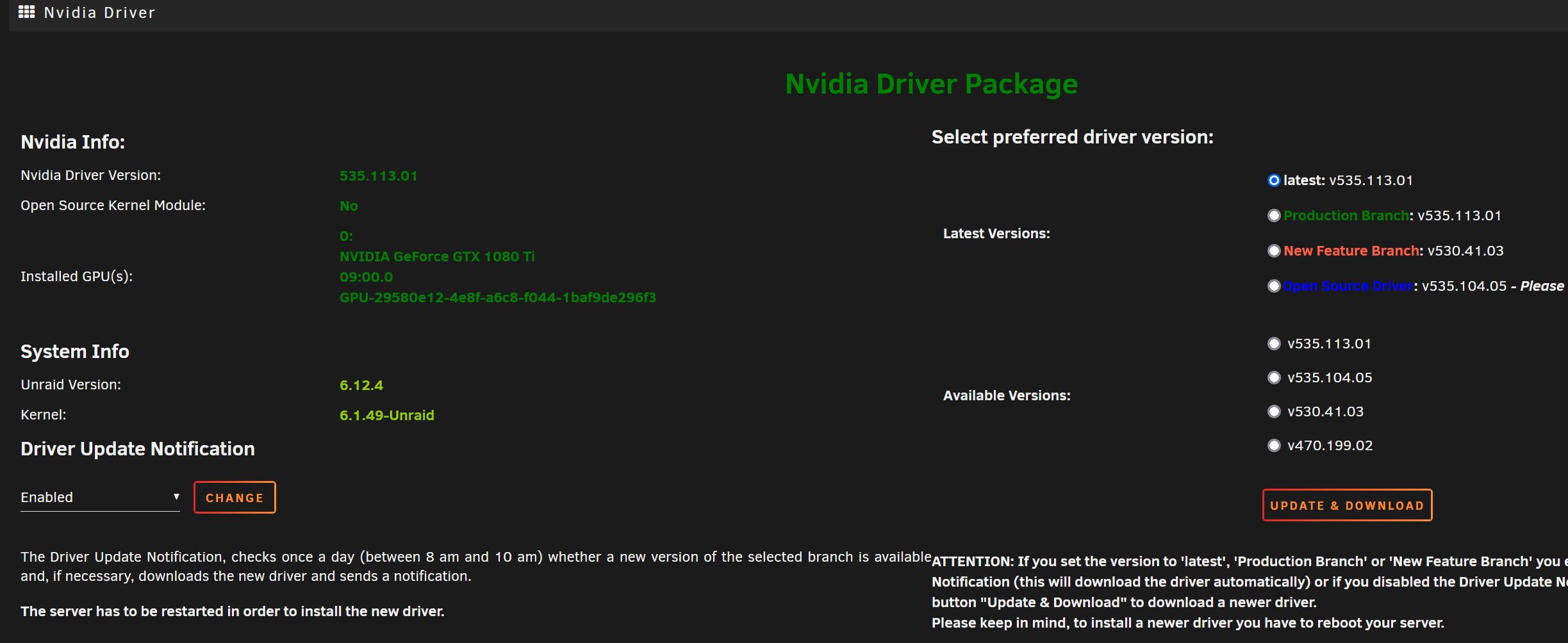

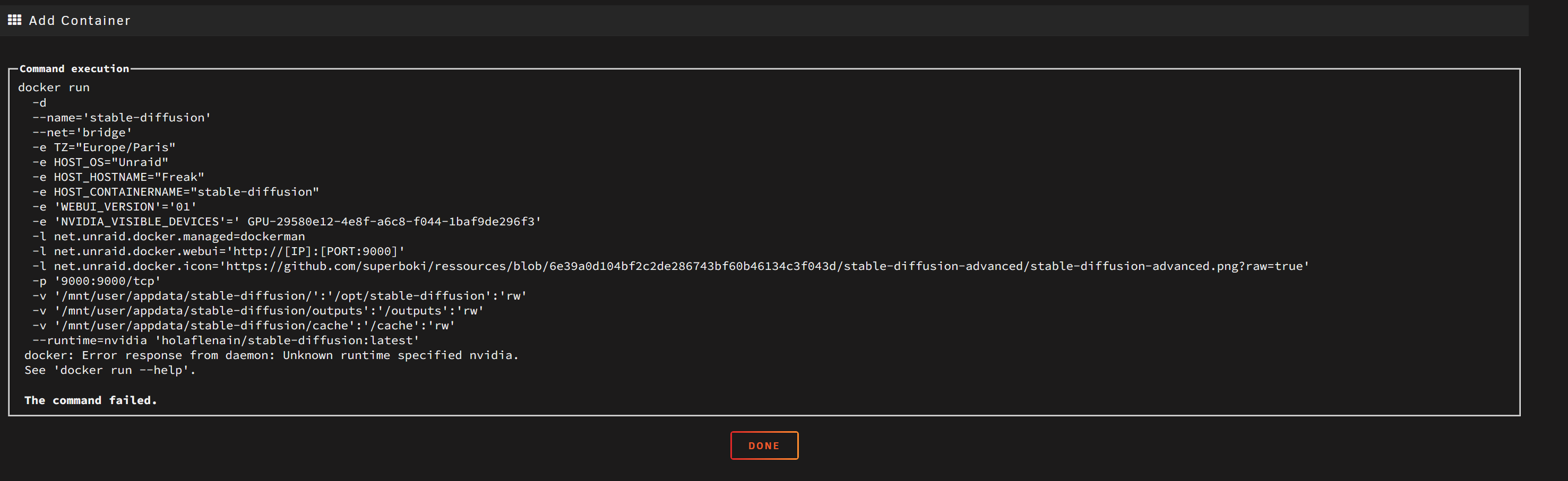

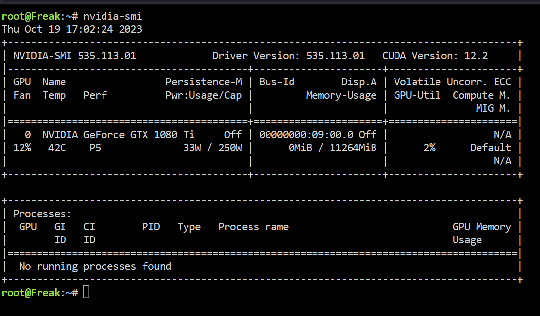

Hi noob here
i tried to install this added the gpuid to the container but i still failed and i have no idea why and what to do
maybe i have the wrong nvidia driver should i install the open source one or other version ?
Edited by JapanFreak
I have the same driver, so it should work 🤔
Can you try to uninstall/reinstall the plugin ?
can you also check if the driver is running with the command "nvidia-smi" ?
Try taking out the specific GPU ID and use use "all" (no quotes).
Error response from daemon: Unknown runtime specified nvidia.
See 'docker run --help'.
The command failed.
thats what i get with all
thats what i get when i runn the command it says off so i am not sure it works
as for reisntalling i tried like 6 times every time i get Error response from daemon: Unknown runtime specified nvidia.
thanks for your replays
I believe that the runtime comes with the nvidia driver, so for me it's a bug with the nvidia plugin or your server, but not with my container 🤷‍♂️

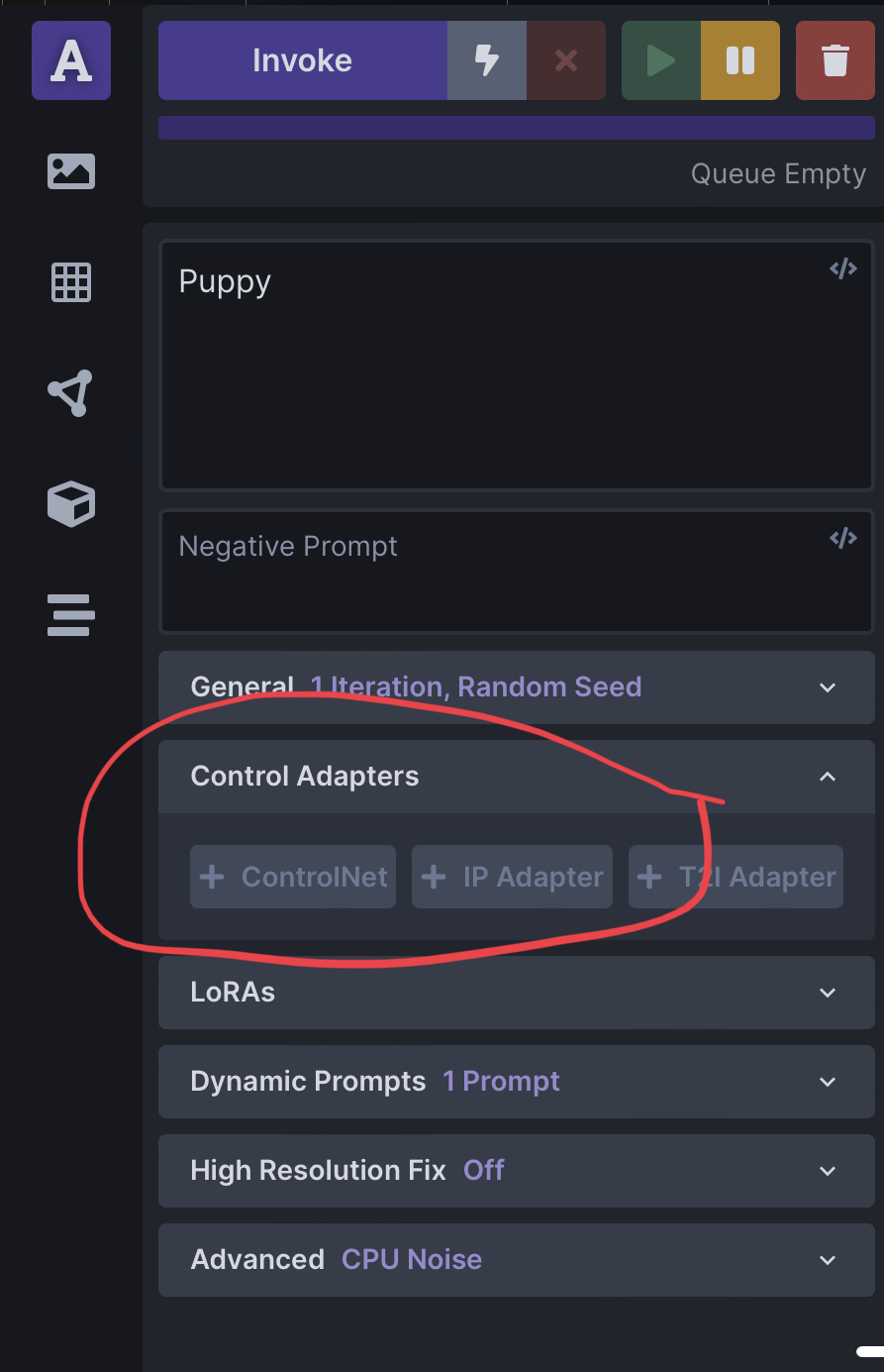

Any ideas why ControlNet is disabled when using Invoke? I noticed that my models/sd-1/controlnet folder is empty.
I tried to do a fresh install and invokeAI downloaded by itself controlnet models (it took some time after I could connect to the webUI)
Perhaps you could try to remove or rename the actual invokeAI folder and try to install it again
I renamed the 03-invakeai folder and started up the container. It re-downloaded Invoke and ControlNet is accessible now. Thank you!
Maybe there was a better way to do it that would have retained all my assets and settings, but this worked and I didn't have anything important there.
Honestly, the way InvokeAI handles models/settings is still a bit of a mystery for me 😅
