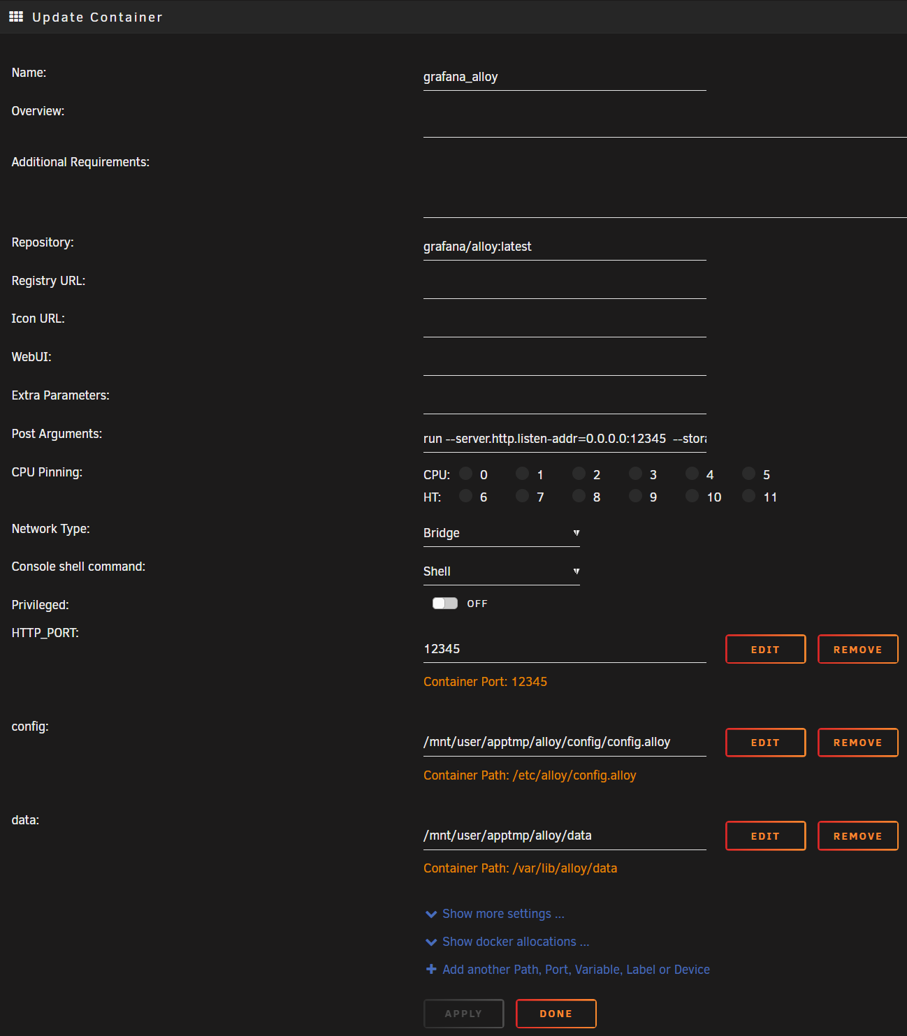

  5. You're just missing some single quotes for the command line version. This works: docker run \ -v '/mnt/user/apptmp/alloy/config/config.alloy':'/etc/alloy/config.alloy' \ -v '/mnt/user/apptmp/alloy/data':'/var/lib/alloy/data' \ -p 12345:12345 'grafana/alloy:latest' run --server.http.listen-addr=0.0.0.0:12345 \ --storage.path=/var/lib/alloy/data /etc/alloy/config.alloy docker run -d --name='grafana_alloy' --net='bridge' -e TZ="America/Chicago" -e HOST_OS="Unraid" -e HOST_HOSTNAME="unraid" -e HOST_CONTAINERNAME="grafana_alloy" -l net.unraid.docker.managed=dockerman -p '12345:12345/tcp' -v '/mnt/user/apptmp/alloy/config/config.alloy':'/etc/alloy/config.alloy':'rw' -v '/mnt/user/apptmp/alloy/data':'/var/lib/alloy/data':'rw' 'grafana/alloy:latest' run --server.http.listen-addr=0.0.0.0:12345 --storage.path=/var/lib/alloy/data /etc/alloy/config.alloy The command finished successfully! root@unraid:/mnt/user/apptmp# docker run -v '/mnt/user/apptmp/alloy/config/config.alloy':'/etc/alloy/config.alloy' -v '/mnt/user/apptmp/alloy/data':'/var/lib/alloy/data' -p 12345:12345 'grafana/alloy:latest' run --server.http.listen-addr=0.0.0.0:12345 --storage.path=/var/lib/alloy/data /etc/alloy/config.alloy Unable to find image 'grafana/alloy:latest' locally latest: Pulling from grafana/alloy 062e51aa1fb4: Pull complete 568a2bf5c15e: Pull complete a5989d15309e: Pull complete dec2c180ab5e: Pull complete 538aed975229: Pull complete 8f4b5a01bf79: Pull complete 2e8fdb5249b7: Pull complete 680f4980a78e: Pull complete b50d16a2a55f: Pull complete 10fa0ec2e27f: Pull complete f2044796f2e3: Pull complete d711b3e3ab2d: Pull complete Digest: sha256:21248ad12831ad8f7279eb40ecd161b2574c2194ca76e7413996666d09beef6c Status: Downloaded newer image for grafana/alloy:latest ts=2024-04-20T11:32:35.539372042Z level=info "boringcrypto enabled"=false ts=2024-04-20T11:32:35.539391212Z level=info msg="running usage stats reporter" ts=2024-04-20T11:32:35.539394852Z level=info msg="starting complete graph evaluation" controller_path=/ controller_id="" trace_id=8eefe7ba571d06d72adae41eee1e925c ts=2024-04-20T11:32:35.539401922Z level=info msg="applying non-TLS config to HTTP server" service=http ts=2024-04-20T11:32:35.539404792Z level=info msg="finished node evaluation" controller_path=/ controller_id="" trace_id=8eefe7ba571d06d72adae41eee1e925c node_id=http duration=9.72µs ts=2024-04-20T11:32:35.539409422Z level=info msg="finished node evaluation" controller_path=/ controller_id="" trace_id=8eefe7ba571d06d72adae41eee1e925c node_id=cluster duration=770ns ts=2024-04-20T11:32:35.539413422Z level=info msg="finished node evaluation" controller_path=/ controller_id="" trace_id=8eefe7ba571d06d72adae41eee1e925c node_id=ui duration=660ns ts=2024-04-20T11:32:35.539417062Z level=info msg="finished node evaluation" controller_path=/ controller_id="" trace_id=8eefe7ba571d06d72adae41eee1e925c node_id=tracing duration=7.51µs ts=2024-04-20T11:32:35.539425671Z level=info msg="finished node evaluation" controller_path=/ controller_id="" trace_id=8eefe7ba571d06d72adae41eee1e925c node_id=logging duration=58.119µs ts=2024-04-20T11:32:35.539456141Z level=info msg="finished node evaluation" controller_path=/ controller_id="" trace_id=8eefe7ba571d06d72adae41eee1e925c node_id=remotecfg duration=24.39µs ts=2024-04-20T11:32:35.539464411Z level=info msg="finished node evaluation" controller_path=/ controller_id="" trace_id=8eefe7ba571d06d72adae41eee1e925c node_id=labelstore duration=1.93µs ts=2024-04-20T11:32:35.539470341Z level=info msg="finished node evaluation" controller_path=/ controller_id="" trace_id=8eefe7ba571d06d72adae41eee1e925c node_id=otel duration=430ns ts=2024-04-20T11:32:35.539475211Z level=info msg="finished complete graph evaluation" controller_path=/ controller_id="" trace_id=8eefe7ba571d06d72adae41eee1e925c duration=165.439µs ts=2024-04-20T11:32:35.539561361Z level=info msg="scheduling loaded components and services" ts=2024-04-20T11:32:35.53970125Z level=info msg="starting cluster node" peers="" advertise_addr=127.0.0.1:12345 ts=2024-04-20T11:32:35.539850499Z level=info msg="peers changed" new_peers=0d3e537e0714 ts=2024-04-20T11:32:35.540061967Z level=info msg="now listening for http traffic" service=http addr=0.0.0.0:12345 <?xml version="1.0"?> <Container version="2"> <Name>grafana_alloy</Name> <Repository>grafana/alloy:latest</Repository> <Registry/> <Network>bridge</Network> <MyIP/> <Shell>sh</Shell> <Privileged>false</Privileged> <Support/> <Project/> <Overview/> <Category/> <WebUI/> <TemplateURL/> <Icon/> <ExtraParams/> <PostArgs>run --server.http.listen-addr=0.0.0.0:12345 --storage.path=/var/lib/alloy/data /etc/alloy/config.alloy</PostArgs> <CPUset/> <DateInstalled>1713615655</DateInstalled> <DonateText/> <DonateLink/> <Requires/> <Config Name="HTTP_PORT" Target="12345" Default="" Mode="tcp" Description="" Type="Port" Display="always" Required="false" Mask="false">12345</Config> <Config Name="config" Target="/etc/alloy/config.alloy" Default="" Mode="rw" Description="" Type="Path" Display="always" Required="false" Mask="false">/mnt/user/apptmp/alloy/config/config.alloy</Config> <Config Name="data" Target="/var/lib/alloy/data" Default="" Mode="rw" Description="" Type="Path" Display="always" Required="false" Mask="false">/mnt/user/apptmp/alloy/data</Config> </Container>
