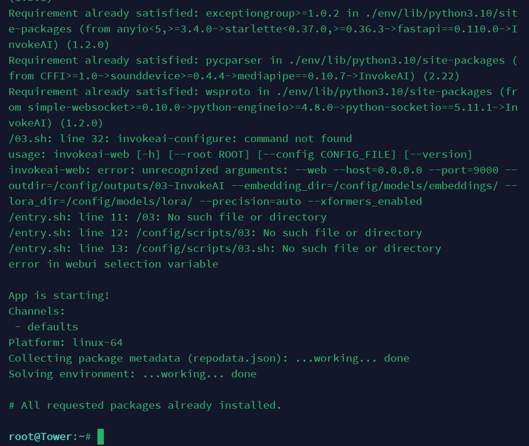

  5. I have been using invoke-ai It seemed it updated to version 4.0 upon startup. Now it's not launching and keep looping, i tried to find the command that is "not found" and edit the parameters.txt but am not sure what it's referring to. I've included a screenshot, anyone else had this?
