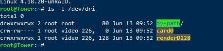

Intel GPU
1.  Edit your go file and add modprobe i915 to it, save and reboot.
2.  Add the Jellyfin container and add --device=/dev/dri to extra parameters (switch on advanced template view)  There is no need to chmod/chown the /dev/dri, this is handled by the container.

I would try to chown -R nobody:users /dev/dri

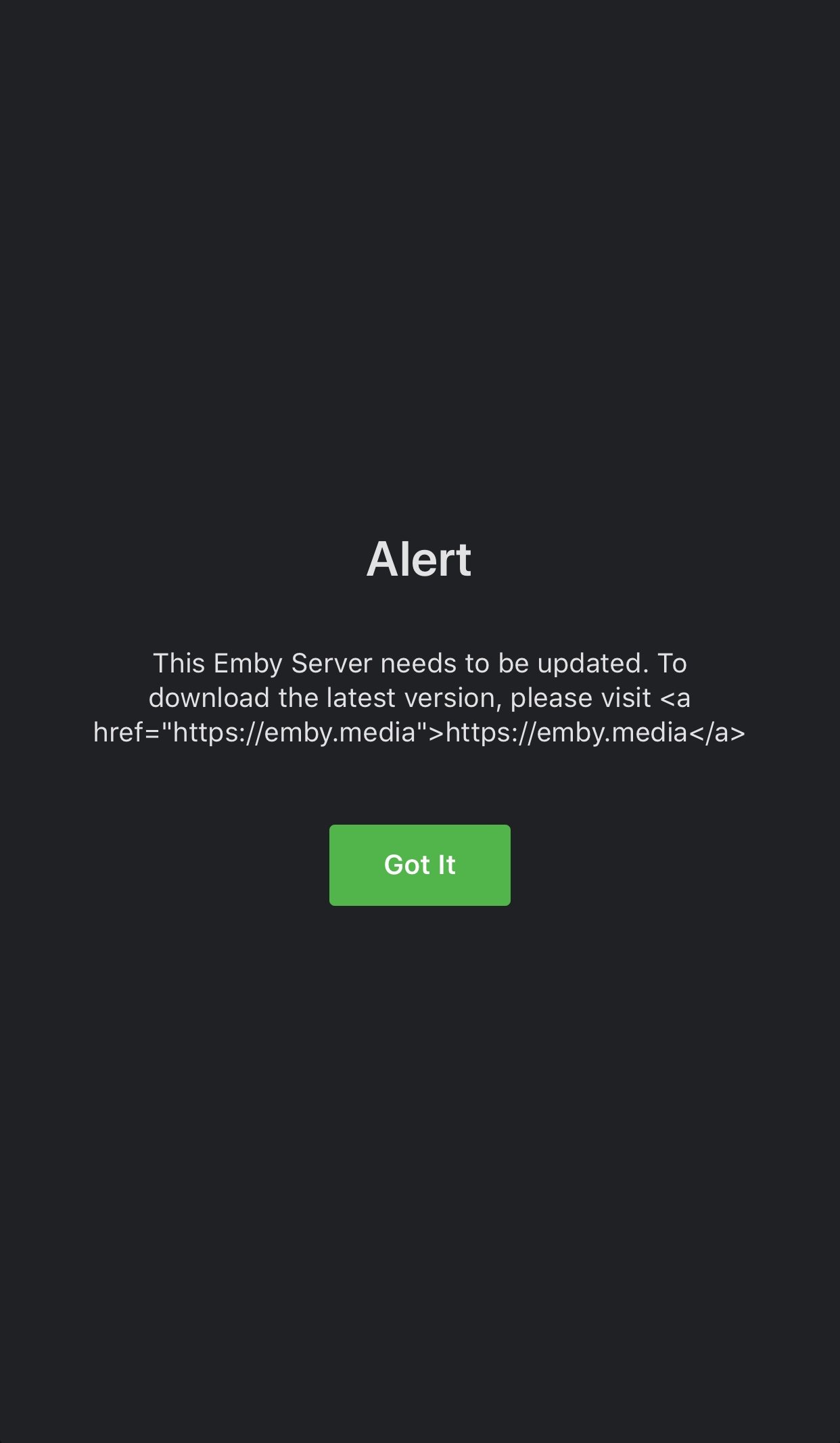

As far as I know, the emby clients doesn't connect to jellyfin. They added something to detect if it was an emby or jellyfin server. And the kodi plugin will not be working with jellyfin either.
Then I guess I'm going to have to pay either plex or emby some money then to use hw transcoding with clients around the house... bummer... especially because I'm a super cheap tightwad.
1 hour ago, 1812 said:
I had come across that. Anything I would want is either Deprecated and unreleasable or Deprecated but salvageable, sadly.
Start programming then 😉
On 6/22/2019 at 6:45 PM, 1812 said:
Tested this with a little gtx710 tonight in a browser and it worked! Now I just have to figure out how to make Emby apps use the Jellyfin server.... they keep telling me the Jellyfin server needs an update and then won’t do anything.
emby blacklisted jell* on their apps so none work with jellyfin. There's an android app and androidtv app. roku is super rough so far. not sure what else is up. reddit.com/r/jellyfin has more info
Edited by munit85
