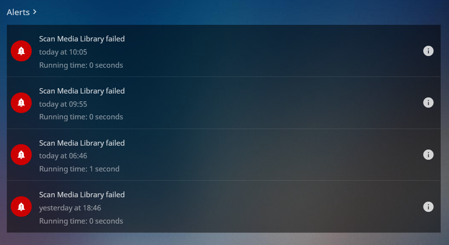

Hello,
with my jellyfin docker the daily scheduled scan of all libraries fails.
Connection timed out at System.Net.Http.ConnectHelper.ConnectAsync(String host, Int32 port, CancellationToken cancellationToken) at System.Net.Http.HttpConnectionPool.ConnectAsync(HttpRequestMessage request, Boolean allowHttp2, CancellationToken cancellationToken) at System.Net.Http.HttpConnectionPool.CreateHttp11ConnectionAsync(HttpRequestMessage request, CancellationToken cancellationToken) at System.Net.Http.HttpConnectionPool.GetHttpConnectionAsync(HttpRequestMessage request, CancellationToken cancellationToken) at System.Net.Http.HttpConnectionPool.SendWithRetryAsync(HttpRequestMessage request, Boolean doRequestAuth, CancellationToken cancellationToken) at System.Net.Http.RedirectHandler.SendAsync(HttpRequestMessage request, CancellationToken cancellationToken) at System.Net.Http.HttpClient.FinishSendAsyncUnbuffered(Task`1 sendTask, HttpRequestMessage request, CancellationTokenSource cts, Boolean disposeCts) at Emby.Server.Implementations.HttpClientManager.HttpClientManager.SendAsyncInternal(HttpRequestOptions options, HttpMethod httpMethod) at Emby.Server.Implementations.HttpClientManager.HttpClientManager.SendAsync(HttpRequestOptions options, HttpMethod httpMethod) at MediaBrowser.Providers.Manager.ProviderManager.SaveImage(BaseItem item, String url, ImageType type, Nullable`1 imageIndex, CancellationToken cancellationToken) at Emby.Server.Implementations.Library.LibraryManager.ConvertImageToLocal(BaseItem item, ItemImageInfo image, Int32 imageIndex) at Emby.Server.Implementations.Library.LibraryManager.UpdateImages(BaseItem item, Boolean forceUpdate) at MediaBrowser.Controller.Entities.Folder.ValidateChildrenInternal2(IProgress`1 progress, CancellationToken cancellationToken, Boolean recursive, Boolean refreshChildMetadata, MetadataRefreshOptions refreshOptions, IDirectoryService directoryService) at MediaBrowser.Controller.Entities.Folder.ValidateChildrenInternal(IProgress`1 progress, CancellationToken cancellationToken, Boolean recursive, Boolean refreshChildMetadata, MetadataRefreshOptions refreshOptions, IDirectoryService directoryService) at MediaBrowser.Controller.Entities.Folder.ValidateSubFolders(IList`1 children, IDirectoryService directoryService, IProgress`1 progress, CancellationToken cancellationToken) at MediaBrowser.Controller.Entities.Folder.ValidateChildrenInternal2(IProgress`1 progress, CancellationToken cancellationToken, Boolean recursive, Boolean refreshChildMetadata, MetadataRefreshOptions refreshOptions, IDirectoryService directoryService) at MediaBrowser.Controller.Entities.Folder.ValidateChildrenInternal(IProgress`1 progress, CancellationToken cancellationToken, Boolean recursive, Boolean refreshChildMetadata, MetadataRefreshOptions refreshOptions, IDirectoryService directoryService) at MediaBrowser.Controller.Entities.Folder.ValidateSubFolders(IList`1 children, IDirectoryService directoryService, IProgress`1 progress, CancellationToken cancellationToken) at MediaBrowser.Controller.Entities.Folder.ValidateChildrenInternal2(IProgress`1 progress, CancellationToken cancellationToken, Boolean recursive, Boolean refreshChildMetadata, MetadataRefreshOptions refreshOptions, IDirectoryService directoryService) at MediaBrowser.Controller.Entities.Folder.ValidateChildrenInternal(IProgress`1 progress, CancellationToken cancellationToken, Boolean recursive, Boolean refreshChildMetadata, MetadataRefreshOptions refreshOptions, IDirectoryService directoryService) at MediaBrowser.Controller.Entities.Folder.ValidateSubFolders(IList`1 children, IDirectoryService directoryService, IProgress`1 progress, CancellationToken cancellationToken) at MediaBrowser.Controller.Entities.Folder.ValidateChildrenInternal2(IProgress`1 progress, CancellationToken cancellationToken, Boolean recursive, Boolean refreshChildMetadata, MetadataRefreshOptions refreshOptions, IDirectoryService directoryService) at MediaBrowser.Controller.Entities.Folder.ValidateChildrenInternal(IProgress`1 progress, CancellationToken cancellationToken, Boolean recursive, Boolean refreshChildMetadata, MetadataRefreshOptions refreshOptions, IDirectoryService directoryService) at MediaBrowser.Controller.Entities.AggregateFolder.ValidateChildrenInternal(IProgress`1 progress, CancellationToken cancellationToken, Boolean recursive, Boolean refreshChildMetadata, MetadataRefreshOptions refreshOptions, IDirectoryService directoryService) at Emby.Server.Implementations.Library.LibraryManager.PerformLibraryValidation(IProgress`1 progress, CancellationToken cancellationToken) at Emby.Server.Implementations.Library.LibraryManager.ValidateMediaLibraryInternal(IProgress`1 progress, CancellationToken cancellationToken) at Emby.Server.Implementations.ScheduledTasks.ScheduledTaskWorker.ExecuteInternal(TaskOptions options)
I don't know why the connection should time out. All other internet related things like TMDB working normal.

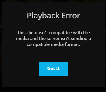

Hi! Having a transcoding problem as well, not sure where the issue lies so dumping all the info I have here and hoping it's enough for some help!
I have an Intel iGPU that I pass through to my container, have updated the Unraid go file to persist its access and permissions, and set Jellyfin with Intel Quick Sync under Hardware Acceleration. Details for that was following this guide:
Here's what happens when I try to play a video..
On the browser side, the video seems to flicker between different aspect ratios and then shows:
'Playback Error This client isn't compatible with the media and the server isn't sending a compatible media format'
with a 'Got It' button which starts the aspect ratio changing over for a few seconds before it shows the message again in a loop.
1012617578_ScreenShot2020-09-22at3_53_28PM.png.9ea361cc7926b73570b17b56416ccb84.png -> Direct Play ->  Playback Error
Looking at the Admin Dashboard, the appropriate device shows initially as 'Transcoding - 8.2 Mbps ts h264 mp3' briefly, then it says 'Direct playing'. I think this change happens at the same rate as the aspect ratio changes above, because it stays at 'Direct playing' until I hit 'Got It' on the screen and then it goes back to briefly showing transcoding -> direct playing -> transcoding..etc.
From the Docker log, it appears that it tries to find a transcode for the file, doesn't see one, and then fails to actually transcode? It know it should transcode, hence the VideoCodecNotSupported flag. When I turn off hardware acceleration, this same video shows 'Transcoding (8.2 fps) - 7.5 Mbps ts h264 mp3' and it does play, but it's pretty stuttery unless I let it sit for a while & don't skip around - hence the attempt to get my GPU to assist here. The only difference in the status is the actual frames per second.

Try setting Hardware Acceleration to "VAAPI" instead of "Intel Quick Sync".
WOW! I can't believe that's all I needed to change.
Thank you, Intel-Gpu-Tools now does show that the GPU is being engaged and the transcoding actually starts now.
Yep, it's super unintuitive. You can also see if transcoding is working by going into your Admin Dashboard. Any streams will show up there, along with transcoding info, if any.
Right, that's where I was earlier and was confused by the transcoding -> direct -> transcoding continual error loop I was seeing.

On 9/19/2020 at 8:42 PM, aurevo said:
Hello,
  • I also read in a few Github Issues about problems with OMDB or connection via IPv6.
  • I also tried to disable OMDB on all libraries. No change.
  • IPv6 is disabled on the whole Unraid server.
  • Also tried to add folowing to the docker extra parameters: “–add-host omdbapi.com:104.20.134.15 --add-host www.omdbapi.com:104.20.134.15 --add-host img.omdbapi.com:104.20.134.15 --add-host themoviedb.org:13.249.71.53 --add-host www.themoviedb.org:13.249.71.53 --add-host api.themoviedb.org:13.225.53.99”
  • Tried to reboot docker and host system.
It is sobering to see that I cannot find a solution to this problem.

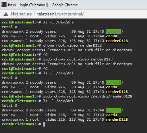

/dev/dri shows up inside the docker:
root@095b9610a70f:/# ls -la /dev/dri
total 0
drwxr-xr-x 2 root root                80 Nov  3 20:35 .
drwxr-xr-x 6 root root               360 Nov  3 20:35 ..
crw-rw---- 1 root videoEhAShCrc 226,   0 Nov  3 20:35 card0
crwxrwxrwx 1 abc  users         226, 128 Nov  3 20:35 renderD128
However, when running hw transcode:

I am having issues with "Scan Media Library failed"
The error is as follows
Could not find a part of the path '/config/root/default/Movies'. at System.IO.Enumeration.FileSystemEnumerator`1.CreateDirectoryHandle(String path, Boolean ignoreNotFound) at System.IO.Enumeration.FileSystemEnumerator`1.Init() at System.IO.Enumeration.FileSystemEnumerable`1..ctor(String directory, FindTransform transform, EnumerationOptions options, Boolean isNormalized) at System.IO.Enumeration.FileSystemEnumerableFactory.DirectoryInfos(String directory, String expression, EnumerationOptions options, Boolean isNormalized) at System.IO.DirectoryInfo.InternalEnumerateInfos(String path, String searchPattern, SearchTarget searchTarget, EnumerationOptions options) at System.IO.DirectoryInfo.EnumerateDirectories(String searchPattern, SearchOption searchOption) at Emby.Server.Implementations.IO.ManagedFileSystem.GetFileSystemEntries(String path, Boolean recursive) at MediaBrowser.Controller.Providers.DirectoryService.GetFileSystemEntries(String path) at MediaBrowser.Controller.IO.FileData.GetFilteredFileSystemEntries(IDirectoryService directoryService, String path, IFileSystem fileSystem, IServerApplicationHost appHost, ILogger logger, ItemResolveArgs args, Int32 flattenFolderDepth, Boolean resolveShortcuts) at MediaBrowser.Controller.Entities.CollectionFolder.CreateResolveArgs(IDirectoryService directoryService, Boolean setPhysicalLocations) at MediaBrowser.Controller.Entities.CollectionFolder.RequiresRefresh() at MediaBrowser.Providers.Manager.MetadataService`2.RefreshMetadata(BaseItem item, MetadataRefreshOptions refreshOptions, CancellationToken cancellationToken) at MediaBrowser.Controller.Entities.BaseItem.RefreshMetadata(MetadataRefreshOptions options, CancellationToken cancellationToken) at MediaBrowser.Controller.Entities.Folder.RefreshChildMetadata(BaseItem child, MetadataRefreshOptions refreshOptions, Boolean recursive, IProgress`1 progress, CancellationToken cancellationToken) at MediaBrowser.Controller.Entities.Folder.RefreshMetadataRecursive(List`1 children, MetadataRefreshOptions refreshOptions, Boolean recursive, IProgress`1 progress, CancellationToken cancellationToken) at MediaBrowser.Controller.Entities.Folder.ValidateChildrenInternal2(IProgress`1 progress, CancellationToken cancellationToken, Boolean recursive, Boolean refreshChildMetadata, MetadataRefreshOptions refreshOptions, IDirectoryService directoryService) at MediaBrowser.Controller.Entities.Folder.ValidateChildrenInternal(IProgress`1 progress, CancellationToken cancellationToken, Boolean recursive, Boolean refreshChildMetadata, MetadataRefreshOptions refreshOptions, IDirectoryService directoryService) at MediaBrowser.Controller.Entities.UserRootFolder.ValidateChildrenInternal(IProgress`1 progress, CancellationToken cancellationToken, Boolean recursive, Boolean refreshChildMetadata, MetadataRefreshOptions refreshOptions, IDirectoryService directoryService) at Emby.Server.Implementations.Library.LibraryManager.ValidateTopLibraryFolders(CancellationToken cancellationToken) at Emby.Server.Implementations.Library.LibraryManager.PerformLibraryValidation(IProgress`1 progress, CancellationToken cancellationToken) at Emby.Server.Implementations.Library.LibraryManager.ValidateMediaLibraryInternal(IProgress`1 progress, CancellationToken cancellationToken) at Emby.Server.Implementations.ScheduledTasks.ScheduledTaskWorker.ExecuteInternal(TaskOptions options)
