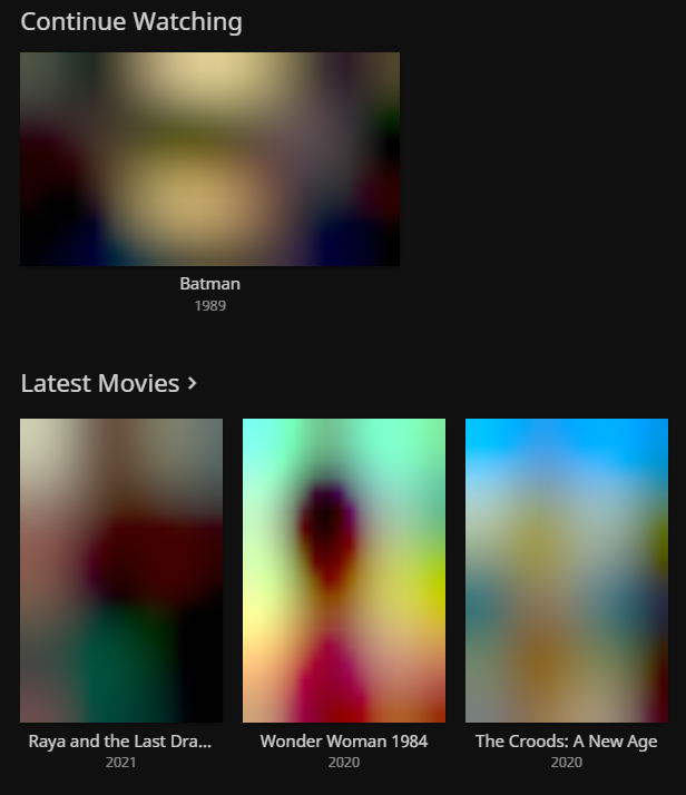

Turns out I was using the Jellyfin/jellyfin official template which was not updated for some reason.  I have now switched after having to do a clean install.
It was working but once I added the collections plugin, it broke.  The main page just loads and loads.  I was reading on the git for this and I think its a permission issue perhaps?  I cant see any of the metadata if I click the metadata tab.
I'm gonna switch back to somebody elses docker cause Until this is fixed

Yes I have a similar issue. Web frontend won't load. There is an issue with the config.json in the container it seems.
What's the easiest way to roll back the container to pull the previous container?
I used 10.6.4-1: https://hub.docker.com/r/linuxserver/jellyfin/tags?page=1&ordering=last_updated&name=10.6.4
Copy "linuxserver/jellyfin:version-10.6.4-1" into container repository and install
https://www.reddit.com/r/unRAID/comments/8i1j2t/how_do_i_downgrade_a_docker/

I had an issue with my cache where somehow my data folder became cache only long story short Docker failed had days of trying to figure out was wrong and why my cache drive would not move after days and days of reading I found the mistake by then I had deleted my docker and had o do a full reinstall of all my apps they are now all working except Jellyfin.
At first it wold not even load the admin page after reading here I saw some people had issues with that an they downgraded the docker I did the same I used 10.6.4-1: https://hub.docker.com/r/linuxserver/jellyfin/tags?page=1&ordering=last_updated&name=10.6.4
Now it loads the "Tell us about yourself" page but after putting in the information and clicking "Next" it just opens up a circle that never stops spinning and wont go to next page.
Please help this is the one reason we have a server. below is my server log if it helps.
