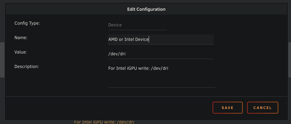

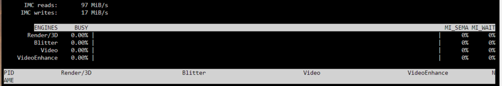

But how should I do that? What should I write where? Screenshot2024-05-06170757.png.3a3c60c7523b874ed62722db1c6bf778.png

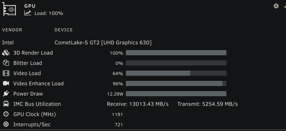

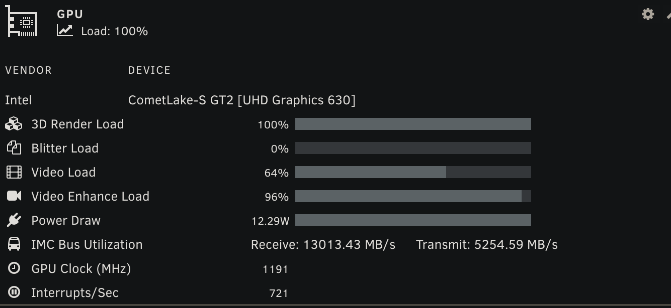

For me transcoding is working with an intel iGPU using the method I mentioned with the Hotio Jellyfin container.
What intel CPU gen are you using?
I have an i5 8400, aka 8th generation intel using the LGA 1151 socket
Should be supported on Unraid.
You can try to install the Hotio Jellyfin container and see if that works.
As you can see, transcoding works for me.Screenshot2024-05-06at20_24_42.thumb.png.853da3a84c2dc279291b4b23bcb4c2f4.png

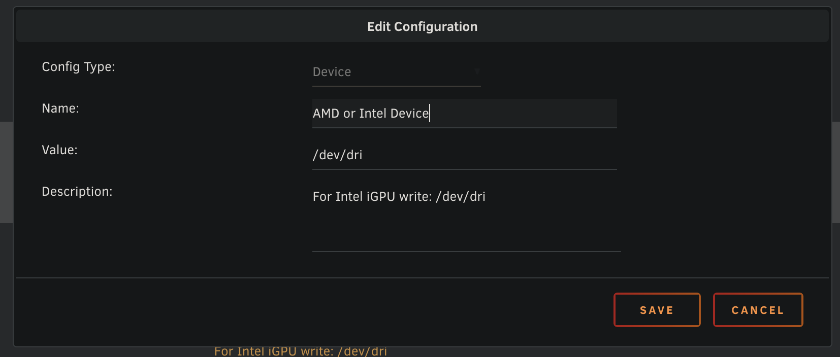

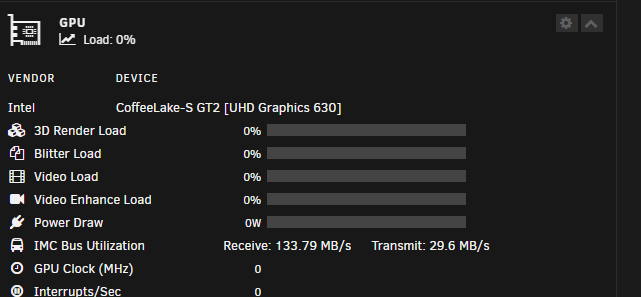

I'd rather keep using the linuxserver image cause i've setup jellyseerr and the other arr apps how they should be according to trash guides and everything else is working perfectly right now except subtitles. Is there nothing else I can do? I have the "Intel_GPU_TOP" plugin and "GPU Statistics" plugin installed and tried putting --device=/dev/dri in "Extra Parameters" with no success

One small point from a newbie, so take it for what it’s worth. Make sure to add the double dash “- -“ (no spaces or quotes) before the statement under ‘extra parameters’ I don’t see the dashes in your screenshot.
Add --device=/dev/dri to Docker container's Extra Parameters.
Hope this helps.
Edited by marlin
Clarification
Hope this helps.
I did put two - before the command, it’s just a bit weirdly formatted so if you look after the word “putting“, that’s where the command started

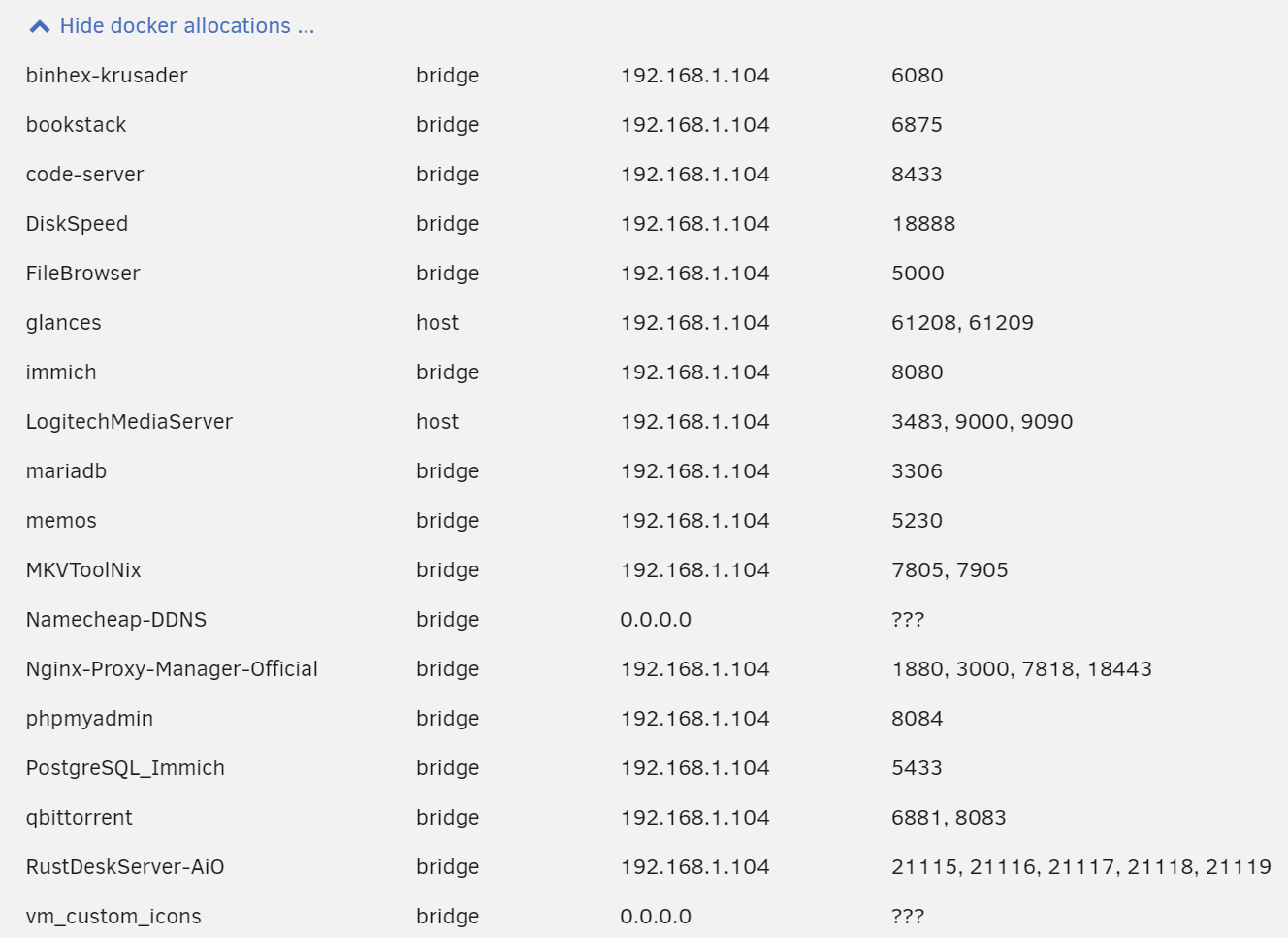

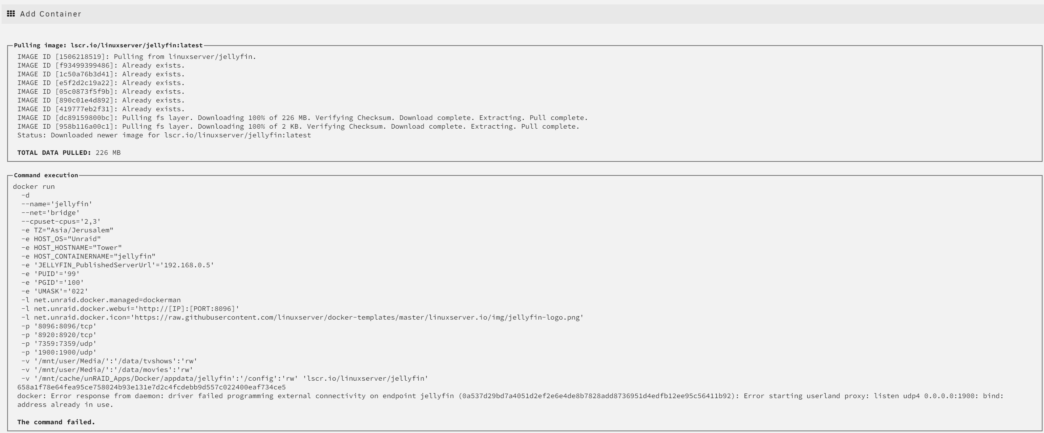

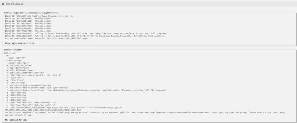

I need help
I had jellyfin up and running for the last souple of years without issues.
Today I updated to Jellyfin 10.9 and something happened (maybe during the update) but my docker fails to run (runs and the stops) with "address in use" in docker log.
So I removed/deleted the docker, restarted the server (power cycle) and tried to reinstall the docker but no get error during install.
Here is the result of the docker install
The existing allocatted docker ports are below - see no Jellyfin (as it is not installed yet)
What is the problem?

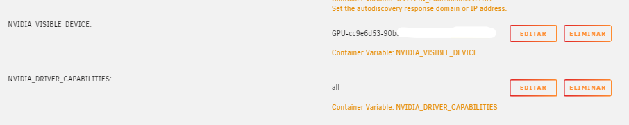

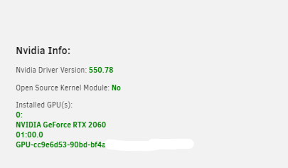

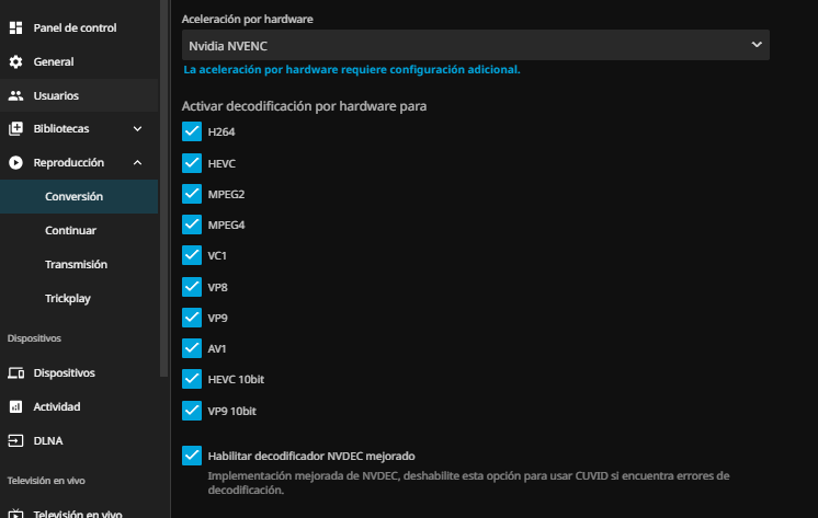

Hi guys i configured NVDIA GPU and dont work... Show photos.
Help me pleas
