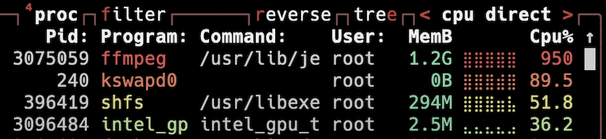

In case anyone fails to scan his library and or crashes the whole unraid server .. what a mess... i found the issue.
I installed jellyfin - and it does not matter which container, bbergle or linuxserver or whatever , all behaved same. My movie collection is around 1k 4k movies and a few hundred lower resolution. Each time i scanned my movie folder, my unraid server became unresponsive and even root login was no more possible, after typing in user in console it did not even promp for password (timed out). I tried local as well via KVM, same.
So i did memtest, all stuff, my hardware is fine. Next step was going by single folders instead all at once - worked better but still freezing sometimes and needed hard reset, awful. After a while i found out that it may caused be out of memory as once unraid freezed with 100% mem usage. So i added a swapfile but did not help.
Next step was to limit the memory of the container --memory=12G and then by surprise, it uses the swap file on top. so i set a swap file to 32G just to test .. after 20 minutes of scan it used up the container 12G + 32G swap ... but it did not immediately crash (it crashed after 20 minutes utilizing all swap). So i had time to dig into the container and found ~300 ffprobe processes ... like endless processes to scan media in parallel. I am sure spinning disks like that a lot ... what a shit.
So i stumbled over the (default) parameter  JELLYFIN_FFmpeg__analyzeduration=200M which is like how many frames per movies are analyzed for aspect ratio, codecs etc .... So i reduced this a lot setting a new environment variable to 3M instead 200M -> voila, scan rushed through but failed on many codeds. Then increased to 10M .. again, it used 12GB container mem and 10GB swap ... what a horrible setup.
Next step was a hint in the jellyfin forum, to limit the "Parallel library scan tasks limit" - seems they introduced this in jellyfin 10.9 and thd default is "" (maybe endless ... killing all disk based storage systems). Prevous to 10.9 it was like 1 scan parallel and it just took a while but it worked. so i set this now to 4 and check what happens ... it looks promising.
I filed an issue on github to change the default parameter of parallel scans..  or many many spinning disk setups will fail with full lib scans https://github.com/jellyfin/jellyfin/issues/12203
*edit* default parallel scans is the logical core count .. in my case 20 ... no wonder it crashes

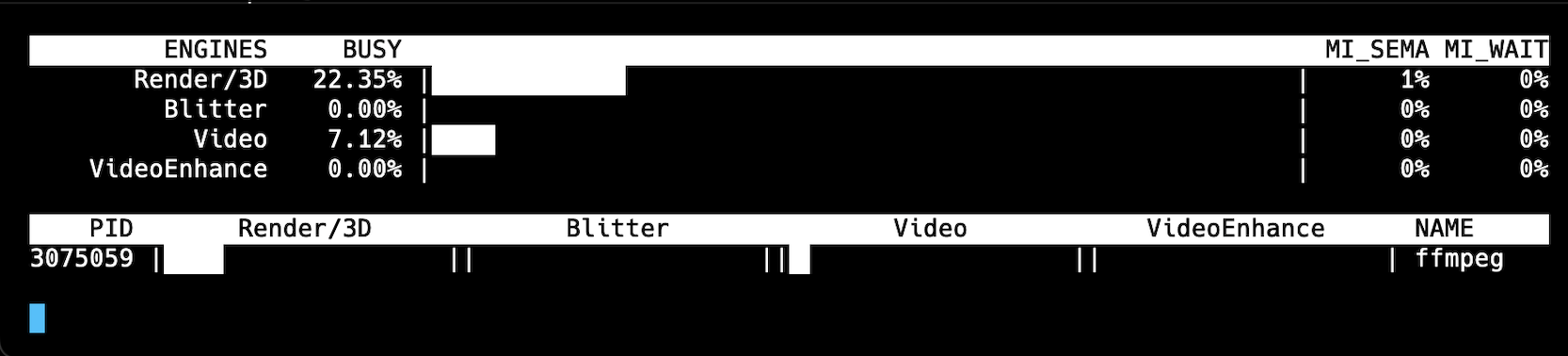

Im using the latest linuxserver/jellyfin docker image and I have passed --device=/dev/dri in the Extra Parameters field. I have verified that the devices are mounted to the container.
With the default settings, video playback works but it is using software transcoding (I can see the cpu usage in the Unraid dashboard).
In the Jellyfin webui under Dashboard > Playback, I set hardware acceleration to "Video Acceleration API (VAAPI)" and set VA API Device to "/dev/dri/renderD128"
Made sure these were the case and tried a video file at a lower resolution and bitrate from original over a mobile connection and it appears to work as intended...

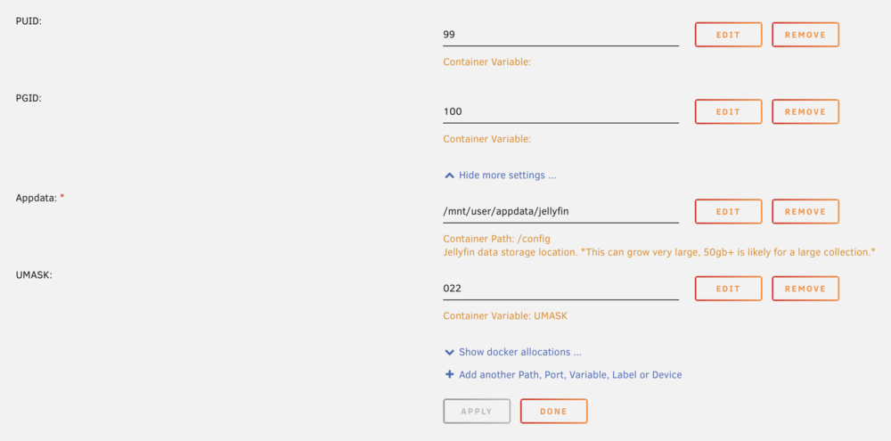

Hi, I had to reboot my unraid server the other day due to the webui bug, and now jellyfin will not start. It is stuck in a loop.
[11:42:07] [INF] [1] Jellyfin.Networking.Manager.NetworkManager: Remote IP filter is Allowlist
[11:42:07] [INF] [1] Jellyfin.Networking.Manager.NetworkManager: Filtered subnets: []
[11:42:21] [FTL] [1] Main: Error while starting server
Microsoft.Data.Sqlite.SqliteException (0x80004005): SQLite Error 11: 'database disk image is malformed'.
   at Microsoft.Data.Sqlite.SqliteException.ThrowExceptionForRC(Int32 rc, sqlite3 db)
   at Microsoft.Data.Sqlite.SqliteDataReader.NextResult()
   at Microsoft.Data.Sqlite.SqliteCommand.ExecuteReader(CommandBehavior behavior)
   at Microsoft.Data.Sqlite.SqliteCommand.ExecuteReader()
   at Microsoft.Data.Sqlite.SqliteCommand.ExecuteNonQuery()
   at Emby.Server.Implementations.Data.SqliteExtensions.Execute(SqliteConnection sqliteConnection, String commandText)
   at Emby.Server.Implementations.Data.ManagedConnection.Execute(String commandText)
   at Emby.Server.Implementations.Data.BaseSqliteRepository.Initialize()
   at Emby.Server.Implementations.Data.SqliteItemRepository.Initialize()
   at Emby.Server.Implementations.ApplicationHost.InitializeServices()
   at Jellyfin.Server.Program.StartServer(IServerApplicationPaths appPaths, StartupOptions options, IConfiguration startupConfig)
[11:42:21] [INF] [1] Main: Running query planner optimizations in the database... This might take a while
[11:42:21] [INF] [1] Emby.Server.Implementations.ApplicationHost: Disposing CoreAppHost
[11:42:21] [INF] [1] Emby.Server.Implementations.ApplicationHost: Disposing PluginManager
{restarts}
is there a way to repair/recover the database?
EDIT: I believe I got it working again, mostly, although I lost my watch history.... Here is the process I followed:
  1. shut down jellyfin
  2. open unraid console and navigate to jf data directory and run....
root@LaForge:~# cd /mnt/user/appdata/docker/jellyfin/data/data
root@LaForge:/mnt/user/appdata/docker/jellyfin/data/data# sqlite3 library.db .dump > recovered_data.sql
root@LaForge:/mnt/user/appdata/docker/jellyfin/data/data# mv library.db library.db.corrupt
root@LaForge:/mnt/user/appdata/docker/jellyfin/data/data# sqlite3 recovered.db < recovered_data.sql
root@LaForge:/mnt/user/appdata/docker/jellyfin/data/data# sqlite3 recovered.db "PRAGMA integrity_check;"
ok
root@LaForge:/mnt/user/appdata/docker/jellyfin/data/data# mv recovered.db library.db
root@LaForge:/mnt/user/appdata/docker/jellyfin/data/data# chown 99:100 library.db
root@LaForge:/mnt/user/appdata/docker/jellyfin/data/data# chmod 644 library.db
    3. re-launch jellyfin and wait forever for it to load and then revalidate the library
Hope this helps someone else encountering the same issue...

I got quite a lot of permission errors in the log. I don't know when it started, but my guess would be, since the upgrade to 10.9.x. Currently running 10.9.7. Here are two examples of my log file.
[2024-07-28 03:35:12.132 +02:00] [ERR] [58] Jellyfin.Server.Implementations.Trickplay.TrickplayManager: Error creating trickplay images.
System.UnauthorizedAccessException: Access to the path '/config/data/metadata/library/24/24fd5b5915f04733f1f69b84a6cdc46f/trickplay' is denied.
[2024-07-28 09:23:47.633 +02:00] [ERR] [34] MediaBrowser.Providers.Genres.GenreMetadataService: Error in "Dynamic Image Provider"
System.UnauthorizedAccessException: Access to the path '/config/data/metadata/library/3d/3d621c0b6dc1921bc93fa859f7512270/poster.png' is denied.
any ideas or solutions I could try?
thanks

I've a Intel 13500T and Jellyfin is running with option `--device=/dev/dri` (no external GPU)
My iGPU is used, but only with 25% load... at the same time, my CPU has a load >900%
Is this how it should be?

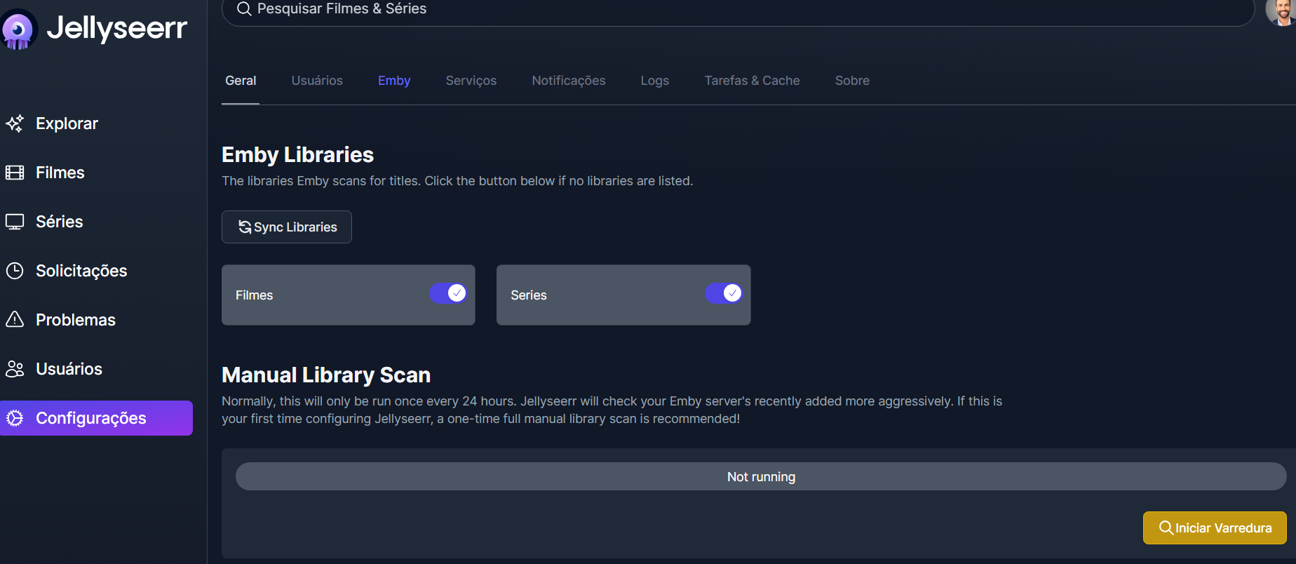

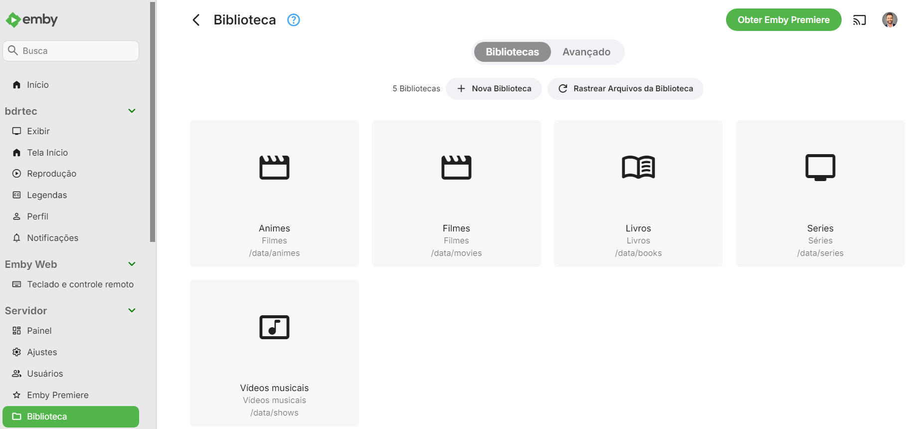

JellySeerr connects to the Emby folders. I don't understand why, since both Emby and Jellyfin download in the same folder.
But JellySeerr can't find all the Emby folders, even when I click on sync automatically. Synchronizing manua1lly didn't work.
Haven't worked with *seerr apps myself (and, by the way, we're off topic here) but are you sure you need Jellyseer? Its purpose is to allow others (family members, friends...) to request media. If you're the sole user, you don't need it, you use Sonarr or Radarr directly.
