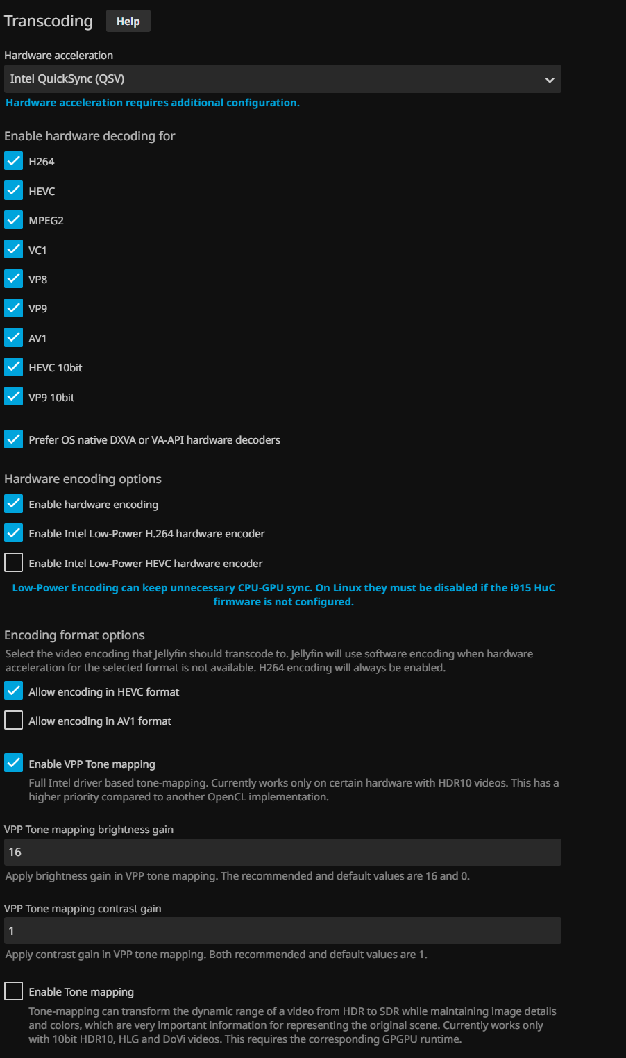

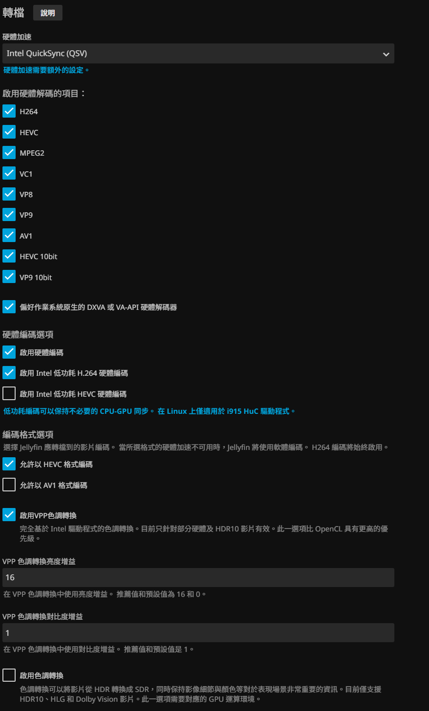

  5. My CPU : 11900T UHD750 ,Docker: linuxserver Jellyfin I can't enable intel low-power hevc hardware encoder... but when I disable intel low-power hevc, My transcode work fine. I don't know why .....

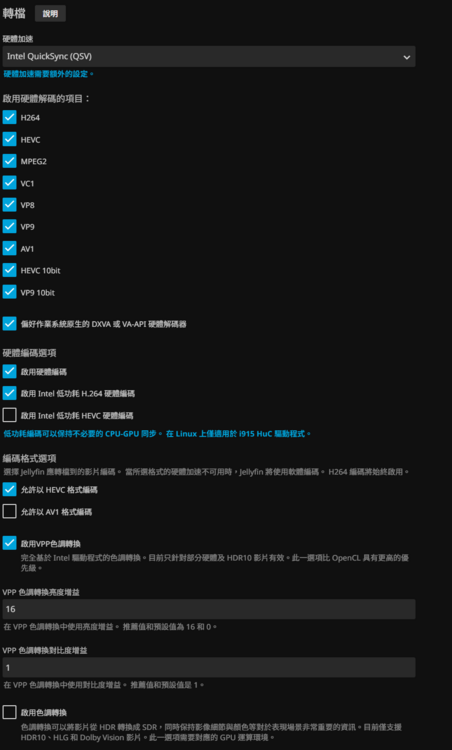

  6. I have a issue, My CPU 11900T UHD750 I can enable low-power H.264, But I can't enable low-power HEVC ..... Below setting work fine, but when I enable low-power HEVC, and play movie will be crash
  7. OK, I keep this config, tks for yoyr reply, best regard
