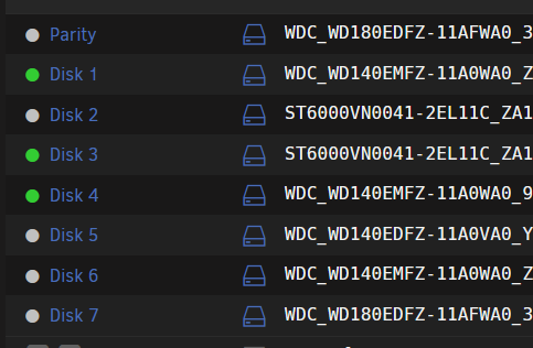

April 19, 20215 yr After my my Western Digital WD180EDFZ disks did not spindown (while usual WD Ultrastar disks work flawlessly) I wrote this script to obtain the different power modes (which aren't checked by Unraid) and I found out that some disks are randomly lying (!) like returning "STANDBY" while they are spinning! What the script does: It checks if the icon in the Unraid WebGUI has the correct color (active / standby) and corrects it if necessary It checks the spin down state of Disks that claim to be in STANDBY Note: This is done by repeating Unraid's spin down command. Regarding my measurements, this re-execution lowers the power consumption even more. I think because the SATA ports itself were not in standby after the first spindown command. Option: Spindown disks that are in the advanced idle modes "IDLE_B" and "IDLE_C" Note: Some disks aren't spinning although they return these states. It optionally sets the spindown timer of the disk's firmware Note: Its set and removed every 32 minutes if the disk stays active. This trick helps as some disks ignore the first try. Donate? 🤗 Manual: - This script should be executed by the "CA User Scripts" plugin which can be installed through "Apps" - Use the custom cron schedulde */15 * * * * to execute it every 15 minutes - Check the "Settings" inside the script #!/bin/bash # ##################################### # Script: Advanced disk spindown v0.4 # Description: Monitors disks power modes, spins down disks and corrects # Unraid's WebGUI icon if necessary. # Author: Marc Gutt # # Changelog: # 0.4 # - complete rewrite # - icon is now only corrected if necessary # - measure execution time of spin up command as well # - reading bytes through dd is replaced by Unraid's spinup command # # ######### Settings ################## # set to "1" to enable spinning down disk if power mode is IDLE_A idle_b_spindown=1 # set to "1" to enable spinning down disk if power mode is IDLE_B idle_c_spindown=1 # set to "1" to enable spindown timer through "smartctl -s standby,241 /dev/sdb". "241" means 30 minutes advanced_spindown=0 # ##################################### # # ######### Script #################### # make script race condition safe if [[ -d "/tmp/${0///}" ]] || ! mkdir "/tmp/${0///}"; then exit 1; fi; trap 'rmdir "/tmp/${0///}"' EXIT; # loop through devices for devpath in /dev/sd?; do runtime="" # obtain disk id and name devname=${devpath: -3} diskid=$(grep -oP "(?<=rdevName\.)[0-9]+(?==${devname})" /proc/mdstat) # skip non-array disks if [[ -z $diskid ]]; then continue fi diskname=$(grep -zoP "(?<=name=\")[a-z0-9]+(?=\"\ndevice=\"${devname})" /var/local/emhttp/disks.ini | tr -d '\0') if [[ -z $diskname ]]; then echo "Diskname of Disk ${diskid} (${devname}) not found!" continue fi # obtain power mode devinfo=$(smartctl -n standby -i $devpath) modes=( IDLE_A IDLE_B IDLE_C STANDBY ACTIVE UNKNOWN ) for mode in "${modes[@]}"; do if [[ $devinfo == *"${mode}"* ]]; then break fi done # obtain WebGUI icon icon=$(sed -e "/device=\"${devname}\"/,/fsStatus/!d" /var/local/emhttp/disks.ini) if [[ $icon == *"green-blink"* ]]; then icon="STANDBY" elif [[ $icon == *"green-on"* ]]; then icon="ACTIVE" else icon="UNKNOWN" fi echo -n "${diskname} (${devname}), ${mode} mode, ${icon} icon" general_mode="STANDBY" if [[ ${mode} == *"IDLE_"* ]] || [[ ${mode} == "ACTIVE" ]]; then general_mode="ACTIVE" fi # icon correction if [[ ${general_mode} != ${icon} ]]; then echo -n " (wrong)" # update icon if [[ $general_mode == "ACTIVE" ]]; then start=$(date +%s) /usr/local/sbin/emcmd cmdSpinup=${diskname} end=$(date +%s) runtime=$((end-start)) # as the disk is active it should already spin if [[ $runtime -gt 1 ]]; then echo -n ", Warning: Unexpected spin up while icon correction!" fi else start=$(date +%s) /usr/local/sbin/emcmd cmdSpindown=${diskname} end=$(date +%s) runtime=$((end-start)) # as the disk is in standby mode it should already stand still if [[ $runtime -gt 1 ]]; then echo -n ", Warning: Unexpected spin down while icon correction!" fi fi echo -n ", Icon has been corrected." else echo -n " (correct)" fi # spin down disk although it is already in STANDBY mode as some disks are lying regarding their spinning state if [[ $mode == "STANDBY" ]] && [[ -z $runtime ]]; then # runtime is only empty if icon correction wasn't necessary echo -n ", Check spin down state" start=$(date +%s) /usr/local/sbin/emcmd cmdSpindown=${diskname} end=$(date +%s) runtime=$((end-start)) # as the disk is in standby mode it should already stand still if [[ $runtime -gt 1 ]]; then echo -n ", Warning: Disk unexpectedly spun down!" else echo -n ", Good: Disk already stands still." fi fi # spin down disks that are in advanced idle modes if [[ $mode == "IDLE_B" ]] && [[ $idle_b_spindown == "1" ]] || [[ $mode == "IDLE_C" ]] && [[ $idle_c_spindown == "1" ]]; then # runtime is only empty if icon correction wasn't necessary echo -n ", Check spin down state" start=$(date +%s) /usr/local/sbin/emcmd cmdSpindown=${diskname} end=$(date +%s) runtime=$((end-start)) # as the disk is in standby mode it should already stand still if [[ $runtime -gt 1 ]]; then echo -n ", Good: Spin down was successful!" else echo -n ", Warning: Unexpected stagnant disk, sent to STANDBY!" fi fi # set spindown timer (some disks need it) last_spindown="/tmp/ForceSpindown${diskid}.last" if [[ $advanced_spindown == "1" ]]; then if [[ $mode == "IDLE_A" ]]; then # Remove spindown timeout (some disks react only on the second try) if [[ -f ${last_spindown} ]]; then time_last=$(stat -c %Y ${last_spindown}) time_expired=$((time_last+1920)) # 1920 = 32 minutes time_now=$(date +%s) if [[ $time_expired -lt $time_now ]]; then echo -n ", removed spindown timer" smartctl -n standby -q errorsonly -s standby,off $devpath rm ${last_spindown} fi # Set spindown timeout else echo -n ", set spindown timer" smartctl -n standby -q errorsonly -s standby,241 $devpath # 241 = 30 minutes touch ${last_spindown} fi fi # remove spindown timer elif [[ -f ${last_spindown} ]]; then last_spindown="/tmp/ForceSpindown${diskid}.last" smartctl -q errorsonly -s standby,off $devpath rm ${last_spindown} echo -n ", removed spindown timer" fi echo "" done Execute this to manually spin down all disks: for dev in /dev/sd?; do /usr/local/sbin/emcmd cmdSpindown="$(grep -zoP "(?<=name=\")[a-z0-9]+(?=\"\ndevice=\"${dev: -3})" /var/local/emhttp/disks.ini | tr -d '\0')"; done
April 19, 20215 yr Author Example log output: Script Starting Apr 20, 2021 00:30.01 Full logs for this script are available at /tmp/user.scripts/tmpScripts/forcespindown/log.txt Spin down Disk 4 although it is already in STANDBY state to force icon change in Unraid WebGUI... has been spun down. Error: As the Disk already was in STANDBY state, this should not happen! Spin down Disk 6 although it is already in STANDBY state to force icon change in Unraid WebGUI... was already spun down. Spin down Disk 3 although it is already in STANDBY state to force icon change in Unraid WebGUI... was already spun down. Spin down Disk 10 although it is already in STANDBY state to force icon change in Unraid WebGUI... was already spun down. Spin down Disk 1 although it is already in STANDBY state to force icon change in Unraid WebGUI... was already spun down. Spin down Disk 0 although it is already in STANDBY state to force icon change in Unraid WebGUI... was already spun down. Skip Disk 8 as it is in ACTIVE state, but we read some bytes to force icon change in Unraid WebGUI. Spin down Disk 2 although it is already in STANDBY state to force icon change in Unraid WebGUI... was already spun down. Script Finished Apr 20, 2021 00:30.08

June 4, 20215 yr Author I checked my logs since yesterday and I'm shocked how often some disks are spinning altough they return a STANDBY state: ######################################################################## Script Starting Jun 03, 2021 17:15.01 Spin down Disk 2 although it is in STANDBY state. Forces WebGUI icon change... has been spun down (Should not happen!) ######################################################################## Script Starting Jun 04, 2021 09:15.01 Spin down Disk 3 although it is in STANDBY state. Forces WebGUI icon change... has been spun down (Should not happen!) ######################################################################## Script Starting Jun 04, 2021 12:45.01 Spin down Disk 2 although it is in STANDBY state. Forces WebGUI icon change... has been spun down (Should not happen!) ######################################################################## Script Starting Jun 04, 2021 13:30.01 Spin down Disk 4 although it is in STANDBY state. Forces WebGUI icon change... has been spun down (Should not happen!) ######################################################################## Script Starting Jun 04, 2021 17:45.01 Spin down Disk 4 although it is in STANDBY state. Forces WebGUI icon change... has been spun down (Should not happen!) ######################################################################## Script Starting Jun 04, 2021 18:00.01 Spin down Disk 1 although it is in STANDBY state. Forces WebGUI icon change... has been spun down (Should not happen!) ########################################################################
June 5, 20215 yr Author Released v0.4 # - complete rewrite # - icon is now only corrected if necessary # - measure execution time of spin up command as well # - reading bytes through dd is replaced by Unraid's spinup command The log output is now different, too: Script Starting Jun 05, 2021 14:45.01 disk4 (sdc), STANDBY mode, STANDBY icon (correct), Check spin down state, Good: Disk already stands still. disk6 (sdd), IDLE_A mode, ACTIVE icon (correct) disk3 (sde), STANDBY mode, STANDBY icon (correct), Check spin down state, Good: Disk already stands still. disk10 (sdf), STANDBY mode, STANDBY icon (correct), Check spin down state, Good: Disk already stands still. disk1 (sdg), STANDBY mode, STANDBY icon (correct), Check spin down state, Good: Disk already stands still. parity (sdh), STANDBY mode, STANDBY icon (correct), Check spin down state, Good: Disk already stands still. disk8 (sdi), ACTIVE mode, ACTIVE icon (correct) disk2 (sdj), IDLE_A mode, ACTIVE icon (correct) Script Finished Jun 05, 2021 14:45.06 Script Starting Jun 05, 2021 15:00.01 disk4 (sdc), STANDBY mode, STANDBY icon (correct), Check spin down state, Good: Disk already stands still. disk6 (sdd), IDLE_A mode, ACTIVE icon (correct) disk3 (sde), STANDBY mode, STANDBY icon (correct), Check spin down state, Good: Disk already stands still. disk10 (sdf), STANDBY mode, STANDBY icon (correct), Check spin down state, Good: Disk already stands still. disk1 (sdg), STANDBY mode, STANDBY icon (correct), Check spin down state, Good: Disk already stands still. parity (sdh), STANDBY mode, STANDBY icon (correct), Check spin down state, Good: Disk already stands still. disk8 (sdi), ACTIVE mode, ACTIVE icon (correct) disk2 (sdj), IDLE_B mode, ACTIVE icon (correct), Check spin down state, Warning: Unexpected stagnant disk, sent to STANDBY! Script Finished Jun 05, 2021 15:00.07 As you can see disk2 claimed to be in IDLE_B mode, but the spindown command was executed in less than 1 second, which means the disk already wasn't spinning. Because of that the script finally send disk2 to STANDBY.
