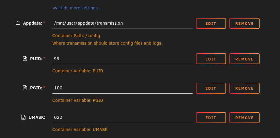

  7. Looks like we're not using the same container. Repository for mine is: lscr.io/linuxserver/transmission You can try "Add another Path, Port, Variable, Label or Device" Config Type: Variable Name: UMASK Key: UMASK Value: 000
  8. @comet424 Since I also since recently have issues with the transmission docker and the permissions it gives: What do you have under UMASK here in the container settings? That should be 000 (that equals 777 for folders, and 666 for files, or drwxrwxrwx / -rw-rw-rw- ), and the container variable SHOULD be the authority regarding the dockers umask, not the settings inside the applications settings file. Except it doesn't start at all when I set it to 000. So I'm curious if the same applies to you. (If you gonna try it, make a backup of the appdata-files first cp -r /mnt/user/appdata/transmission /mnt/user/appdata/transmission.bak , it broke my torrents after reverting back to 022, and had to restore that directory to restore the torrents (restore: mv -f /mnt/user/appdata/transmission.bak /mnt/user/appdata/transmission ) edit: Updated to latest transmission version now, and nothing broke when changing to 000. Either a bug in that last container version that was broken that's fixed in the latest, or just one unlucky try. I'd still do a backup before you change the umask setting though. A lot of work manually restoring until I remembered I had a backup. But remember to change it in the container settings above, not in /mnt/user/appdata/transmission/settings.json, it's authoritative and recursive to the app settings. While app settings is not recursive to container settings. BTW. I think the UMASK 022 (drwxr-xr-x / rw-r–r–) was changed with an update of the container, and was 000 before (transmission has always written files with drwxrwxrwx / -rw-rw-rw- for me until very recently), that would explain why you get another permission when you move. If you downloaded the file when container was at umask 000, and moved it when container had changed to umask 022.
  9. You only edited settings.json and not the UMASK variable in the container settings? Weird, changing settings.json did nothing for me. Can you check what UMASK is set under your transmission container settings (it's under "Show more settings")? edit: BTW, it didn't crash by changing container settings to 000 after I updated transmission to latest transmission version that came today or yesterday. So all good in the hood now!
  10. Transmission has been chaotic for me last couple of weeks. It went into orphan when adding new share, and I had to re-install it. After that everything creates with wrong permissions: Folders: drwxr-xr-x Files: -rw-r--r-- Changing umask in /mnt/user/appdata/transmission/settings.json didn't affect it. Found you can change umask in "Update Container". Changed it to 000, I stopped being able to connect to transmission. Changed it to 001. All torrents updated to same "added on" timestamp and and get stuck in status "Queued" and set the download directory to /root/download/ ...wft. It's all totally broken. By stuff like umask that shouldn't affect anything at all. edit: It also can't download anymore after correcting umask. It keeps downloading at full speed but doesn't write anything to disk, it seems to download and send it into nothingness. With umask 010. it starts to download again if I change back to umask 022. But...with the wrong permissions (the umask 022 permissions above where only server root can change the files)
