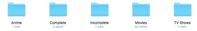

i migrated from needos docker.
1.
my current folders are capitalized for Complete & Incomplete.
now each time the docker starts a complete & incomplete folder is created lowercase.
downloads still go towards the capitalized directories but the lowercase are just there being duplicates and causing headaches on my mac
i tried editing the settings.json but changes doesnt seem to stick and issue still persists when restarted.

any changes made to the setting.json are not sticking on docker restart
in my case it keeps creating lowercase complete & incomplete even though Complete & Incomplete already exist

yes i have. ive also tried creating volume maps but regardless complete & incomplete folders keep getting created
The team should have told you this, but the init scripts inside the docker are hardwired to create the directories thats giving you hell. Best recourse is to move everything into the lower case directories and use those.
thats news to me. bummer :'(
can anyone from the team let me know if creating the directories can be avoided??
The obvious solution would be to just use lowercase.  Personally I try to avoid using uppercase on Linux for this very reason.  I'll take a look over the next couple of days.  But if we changed it to use uppercase then I'm sure we'll see complaints from others about wanting to use lowercase...
Having said that, until I've looked at it further I'm not entirely sure of the issue and the exact cause.  So I'll reserve judgement for now.
ken-ji is right, lowercase is hardcoded in and I'm struggling to think of a reason why it's a significant problem, but I'm happy to listen to arguments for and against...  ;)
its just the way ive always had things since unraid 4.7. and from plugins to needos dockers.
thw beginning of thie year i made the switch from needos dockers to linuxserver.io dockers
all went well except for transmission creating those lowercase folders and having to delete them
annoying at the most as long as i dont reboot the server or restart the docker lol
attached is how nice it looks on my explorer/finder :P
Honestly, I'll talk to Sparklyballs about this, but I'm not convinced we will change anything.
