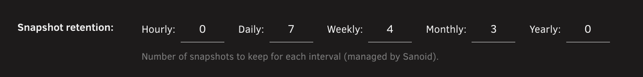

  3. Hi Pirat, I just installed the new version that adds hooks support. One question, is it possible to specify when snapshots run, like on a cron job? I see that the cronjob setting is available for backups, but can't find something like it for snapshots. I was hoping to add pre/post hooks to stop/start docker containers, but I prefer stopping them at like 4am when most people are asleep. Right now, I have this retention setting, which creates one snapshot per day at around 12 am.
