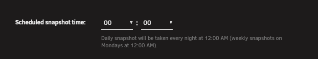

  4. This is a good point, especially useful to control the timing of when containers restart. I've added support for this in the next update that will go out very soon! You will be able to set the snapshot time per entry like this:
