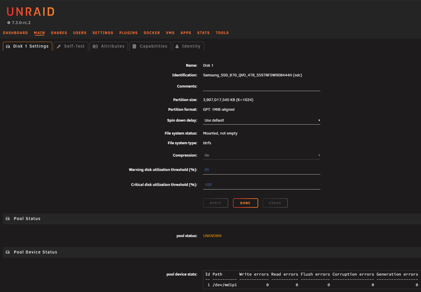

7.3.0-rc.1 & 7.3.0-rc.2 "Pool Status" observation. I have an all flash (SSD) Array (WITHOUT Parity) configured within 7.3.0-rc.2, when I view the status of any Array Device (e.g. "Disk 1") the status display shows "pool status: UNKNOWN" (see attached screen shot). Should 'Pool Status' & 'Pool Device Status' details be displayed for Array devices? Thanks.

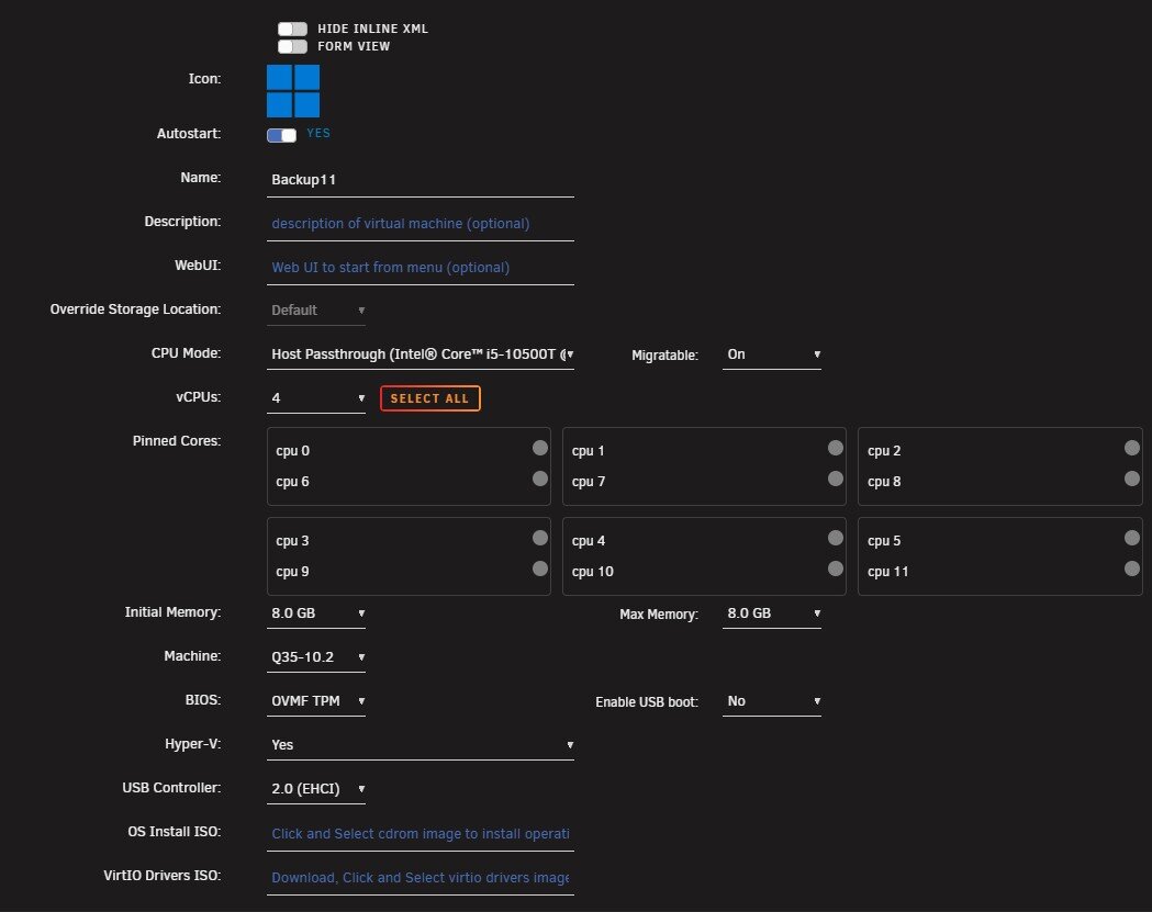

Hello, Was running 7.3.0-beta.2 (upgraded from a fresh 7.3.0-beta.1 installation), then upgraded to 7.3.0-rc.1. Unable to launch Windows 11 VM - displays the following error: "Execution error - unsupported configuration: Emulator '/usr/local/sbin/qemu' does not support machine type 'pc-q35-4.2'" Edited Windows 11 VM configuration - "Machine" type showing as "Q35-10.2" (see screenshot) but XML file showing value as: <type arch='x86_64' machine='pc-q35-4.2'>hvm</type> Clicked on "Update" (without making any changes) - VM then successfully started (XML file showed entry updated to <type arch='x86_64' machine='pc-q35-10.2'>hvm</type> ). Just thought I would highlight in case this is an issue or maybe just a blip that affected my installation.

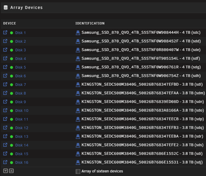

Hello, I am part way through building my next unRAID 'Media' Server where I plan to use only SSDs. I have a mixture of 960 GB, 2 TB, 3.84 TB and 4 TB SATA SSDs (the 960 GB and 3.84 TB SSDs are Enterprise SSDs) - 22 SSDs at present. With the prices of SSDs now being silly prices, I would like to maximise the amount of storage space available, minimise File System overhead whilst making things easy to manage. My original plan was to configure an unRAID SSD only Array WITHOUT parity disks (and no plans to ever add these) using BTRFS (with compression configured) for each disk. Then create a 'media' Share using the 'Fill-up' Allocation method. Utilising a Array allows each (SSD) disk to be individually 'spun up/spun down' (even with low power SSDs) and I can easily create an exact list of files and folders present on each disk that could be used to restore contents if a disk failed. I understand that an all SSD unRAID Array WITH Parity is unsupported as TRIM can invalidate Parity and that unRAID has disabled TRIM support on Array SSDs. I have attempted to manually run TRIM (e.g. fstrim -v /mnt/disk1) on an Array SSD and it returns "the discard operation is not supported". I can also see that other BTRFS based Pools/Disks have the discard=async enabled which enables "automatic" TRIM. Is it possible to: Manually run TRIM on an Array SSD(s)? Amend the default mount-ing process for the BTRFS-based Array SSDs so that they have discard=enabled on each Array SSD? Use an alternative approach (stop Array, manually mount each Array SSD run TRIM then dismount each Array SSD)? I know I can configure multiple Pools (using ZFS Stripes to maximise storage space) but would lose out on having a single Share for management plus would need to restore a whole (ZFS) Pool if a single disk failed. Another idea would be to use individual single disk Pools, create a 'media' Share and then manually create a 'media' top-level folder on each single-pool disk and let FUSE 'merge' these together. This is far from ideal as I would then need to manually manage filling up each disk (although 95%+ of the media files present are write once, read many). Suggestions and ideas welcome! Thanks.

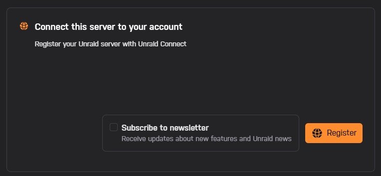

Self "fixed": Click on the "Unraid Connect" icon -> Sign In with Unraid.net Account Once logged into the "Manage Server" web page, click on the "Register your server for Unraid Connect" Then click on the "Register" button Job done!

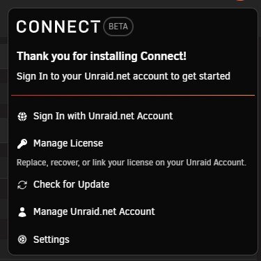

Hello, Is "Unraid Connect" supported with 7.3.0-beta2 ? I have just performed a clean installation of 7.3.0-beta1 (yesterday) and then upgraded to 7.3.0-beta2 today (without issue). I then installed "Unraid Connect" but the 'Unraid Connect' icon was not present in the top-right hand corner of the unRAID GUI. After rebooting the Server, the 'Unraid Connect' icon appeared as expected, I then attempted to configure and followed the prompts to 'Sign In with unraid.net Account' (see attached screen shot). After successfully logging in with my unraid.net account, "Unraid Connect" still presents the same prompts and does not display the 'new' Server within my Unraid Connect Dashboard (my existing/registered Servers are displayed). Are there additional steps I need to follow to register my 'new' Server with Unraid Connect? Thanks.
