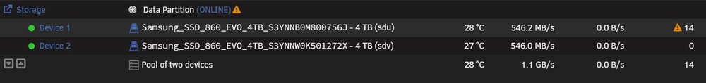

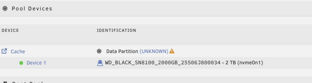

What is this supposed to mean? Its the cache pool status, but why is it unknown?
Went from 7.2.6 to 7.3.0. Everything is working as expected except this. I see no errors when I click on the pool and it is operating fine. What does this mean? I'm running a scrub to see if that shows any errors.
It is a RAID0 pool BTRFS
