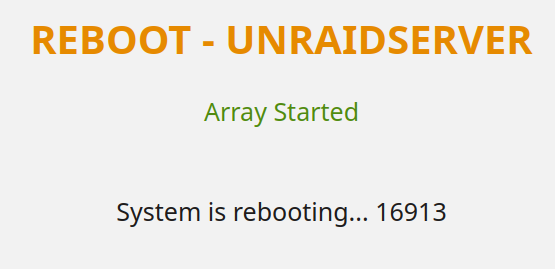

Upgraded from 7.2.4 to 7.3.0 and my server never came back online after the reboot. The screenshot (below) says Array Started, so I'm not sure if that means it successfully rebooted and then died, or died prior/during the reboot.
Regardless, the system was stable with an uptime of almost 2 months prior to the upgrade. It now has no video and does not POST. Power Supply tested good. Re-seated all components. Ordered a new motherboard to try tomorrow and determine if that or something else failed.
CPU: AMD Ryzen 5 5600G
MB: MSI B450M PRO-VDH MAX
Edited by Goatskin

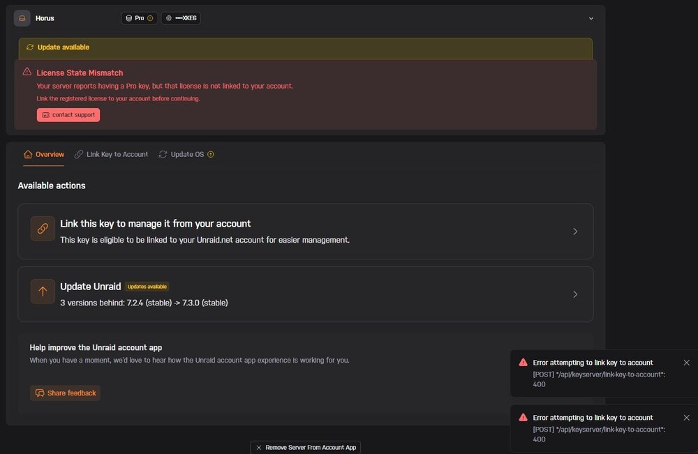

Can someone explain, what this means?
Edited by Zonediver
Don't take my word for it, but I think it just means that you haven't linked your key to your account yet. You can link your key(s) to your unraid account so that if you ever need to retrieve them, you can just download them. E.g, If your local/backup key gets lost.
But then again, the wording and the big read banner suggest it's mandatory for some operations now?
Edit: Sorry, I didn't see your previous post with the errors.
Edited by strike

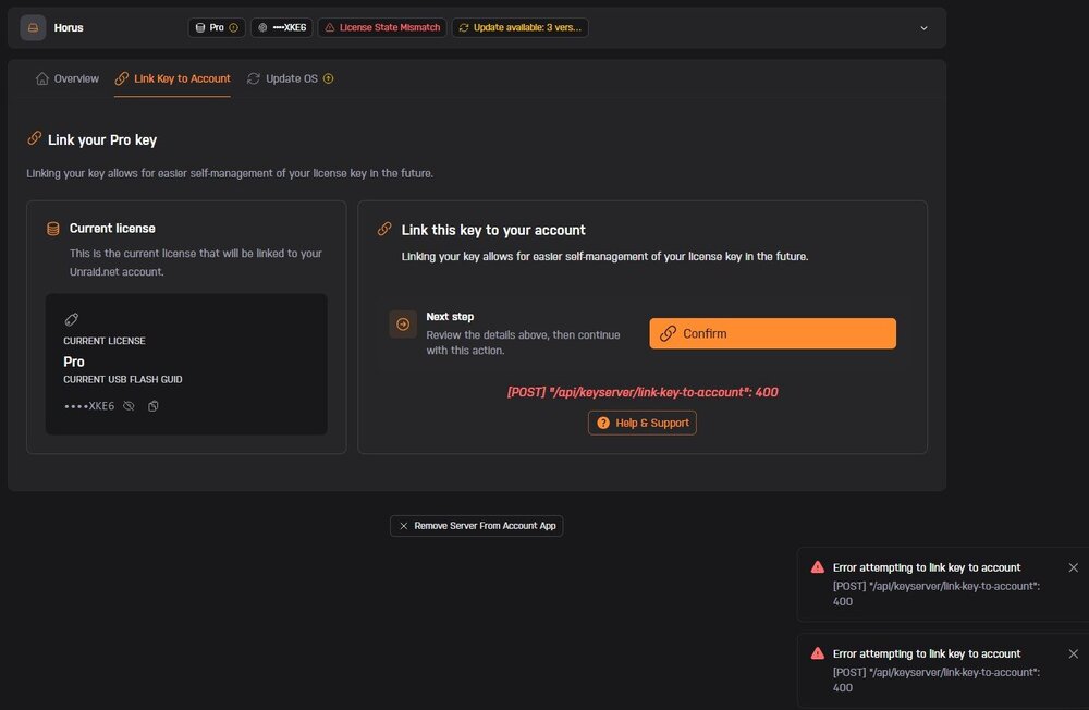

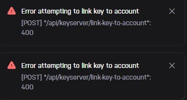

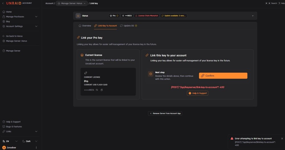

2 minutes ago, trurl said:
Login to unraid.net and try again.
Well...
I tried it several times and got this...
Edited by Zonediver
