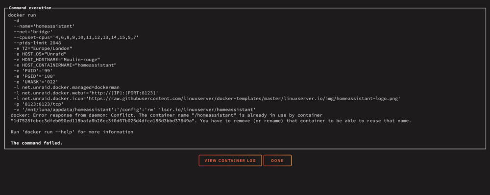

Updated fine but somethings happened to homeassistant container. It's still there but not able to run it & won't let me re-add it.
How can I get it back working easily?
Screenshot is what happens if I click add container & choose homeassistant template.
Appdata folder is all still there...
Open Terminal --> docker rm -f homeassistant
Next, select "Add Container" — use the Home Assistant template.
