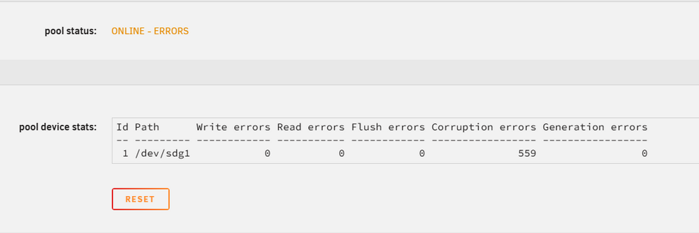

Just updated from 7.2.6 and get this nasty one:
Corruption errors was instant i did not see it accumulate, and the number hasnt gone up...

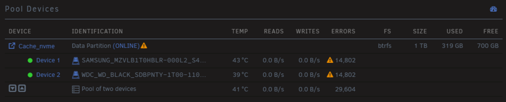

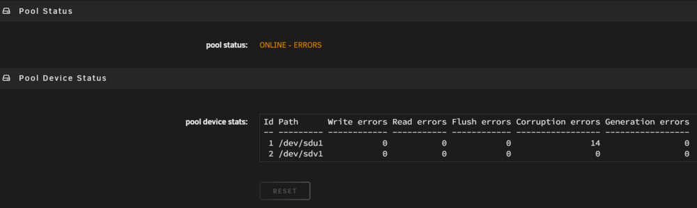

1 hour ago, craigr said:
Went from 7.2.6 to 7.3.0. Everything is working as expected except this. I see no errors when I click on the pool and it is operating fine. What does this mean? I'm running a scrub to see if that shows any errors.
It is a RAID0 pool BTRFS
Click on the online it will take you to the info page.
You will see some errors displayed. There is a reset button, but they may reappear.
Also if you hoover of the warning triangle next to the number is will show more detail on the errors.

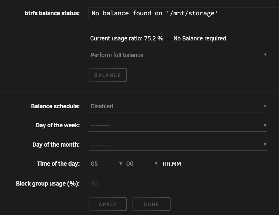

Not very informative. What are corruption errors? As you can see, "RESET" is greyed out.
Balance is now not available in the pulldown and also greyed out. And finally SCRUB is greyed out.

If I click the disc and not "ONLINE" than nothing is greyed out including reset. But what are corruption errors? And were the errors there before the upgrade, or were they caused by the upgrade? The SCRUB returned no errors.

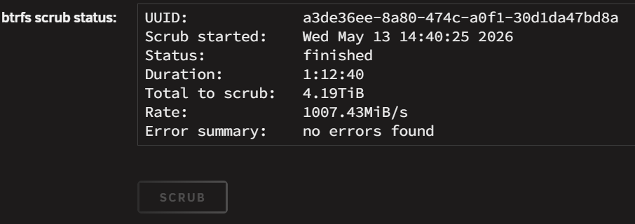

These are errors reported by the btrfs filesystem, and they come from before, just that they weren't monitored, though I'm not sure why the buttons are greyed out, they work for me, will take a look
Corruption errors mean that btrfs detected mismatched CRCs for some blocks on that device.
The first step is to reset the stats, if you cannot do it using the GUI, open a terminal window and type
btrfs dev stats -z /mnt/pool_name
Then run a scrub and see if more errors come up
btrfs scrub start -B /mnt/pool_name

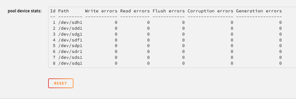

I had a bunch of corruption errors on 2 pool drives (see earlier post). Reset button was clickable im pretty sure, but i got scared and downgraded to 7.2.6 instead
7.2 will have the same pool errors; it just won't warn you about them.
