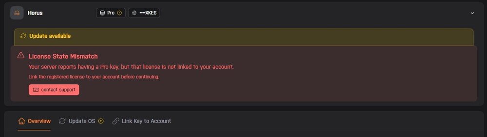

16 hours ago, Zonediver said:
Can someone explain, what this means?
I had the same issue when I updated to 7.2.4. I scrolled down a bit and saw a button the said "link license to account". I clicked it and got a message that said it was successful.
I have no idea what it does or why you need to do it but the error message was gone. I don't have the Unraid connect plugin installed.

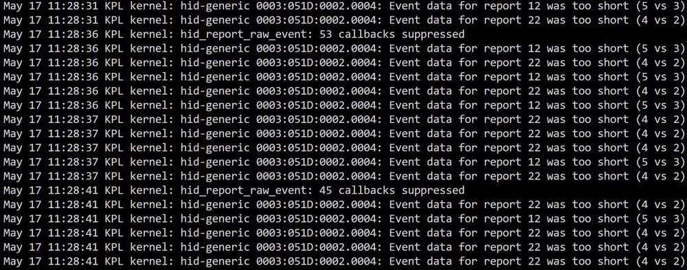

I think UPS support may be flawed in 7.3.0
I have APC one via USB - an older Unraid worked OK.
Now I have a situation as depicted on the attached picture.
I personally went to server room and unplugged the UPS and it is working, Unraid had an event about UPS.
Please see the release notes, there's an apparent kernel regression with the APC UPS service affecting some models, you can use the NUT plugin instead for now, that should still work fine and has very similar functionality.

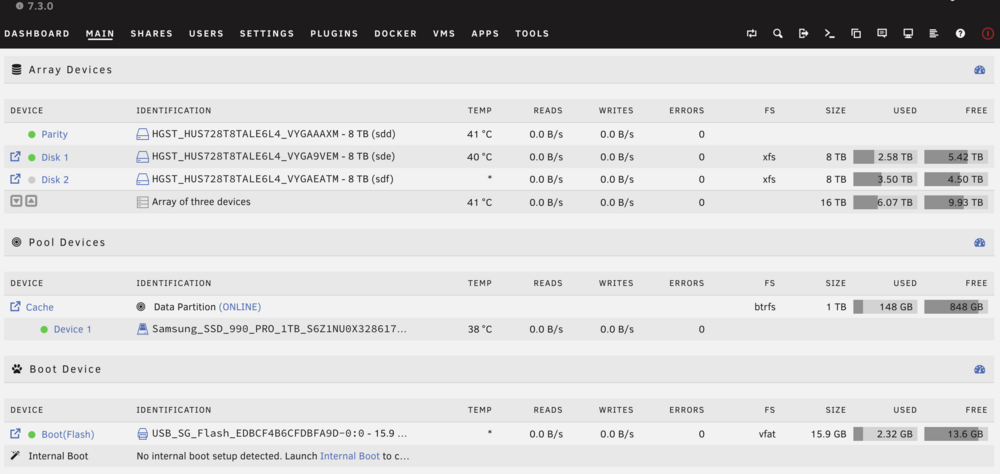

I just upgraded to Unraid 7.3.0. Can I use the cache drive as a boot drive without affecting the existing cache? Is there a way to partition directly on Unraid? Thanks
You first have to copy the data off the cache elsewhere as setting it as a boot drive is destructive to any existing data. After doing that you can set it up as a boot+data drive. You then need to copy the data back to the cache drive to get back to your existing running state but using internal boot.
