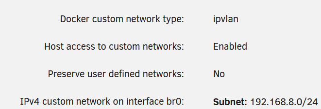

Yes, this problem is also happening when going from 7.1.2 to 7.1.4, in my case. I'm also listing all those 3 versions for people that will also eventually end up destroying their custom networks by deleting network.cfg or docker.cfg in their USB/Flash folder like I did see sometimes. I did : 7.1.2 > 7.1.3 : lost br0 revert back to 7.1.2 : restored br0 7.1.2 > 7.1.4_rc1 : lost br0 revert back to 7.1.2 : restored br0 7.1.2 > 7.1.4 stable release : lost br0 (lost my patience there) revert back to 7.1.2 : restored br0 7.1.2 > 7.1.4 stable release : lost br0 again and my mind with it, decided to fix it myself There should be a simple check to backup custom docker networks OR to allow creating them in the GUI..... Right now, I don't know of any other way than to do it via terminal

For a reason unknown, going from 7.1.2 to 7.1.3, back and forth, removed the "Custom : br0" network I had in docker, to attribute to containers a custom IP. Worse, when you go into Settings > Docker, you can see for example that br0 seems to be enabled... Long story short, that's because the br0 is "available", but is not "enabled". This might be because of static IP adresses and netmasks, that didn't pose a problem before and suddently, any netmask other than /24 for IPV4 and /64 for IPV6 is a problem.... I solved it by doing the following. Remove all custom networks from your dockers, set them to "none" Make sure to stop VMs, stop Docker. Have your Network Settings setup to "Enable Bridging = Yes" Bridging members of br0:eth0 if that is your interface Prefer a static ip address for IPV4 and ipV6 !! Make sure your static IPV6 address has a /64 netmask and your IPV4 a /24 netmask Go back to Settings > Docker > choose IPVLAN Enable IPV4 custom network and IPV6 if needed Start/enable the docker service Make a first assesment in your docker templates to see if the custom networks went back online automatically just by correcting netmasks. Please report this if it did for you. If the network didn't create itself : Enter the terminal This last docker command is valid for IPV6 and IPV4 as well Go back into your docker templates and select the new "Custom" network Remember in the docker template to enter the "IPV4,IPV6" addresses separated by a comma Example for my adguard (IPV6 hidden for privacy purposes, but I use the same last numbers as the IPV4 address to help) 192.168.8.252,xxxx:xxx:xxx:xxxx::252 You should be good to go. REMEMBER this is now a "custom network" that will NOT be preserved if you don't change that
